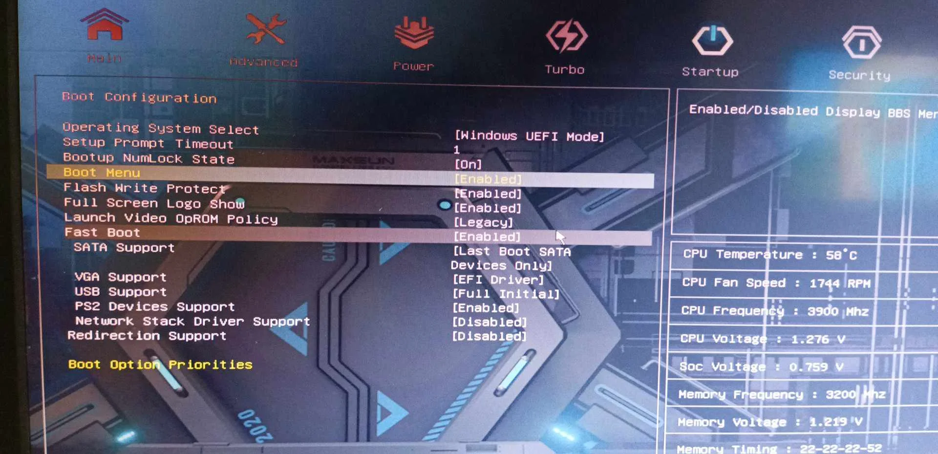

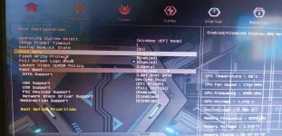

Mga sir baka may naka kaalam kung paano maayus ang pc
Laging na pupunta sa bios at Hindi na reread ang priority boots
salamat

check if the bios detected your hardrive or ssd.
nadedetect sir kaso hindi niya nababasa sa option priority boots option.Nagbubukas siya minsan kaso pag bunuksan ko ulit may lalabas ba black screen at may nakalagay na
"reboot and select proper boot device"
boss check mo cmos battery, tanggalin mo then balik mo uli
ginawa ko na sir at linis ng ram,
ganyan parin at minsan ay
black screen "reboot and select proper boot device"
reformat your drive for attempt fix or replace your storage.
possible corrupted boot device or failing hardrive/ssd.
sira
sira bcd niyan boss. need na reformat niyan, palit na drive.
bagong bili ang SSD mo diba? at sabi mo always black screen "reboot and select proper boot device" ang lumalabas?
this is a stupid question but ill ask anyway.
may OS ba ang SSD mo?
