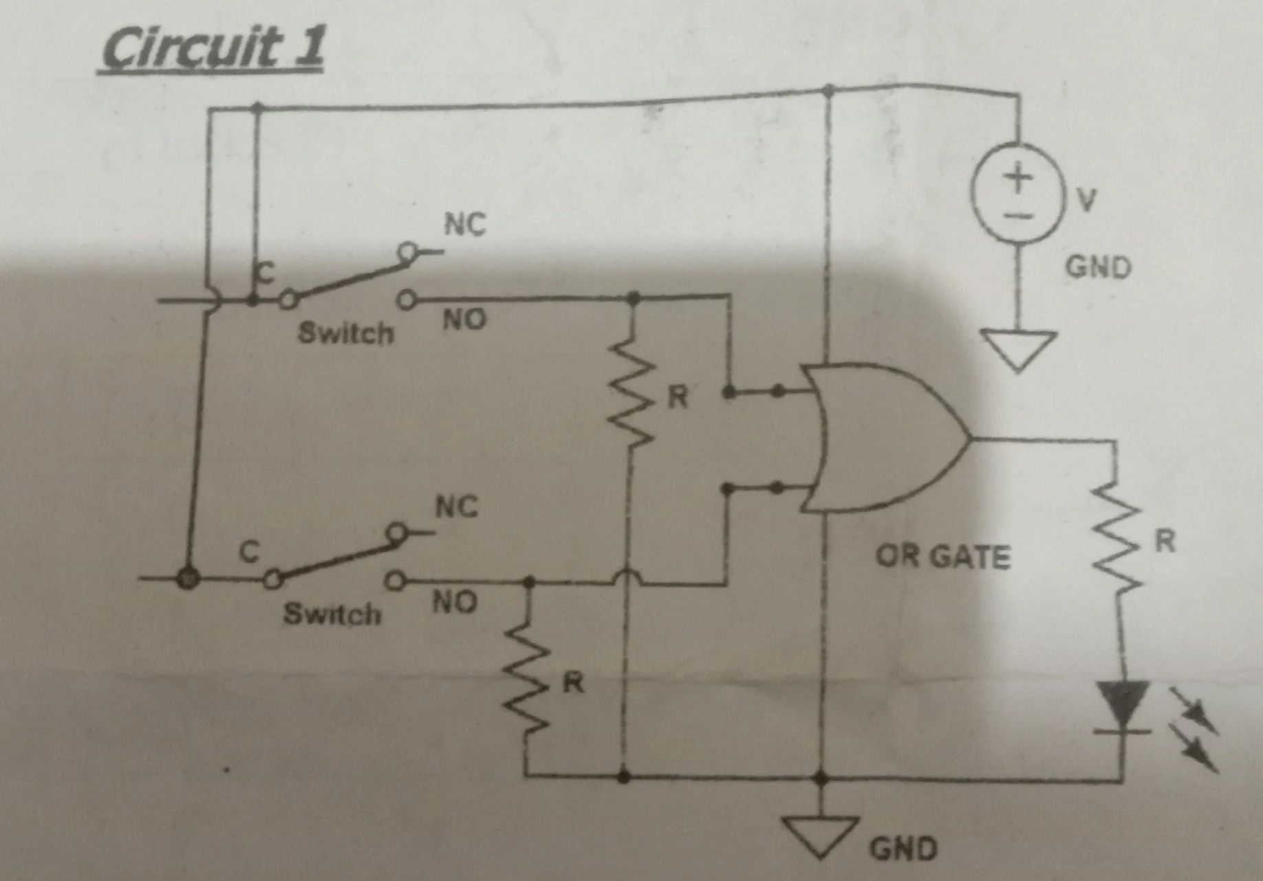

❓ Help LF marunong gumamit ng breadboard (schematic to circuits)

A breadboard is a useful tool for prototyping and testing electronic circuits. It allows you to connect various components together without the need for soldering. Here's a step-by-step guide on how to use a breadboard to build a circuit based on a schematic or diagram:
1. Understand the schematic: Start by studying the schematic or diagram of the circuit you want to build. Identify the components and their connections.
2. Gather the components: Collect all the necessary components mentioned in the schematic. This may include resistors, capacitors, diodes, transistors, ICs (integrated circuits), and wires.
3. Familiarize yourself with the breadboard: A typical breadboard consists of rows and columns of interconnected metal clips. The...
3. Familiarize yourself with the breadboard: A typical breadboard consists of rows and columns of interconnected metal clips. The rows are typically labeled from A to J, and the columns are labeled from 1 to 30 or more. The clips within each row are electrically connected, while the clips in different rows are isolated.
4. Insert components: Begin by placing the components on the breadboard. For most components, you'll need to align their leads with the rows on the breadboard. The longer lead of a polarized component (such as an LED or diode) is usually positive, while the shorter lead is negative.
5. Connect power and ground: Locate the power and ground connections on the breadboard. These are often marked with red (+) and blue (-) lines. Connect the positive terminal of your power supply (e.g., battery or DC power source) to the red line and the negative terminal to the blue line.
6. Start wiring: Begin connecting the components according to the schematic. Use jumper wires to make the required connections. Jumper wires are short pieces of insulated wire with pins at both ends that fit into the clips on the breadboard.
7. Follow the schematic: Refer to the schematic and carefully connect each component to its corresponding location on the breadboard. For example, if the schematic shows a resistor connected to two pins of an IC, insert the resistor's legs into the appropriate rows of the breadboard and connect the jumper wires accordingly.
8. Test and troubleshoot: Once you have completed the wiring, double-check all the connections against the schematic. Verify that there are no loose connections or short circuits. It's also a good practice to measure voltages or use a multimeter to ensure the circuit is functioning as expected.
Remember, it's essential to have a clear understanding of the schematic and the purpose of each component before attempting to build the circuit on a breadboard. Take your time, be patient, and don't hesitate to ask for help if needed.
