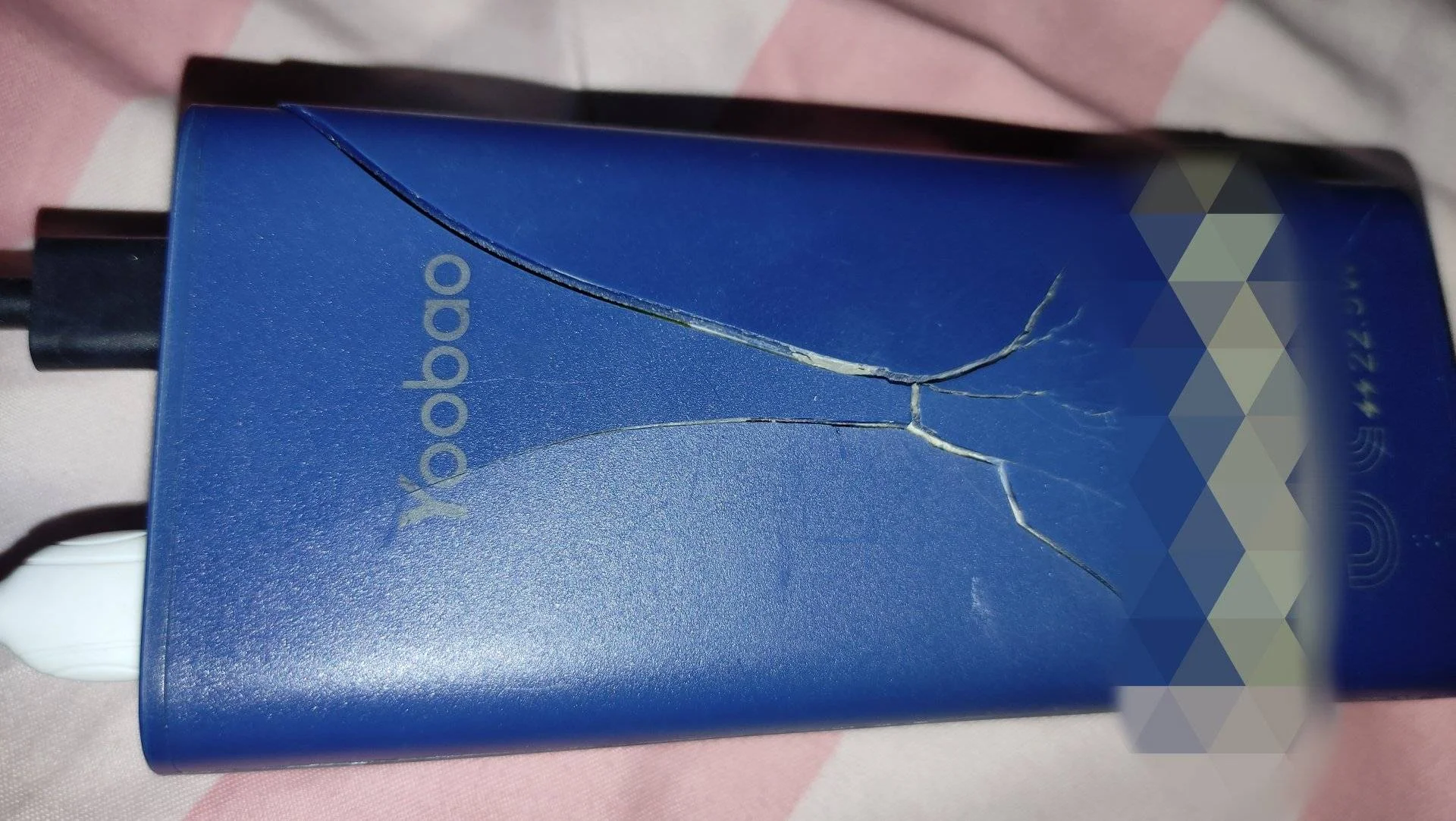

It is not recommended to continue using a power bank that is cracked and bloated. These are clear signs of a damaged and potentially dangerous device. The bloating usually occurs when the internal lithium-ion batteries expand due to a build-up of gas or a defect.
Using a bloated power bank poses various risks, including the potential for the batteries to leak or explode, leading to fire or injury. Even though it may still function for now, it is highly unpredictable and could fail at any moment.
For the safety of yourself and others, it is best to dispose of the bloated power bank properly. You can check with your local electronics recycling center for guidance on how to safely dispose of it. It is essential to handle such devices with caution and not to attempt any DIY fixes or repairs.

ganun po ba,try ko hanap ,sa akin 30k mah ,memorable din yan kasi nabili ko nung nung nagka typhoon odet dito sa Leyte ,tagal ko na din nagamit yan.Pero tama majority need na talaga buy new for safety na din.thanks.
Mahal ng 1600 haha. Naghahanap din kasi ako yung tig 1k below lang
oo medyo 😄 pero ok lang kasi worth it naman lalo pag nagtravel,hanap nalang talaga ako new.Takot ako baka bila mag explode
