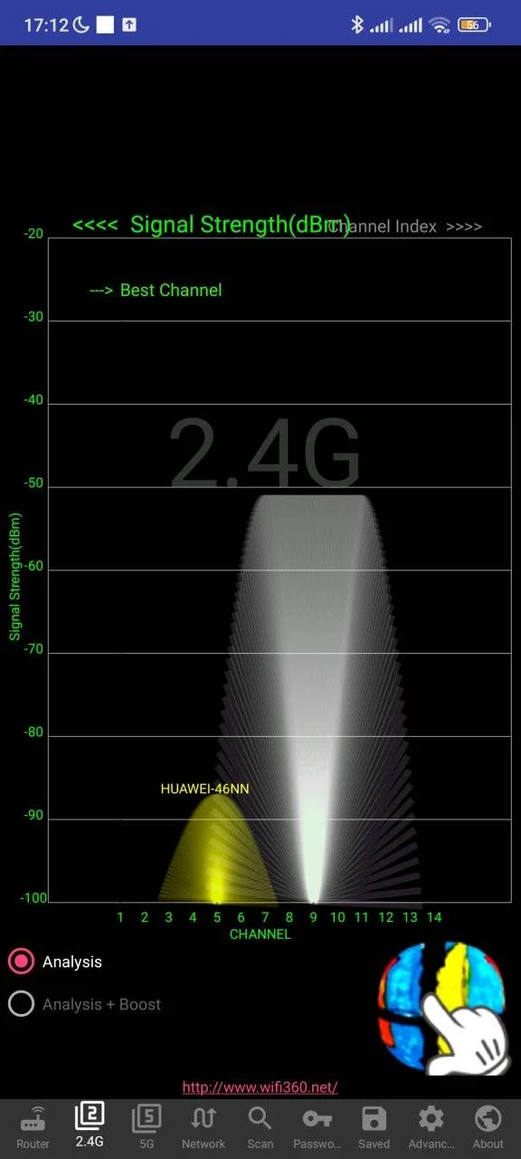

Sa 5GHz, huwag 80MHz, ang lawak ng sakop niyan so prone yan sa interference. Tapos kung may 160MHz pa yung router mo, huwag rin yan, sobrang lawak ng channel width na yan so hindi lang ikaw ang prone sa interference, pati din yung mga kapitbahay mo, makaka-interfere din yung WiFi mo sa kanila.
40MHz is the sweet spot between throughput and range.
Tama yung sa 2.4GHz mo. Always set your 2.4GHz to 20MHz. Low throughput pero less (maybe) interference. "Maybe", kasi overcrowded na masyado ang 2.4GHz so interference and overlapping channels are inevitable.
Sa ngayon, dapat ang pinaka-minimum standard na ay 5GHz. Ang pakinabang na lang ngayon ni 2.4GHz ay yung range niya. Sa throughput at sa interference, lagapak na si 2.4GHz.

Natest mo na poh ba ung app..?? Mas ok poh 80mhz and up coz it gives you higher data transfer rate lalo na kung mlapit ka lang sa router.. 2.4 is long range ballistic missile while 5 is short range ballistic missile which it has a higher frequency and higher frequencies have a harder time penetrating solid objects such as floors and walls in a building... Ung 2.4 abot hanggng 3 bahay ang layo while 5 is 1 bahay lng hirap ka na komonek or pawala-wala.. Ung trabaho poh nitong app is to put u into uncrowded channel or less crowded.. Hindi mo kaylangan isipin kapitbahay mo if wala naman sila pakialam sau..

Yan ang ginagamit ko sa homelab ko....kaya alam ko epekto niyan. Higher width doesn't necessarily mean better connection lalo na kung overcrowded na ang WiFi signal sa area niyo. Alam kong wala tayong pakialam sa kapitbahay pero if you look also your own good, mas magandang may balance, huwag isagad sa 80 or 160MHz. Like I said (base na rin sa researches), 40MHz is the sweet spot for 5GHz in terms of throughput and range. The higher the width, mas malawak ang frequencies/channels na mag-ooverlap diyan so the more na magkakaroon ka ng interference.
This is my POV as a networking professional. Baka iba POV mo. Baka sayo eh the higher the better. Baka nga naka-full power pa lahat ng AP or wireless transmitters mo eh. That's really not the case if you'll look at all the factors.
Tsaka case to case basis din ito. Mula nang nagka-pandemic, kung hindi dumoble, trumiple ang WiFi signals sa isang area. Kaya kahit gamitin mo pa yang app na yan. The fact that [maybe] overcrowded na ang WiFi signals sa isang area, it may not be good for you na isagad ang channel width ng WiFi signal mo, dahil sa interference. Once malala na ang interference, magkaka-data loss ka na on your end.
Also, a 40MHz 5GHz (802.11ac) can still give you a 200Mbps or more throughput. Aanhin mo ang 80 or 160MHz kung ang subscription mo ay less than 100Mbps lang? Bukod sa hindi ideal, baka imbes na makatulong eh lalo pang mapasama ang connection mo dahil sa interference.
Ang scenario na alam kong pwede ang 80MHz or sagad 160MHz ay kapag file sharing via local network kasi yan ang nangangailangan ng higher throughput for faster transferring of files between devices in your local network.

Ok.. its yours hahaba pa kac ang topic at malayo na sa APP na binigay ko .. at the end of the day its our unit its ours to decide whether we use the full potential or not.. im using converge and dikit dikit bahay din.. bago ko pinost ung TUT i already TEST many times in this routers.. and its PROVEN..
