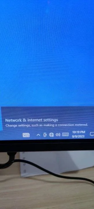

Bakit hindi maka sagap ng wifi ang pc ko? Nasa 2nd floor po kase yung router namin paano po maayos?
My PC mother board:MSI B450m Pro VDH MAX
Solution
Your mobo does NOT have a built-in Wi-Fi adapter.
Buy either a supported Wi-Fi card that you can put in your mobo or a cheap external USB Wi-Fi adapter/dongle.
