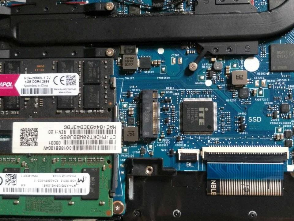

Mga master balak ko po sana mag-upgrade sa SSD...May slot po akong available tama po ba? saka kung bibili ko anong klase po kaya? di kasi ako masyadong pamilyar sa mga specs na pwede baka yung mabili ko di naman pwede sa laptop ko. salamat and more power!

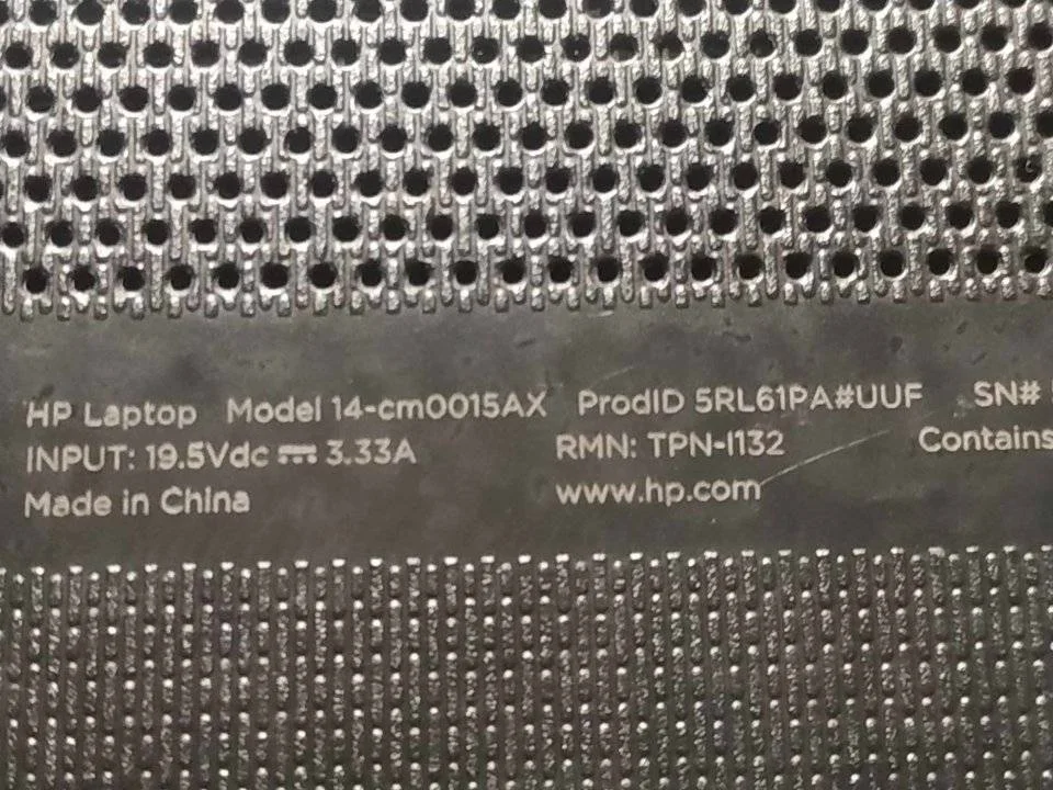

hp sir yung laptop ko

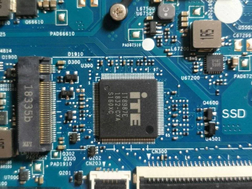

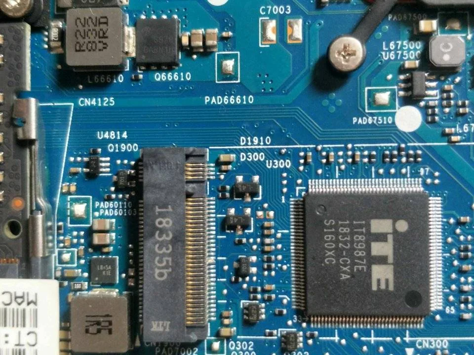

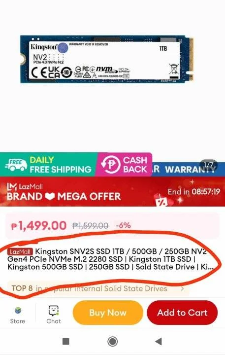

yan po sana balak kong bilhin...gusto ko nga makasiguro kasi baka nga di pwede sa specs ng laptop ko yung mabili ko...
puedeng puede iyan ang NVME M.2 SSD kung Ryzen yung CPU mo. kapag amd a9 hindi puede...
First check to make sure your notebook has a slot for a M.2 SSD.
Usually, notebooks with the AMD 'A' series processors such as yours, do not have a M.2 slot unless the notebook came with a SATA M.2 SSD from the factory.
If it does have a M.2 slot, the slot only supports SATA SSD's, not NVMe.
NVMe SSD's are only supported in the notebooks that come with the AMD Ryzen processors.
See chapter 5 of the service manual for the M.2 SSD removal and replacement procedure.
saken may same slot kaya binili ko yung adata sx8200 pro pero goods naman si nv1 ni kingston kaso dramless
kung may budget ka piliin mo yung may dram para stable yung performance kahit mag 80-90% yung storage like adata/samsung or other brands
