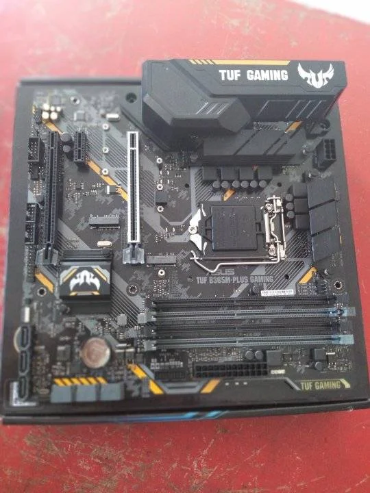

Sana may maka tulong asus tuf b365
Problema nya beeping 1 long beep 2 shorts beep...kahit bago na yung ram at proci nya ganun parin..3x na akung nag palit ng ram ganun parin...sana may maka tulong..
Salamat...po
lods na try ko na walang vc...ganon parin eh..may nakapag sabi sa akin baka ram controller chipsit daw...
mahal kasi lods wala na akung pambili
yes pede ram controller chip since asus same code beep din sya
and mukang yung chip nga pag ganyan unless meron kang spare replacement na yan
try mo i clear yung cmos nya baka na corrupt lang yung slots nya
you never know and better try everything before replacement
nag salamat lods...nag reheat lang aku sa northbridge chip...mukhang okay na..salamat
