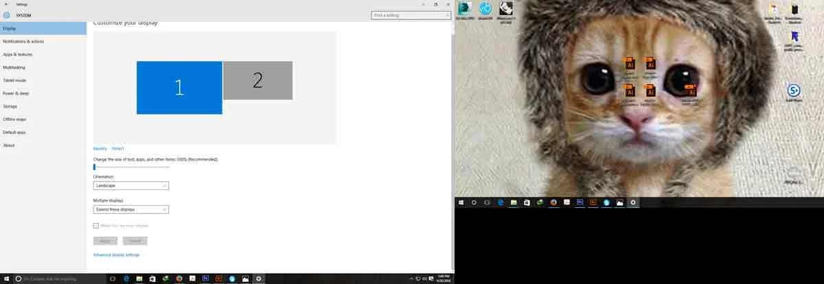

Sa windows 7, punta ka sa display meron option extend display, 2nd monitor should be plugged already at this point but 1st, video card must have two female plug such as dvi, agp or atleast for things to work. Proper video card driver to work.

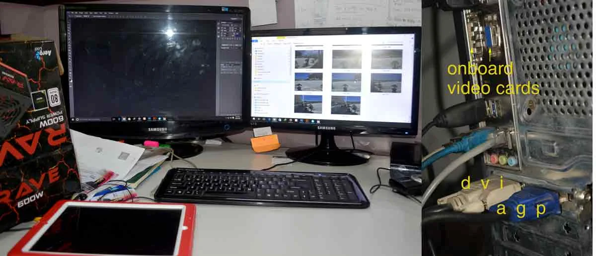

puwede din sa iisang vcard saksak mo muna sa vga port ng vcard then bili ka ng dvi adapter at saksak mo sa dvi ng vcard then dun mo saksak yun second monitor mo..downside need ng maganda processor or specs ng pc mo
diba po sinasabi nila na I need a SECOND video card para mag dual monitor po....upon checking iisa lang video card ko... nalilito na ako if pwede ba makabitan ang cpu ko huhu
Ako kasi isa lang video card ko tapos may built in ako. Naka plug ung second monitor ko sa mother board video card tapos ung main sa actual video card. Sometimes You will need to touch something in the bios but you can try searching for (video card manufacturer dual monitor settings)
meron motherboard na dalawa ung video out VGA and DVI pag ganito ung MOBO mo so pwedi na yan 2 monitors, pag isa lng ung video out vga lng or dvi lng... kailangan mo bumili ng Video Card taz dun muna ikabit lahat ung Vga and DVI or HDMI ba yan.. ung built-in sa MOBO dapat wala nang nakakabit dun para wala ka nang babaguhin sa bios setting.. sana makatulong :)
