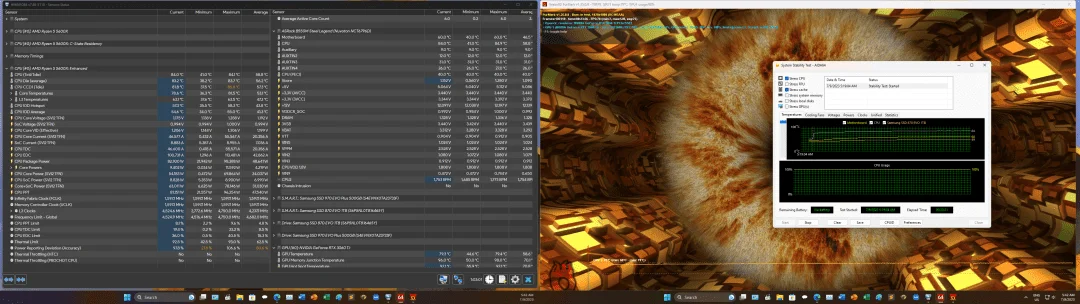

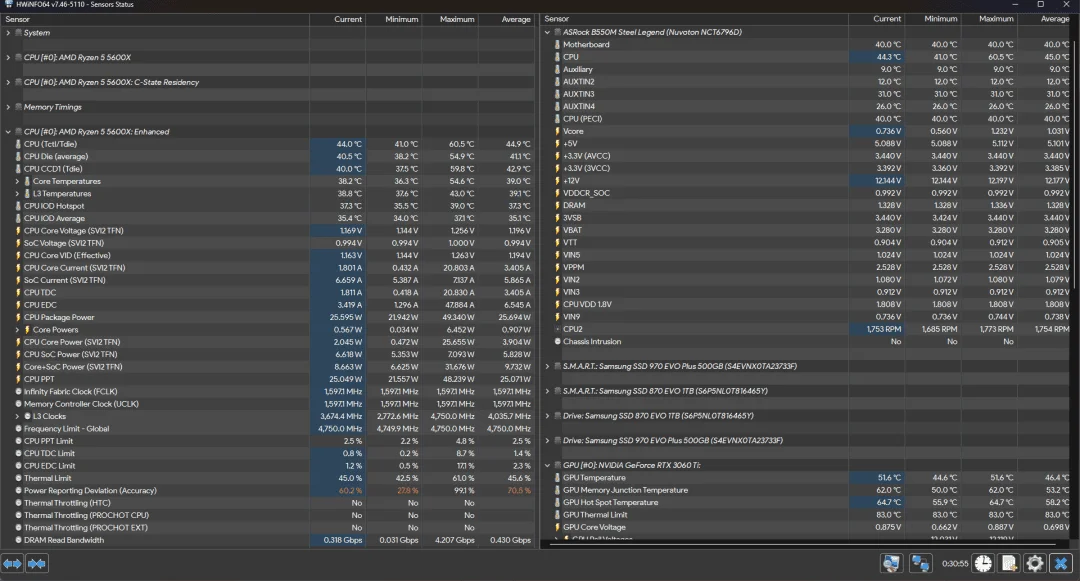

With only Microsoft Edge or Microsoft Office Apps Running:
with Test Benchmarks on for 20 minutes (Using AIDA64Extreme for CPU Stress Test and Furmark for GPU Test :
supposed to be sa ganitong setup ba makakapaglaro ako ng AAA Title ng magdamag?
If ever Im planning to change the case with better airflow but should I keep using this matx case kasi sa front niya wala kasing air flow kundi sa gilid lang.
Im using the fan with intake front and exhaust back and top is the Arctic Liquid Freezer II with PWM mode on bios with full speed.
Is My Temperature Good for long gaming on this case?
Using MX6 Thermal Paste and Arctic 240mm Liquid Freezer II on CPU
PC Specs:
ASRock B550M Motherboard
AMD Ryzen 5 5600x CPU
Asus Geforce RTX Tuf Gaming 3060ti OC GPU
DLM22 DarkFlash Pink Case
Silverstone Viva 650w Bronze PSU
32 GB Team Elite Vulcan TUF 16gb 4x8 3200mhz Ddr4 Gaming Alliance
3 DarkFlash DR12 Pro RGB Fan
(All Brand New)
Better kung imo-monitor yung temperature under heavy load. Pag medyo idle pang ganyang, di accurate yung baseline reading mo for intensive usage.
Naka-aircon ba yung room?
Otherwise, normal pa yan, considering nasa mainit na panahon pa din tayo.
nagunderclock/undervolt na ako, right now 50 degree celcius nalang cpu ko and max na 69 celcius sa gpu mas umokay pa performance, and nope di ako nakaircon haha
84 and 79 in stress is medyo ok pa pero di maganda airflow mo
yung gpu mo lang nakakakuha ng hagin sa setup mo ngayon
remember daloy ng mainit na hagin is pataas and yung daloy ng malamig na hagin is pababa
since wala kang front intake side intake lang
yung mainit na hagin ng gpu yung nakukuha ng cpu mo
kaya mas mataas yung temp ng cpu mo kysa sa gpu
makaka laro ka naman ng magdamag sa setup mo na yan maski ganyan temp nya
since yung 84 and 79 na temp mo in stress test
is hindi yan yung temp na makikita mo pag ng laro ka
bababa rin temp mo pag ng cap ka ng fps either from vsync or hard cap ng game
