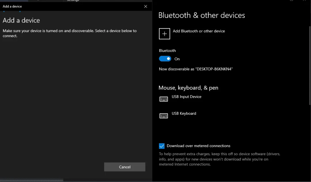

❓ Help Laptop Bluetooth Issue
Need inputs lang kung may gamot pa to.
Laptop Model : Aspire V15 V3-575G-52GY​
Nalinis na, na reformat na hindi parin maka detect ng Bluetooth devices(Drivers updated via Iobit Driver Booster).
Di ko rin mahanap sa board kung san naka konek(no board level knowledge), di ko sure kung same sila ng chip ng wifi at working naman wifi.
Marami na sya sakit pero di ko lang maintindihan at working pa naman bluetooth pero di na maka detec. Di rin sya ma detect ng phone.
Basic Troubleshooting? already done that every time mag te-test(wala eh umaasa paden eh). sama mo na yung install/reinstall drivers, different phone/speakers/other devices.

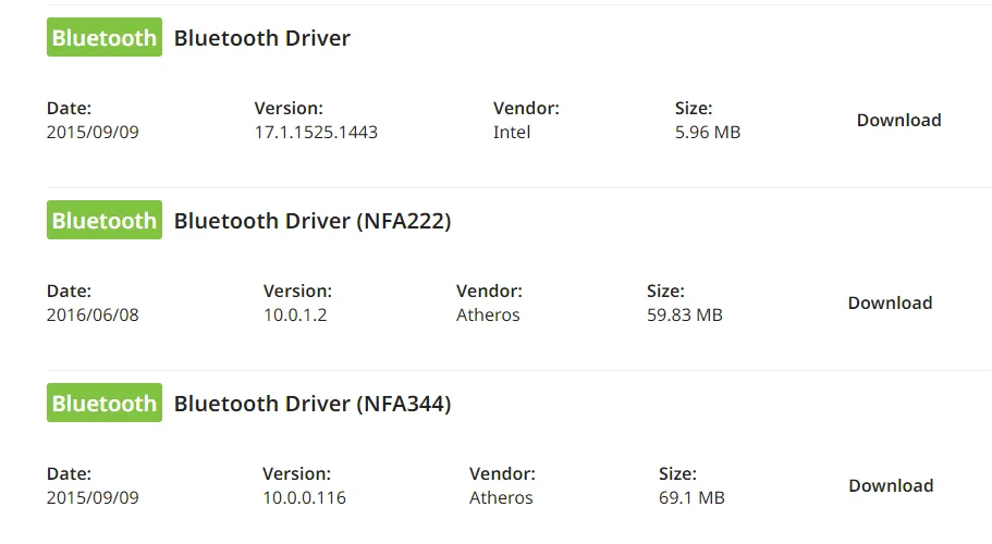

natry mo ba install yung mismong driver nyan galing sa acer?
kelangan mo tingnan kung alin dyan sa tatlo yung nakakabit sayo. sa pagkakatanda ko, magkasama yung wifi at bluetooth nyan, yung mini-pcie.

sige try ko din to muna pero 50/50 ako dyan(so far sa experience ko di naman mag ma-matter na driver from manufacturer. halos yung nag pa setup sakin either driver pack or iobit driver wala naman issue).
