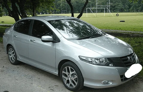

Boss Honda City po yan not Civic.
Anyways if maintenance is lalo na kung 5+ years na unit mo kahit mababa odo eh mas magandang ready ka sa byahe.
  • Filters ( Air, Oil, Fuel, Etc. )
  • Gulong kasama spare tire at brake pads
  • Fluids ( Engine oil, transmission fluid, brake fluid, coolant pati wiper fluid iflush mo na para mapalitan hehe )
  • Battery
  • Lights check mo kung meron ng pundi sabay mo na mga fuses baka may pundi narin at dapat may spare ka
  • Underchassis ( ball joints and tie rods, shock mount, shocks baka may tagas na, bushings baka palitin na, bearings baka kalawang na, ipaundercoating mo narin kapag may extra ka paps hehe)
  • Weatherproofing ( mahalaga ito lalo na kung naulan at pumapasok ang tubig sa loob.
  • Tools at early warning devices. Dimo alam kung kelan mo kakailanganin kaya lagi ka dapat ready
