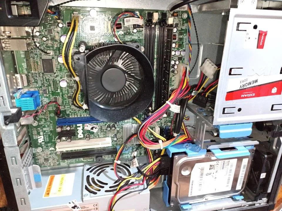

Can anyone help me para ma setup yung pc ko kasi i've been struggling figuring out kung anong problem, is it the cpu ba or yung mga cables? btw, i bought the setup sa online store lang pero seperate ko binili yung hdd and ram and also wala pa akong monitor so i'm only using our tv and a vga para maset up ko sana yung pc but i really don't know the problem kasi pag inoopen ko siya is lumalabas is yung parang linux something but i did the ctrl+alt+delete and then pressed the f12 para mapunta sa boot menu after that lumabas yung mga options and then i chose the UEFI BOOT; UEFI BOOT: INT13(USB,0×800), whenever i'm pressing that is nag oopen siya but pag iinstall ko na ang windows is sinasabi there na missing drive or no drive found tapos i made it skipped sa part na yan and then lumabas na yung install na button and then hinahanapan ako ng windows key, may naka input kasi na usb sa cpu and ang laman non is windows 10 tapos i have a code but lumabas dun is may problem daw sa device or hardware. i did anything na like uninstalling some updates pero yun nga ang sinasabi, they can't uninstall something kasi nga may problem daw sa device. i can't really find out kung saan prob. eh, sa cpu ba or sa cables kasi ang gamit ko is vga to vga eh or sa windows ba ang problem. can someone help me, btw i'll include the inside of my cpu kasi baka may mali ako na kabit sa mga cables. thank u!
check the bios for default setup legacy or uefi. then flash windows os based on that. usb must at least be 8gb+. be sure detected hdd in bios. I recommend not positioning hdd like that if possible place it horizontally.
before everything else. boot to bios check you ram/hardrive other devices/specs if matched. then fully format hdd to avoid issues (in windows boot for format). btw' place your ram in first slot (left side slot). if still issue redownload your .iso file.
