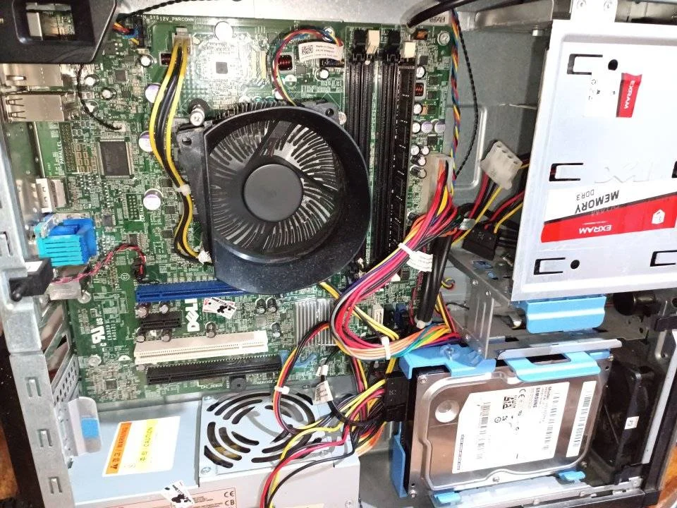

Can anyone help me para ma setup yung pc ko kasi i've been struggling figuring out kung anong problem, is it the cpu ba or yung mga cables? btw, i bought the setup sa online store lang pero seperate ko binili yung hdd and ram and also wala pa akong monitor so i'm only using our tv and a vga para maset up ko sana yung pc but i really don't know the problem kasi pag inoopen ko siya is lumalabas is yung parang linux something but i did the ctrl+alt+delete and then pressed the f12 para mapunta sa boot menu after that lumabas yung mga options and then i chose the UEFI BOOT; UEFI BOOT: INT13(USB,0×800), whenever i'm pressing that is nag oopen siya but pag iinstall ko na ang windows is sinasabi there na missing drive or no drive found tapos i made it skipped sa part na yan and then lumabas na yung install na button and then hinahanapan ako ng windows key, may naka input kasi na usb sa cpu and ang laman non is windows 10 tapos i have a code but lumabas dun is may problem daw sa device or hardware. i did anything na like uninstalling some updates pero yun nga ang sinasabi, they can't uninstall something kasi nga may problem daw sa device. i can't really find out kung saan prob. eh, sa cpu ba or sa cables kasi ang gamit ko is vga to vga eh or sa windows ba ang problem. can someone help me, btw i'll include the inside of my cpu kasi baka may mali ako na kabit sa mga cables. thank u!

Based on the information you've provided, it's difficult to determine what exactly is causing the issue. However, I'll do my best to give you some troubleshooting steps to try:
1. Check your cables - Make sure all your cables are plugged in properly and securely. Double-check that your hard drive and RAM are also properly seated in their slots.
2. Test your hard drive - It's possible that your hard drive is faulty. You can check this by running a diagnostic test on it. You can download diagnostic software from the hard drive manufacturer's website.
3. Try a different installation media - If you have access to another USB with Windows 10, try using that instead. Sometimes installation media can become corrupted.
4. Check your BIOS settings - Make sure your BIOS settings are set to UEFI mode and that your hard drive is set as the primary boot device.
5. Try a different monitor - If possible, try using a different monitor or TV to see if the issue is with your current display.
If none of these steps resolve the issue, it's possible that there may be a hardware problem with your CPU or motherboard. In that case, I would recommend contacting the online store you purchased the setup from and asking for their assistance in troubleshooting or returning the hardware.
I hope this helps! Let me know if you have any further questions.
