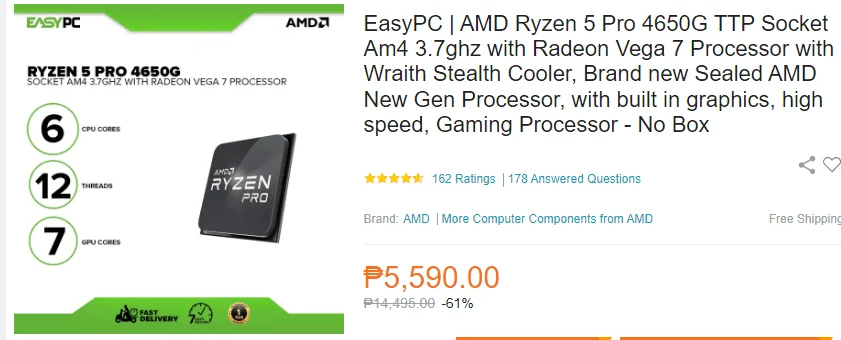

1. Cpu - AMD Ryzen 5 Pro 4650G - ₱5,590.00

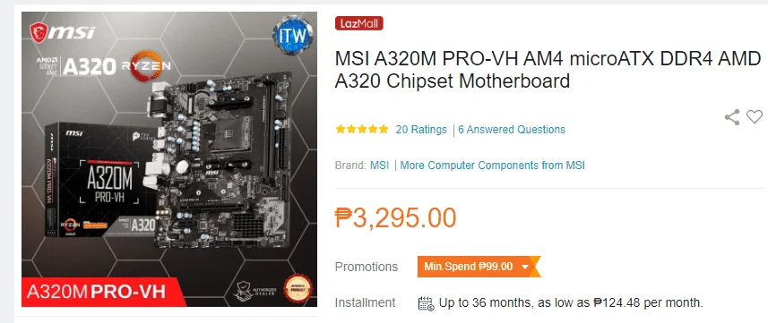

2. Mother Board - MSI A320M PRO-VH AM4 microATX DDR4 AMD A320 Chipset Motherboard - ₱3,295.00

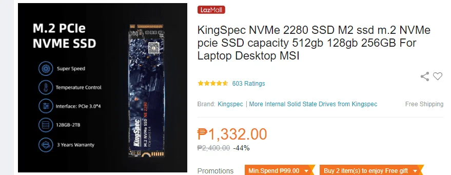

3. SSD - KingSpec NVMe 2280 SSD M2 ssd m.2 NVMe pcie SSD capacity 512gb - ₱1,332.00

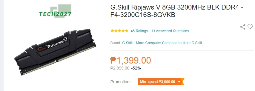

4. Ram - G.Skill Ripjaws V 8GB 3200MHz BLK DDR4 - F4-3200C16S-8GVKB - 1 Stick - ₱1,399.00

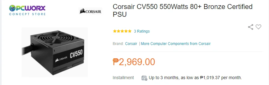

5. PSU - Corsair CV550 550Watts 80+ Bronze Certified PSU - ₱2,969.00

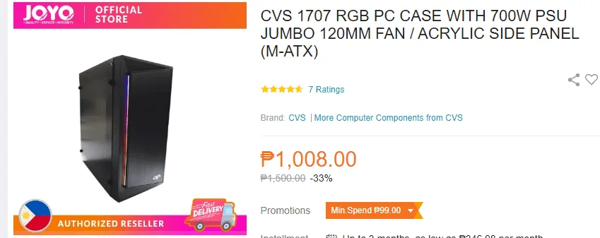

6. Case - CVS 1707 RGB PC CASE WITH 700W PSU JUMBO 120MM FAN / ACRYLIC SIDE PANEL (M-ATX) - ₱1,008.00

Hindi po ako sure sa mga yan but kaya ryzen 4650G is may Integrated GPU na pong kasama wala akong balak in the near future bumili ng gpu kaya mas pabor sana kung may Integrated GPU na kasama na po. Dun namn po sa mother board and ram d ko sure kung compatible ba sa cpu?? and last dun namn po sa psu baka sobra or kulang sa need na power input nung mga components kaya patulong po.

1. CPU - AMD Ryzen 5 Pro 4650G is a good choice for your budget and needs. It has an integrated GPU, which means you don't need to buy a separate graphics card.
2. Motherboard - You'll need an AM4 socket motherboard for the Ryzen 5 Pro 4650G. You can go for a basic B450 or A320 motherboard, but I recommend going for a B550 or X570 motherboard if you plan to upgrade in the future. Some good options are the MSI B450M PRO-VDH MAX, ASRock B550M Pro4, and Gigabyte B450 AORUS M.
3. RAM - Ryzen CPUs work best with fast memory, so I recommend getting at least 16GB of DDR4-3200MHz RAM. Some good options are G.Skill Ripjaws V, Corsair Vengeance LPX, and Crucial Ballistix.
4. Storage - You'll need a storage device for your OS and programs/games. A 240GB or 500GB SSD would be good enough for your needs. Some good options are Kingston A2000, WD Blue SN550, and Crucial MX500.
5. Power Supply - You'll need a power supply unit (PSU) to power your components. A 450W or 500W PSU would be enough for your build. Some good options are EVGA 500 W1, Corsair CX450, and Cooler Master MWE 500.
6. Case - You'll need a case to house your components. You can go for a budget case like the Tecware Forge M or Tecware Nexus M, or a more premium case like the Phanteks Eclipse P400A or Lian Li Lancool II Mesh.

pede ka makakita sa shopee or lazada ng mobo ng ryzen for 2.5kish

my ram sila na binebenta na 2.6k lang yung battle axe nila 8gb x2 kit na so 16gb
pede ka rin kumuha ng 1 8gb stick same store 1.3k din price (need mo 2x stick since apu ka)
sa official store din ng colorful makakuha ka ng PSU na Segotep 650w 2.3k lang tunay yung 80+ bronze nito good quality din sila actually mas maganda sila ng onti kysa sa CV line ng corsair
same store din my nvme sila for 1.7k if ng aalagan ka sa dinkilalang brand na kingspec

Slr po hehe ano po kayang magangdang motherboard
eto po yung pinagpipilian ko nasa 2.6k po yan pag may voucher applied saka iconsider ko po suggestion nyo mamats po Cpu palang kase naorder koo
Hello po salamat npo boss suggestion nyo pero naorder ko na kasi yung CPU hehe saka mas trip ko po talaga magbuild salamt poo❤️
motherboard is motherboard
same chipset yan sila na A320 so walang pinag kaiba yang dalawang yan
even if sabihin natin 9000 pesos yung isa basta A320 chipset wala yang pinagkaiba
heck sa bios UI lang yan sila mag kakaiba na hindi mo naman gagawalin after mo ma setup lahat
kung anong mobo yung my saksakan na kylagan mo yun kunin mo
my NVME slot ba
ilan fan header meron yung mobo kase if 1 lang tapos 6 fans iilalagay mo then mag splitter ka
my ARGB header ba kase mamaya gusto mo my ARGB if wala bibili ka ng fan hub
if pasado yung mobo sa slots na need mo and fit sa budget dun ka
meron ngang mas maganda dyan na mobo na 2.6k Soyo SY-KL A520M
mas maganda sa dalawang yan since A520 chipset mura pa tested narin di ko lang gusto i suggest kase makalat yung bios UI nya pang advance user
my NVME slot ba
So pwede ko pong piliin maalin sa dalawang yan compatible po sila pareho sa ryzen 5 4650g na cpu po?

eh case is more subjective eh kaya wala ako recommended dyan
pili ka ng modern case na mura and maganda sa mata
case lang naman yan pede mo nga patakbuhin pc sa karton ng motherboard if trip mo
for case fan di mo naman need ilagay lahat yung fan na kaya ng case
lets say 7 fans yung kaya ng case di ibig sabihin nun 7 fans fix kylagan mo
infact mga 3 fans (excluding cpu fans) nga lang need sa no gpu system
2 front intake 1 rear exhaust the rest is porma mag dadagdag ka lang if high powered na yung parts mo or my gpu kanna na need ng either 6pin or 8pin
dito sa pinas mas advice ko nga na instead of more fans mg eh less fans or mg invest ka sa air purifier
why air purifier kase maalikabok hagin satin unlike state side kaya maski 8+ yang fans mo pag kulob naman ng alikabok yung parts mo ala din kwenta sandamakmak mong fans
raidmax eh ok lang borderline generic na sila pero better than 100% generic
mas kukunin ko segotep dyan na 2.3k 80+ rated or corsair or silverstone essential na 2.3kish for 500w na 80+ white
tipirin mo na lahat wag lang psu kung hindi mo gusto madurog lahat ng parts mo sa isang random na brownout
if generic talaga habol mo then pumili ka ng high watts either 650w or 700w
yang raidmax para sa system mong low draw eh ayos na yan tatakbo pero the moment mag lagay ka ng gpu dyan instant palit na agad yan no question
