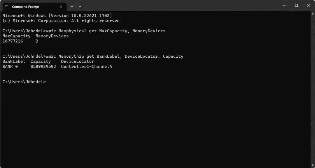

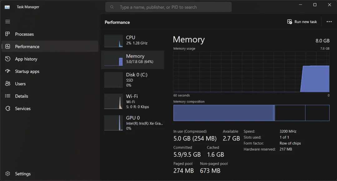

N nevertheless Established May 10, 2023 #1 pwede ko ba dagdagan ng RAM itong laptop ko, pagtinitingnan ko kasi sa Task Manager, isang slot lang meron Pero sa command prompt, dalawa siya may maximum pang 16gb

A arsenal1205 Rarely opens PHC May 10, 2023 #2 ang ibig sabihin lang iyan is may built in ram ka naka lagay sa motherboard mo puedeng malaman din kung anong laptop mo? Upvote 0 Downvote
A Arjienx 1st Seat Contributor May 10, 2023 #3 check physically sa board. if meron physical slot pwede ka mag upgrade to higher memory ram. mostly sa mga standard na laptop 2 ram slot. Upvote 0 Downvote Solution
TS TS N nevertheless Established May 10, 2023 #4 arsenal1205 said: ang ibig sabihin lang iyan is may built in ram ka naka lagay sa motherboard mo puedeng malaman din kung anong laptop mo? Click to expand... Lenovo Ideapad Slim 3 - Type 82H7 Upvote 0 Downvote
M Martin Mystery Eternal Poster May 10, 2023 #5 Maganda nga check mo physically boss yung sa akin kasi sa task manager nakalagay 4 slot pero pag binuksan 2 slot lang pala haha Upvote 0 Downvote
