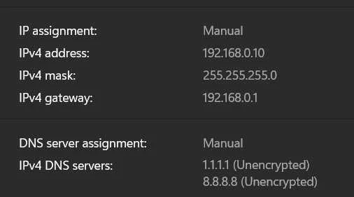

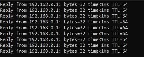

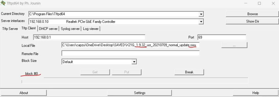

As an owner of the Unicom CPE VN007+ and a subscriber to the Rocket 5G 699 plan, I have encountered a frustrating issue where my device becomes completely useless once my plan is depleted, despite attempts to change the IMEI. However, after updating the firmware from version 1.9.32 to 1.13.5, the device worked perfectly for two months until it suddenly stopped functioning one day before I could recharge my plan. Despite trying various methods such as pressing the reset button for extended periods of time and manually setting up my DHCP, I have been unable to resolve the issue. I even attempted to use the TFTPD64 program to "PUT" the firmware, but encountered a blockage at block#0. As a newcomer to this field, I am reaching out to the community for any assistance or ideas on how to rectify this situation.

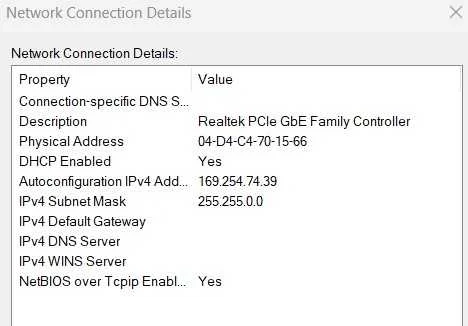

recently I not even have access to the GUI <192.168.0.1> Only the light of ON and Wi-Fi I can't connect to Wi-Fi or Ethernet If I no configure the DHCP manually because the router keep giving me a invalid IP <169.254.74.39> but even if I change to original IP I no have access to the Default GUI <192.168.0.1>, I try several times to reset but the router not responded but if I press fast 10 times just restart the router but keep all the settings, sorry but is all I know about this
