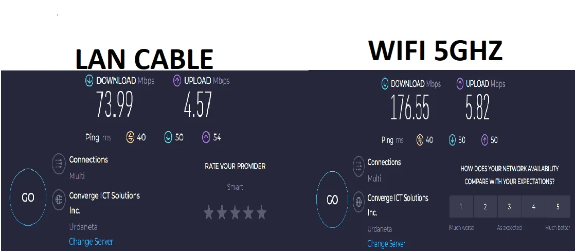

Mga ka-Phc may tanong po ako. Pag naka connect sa 5Ghz ng Fx-ID5L ay umaabot ng 180-200 mbps pero pag lan cable naman ay 60-80mbps lang kahit cat6 ot cat8 yung lan cable. Sinubukan ko naman ibang modem umaabot naman ng 180 mbps speed kahit naka cable. Pano po to ayusin? Sa settings po ba to or talagang hardware na problema?LAN.webp

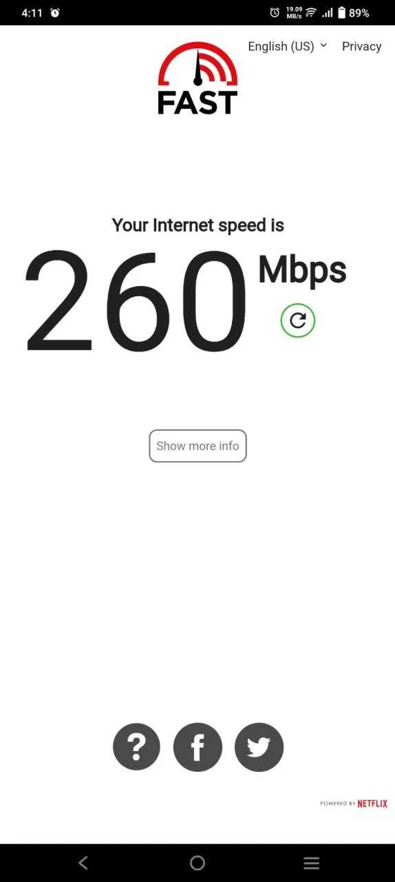

That's the hardware limit of the ID5/L. The RJ45 ports are only Fast Ethernet 100Mbps. They aren't Gigabit Ethernet 1Gbps. To take advantage of LTE Cat.6, connect to the 5GHz wi-fi of the unit.

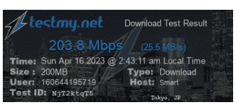

BTW, from where is the speedtest taken? Can you retake the same test in fast.com or testmy.net and get the same result?
