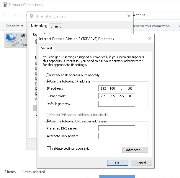

1. Set an ip address sa both computer, I used 192.168.1.100 and 192.168.1.101 (kailangan parehas yung unang tatlong digit, para sa mga non-techy)

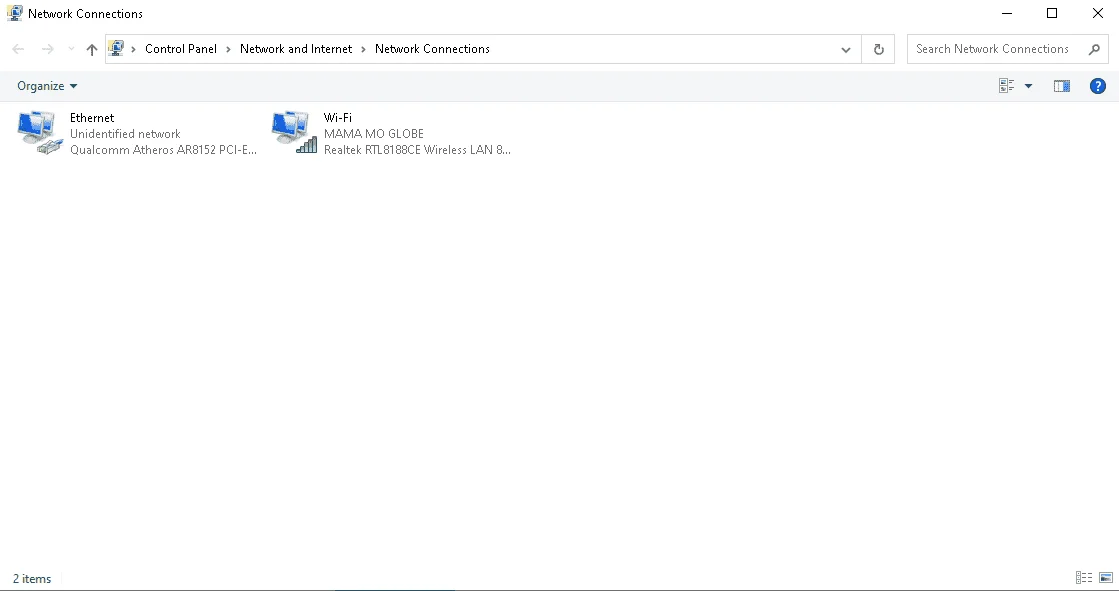

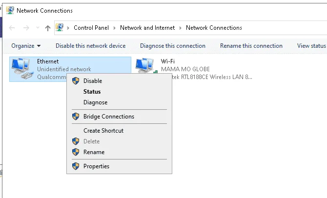

use windows logo + r and type ncpa.cpl sa lalabas na run console
then hit OK or Enter . Lalabas yung network adapter settings kung saan nyo ise-set yung IP address.

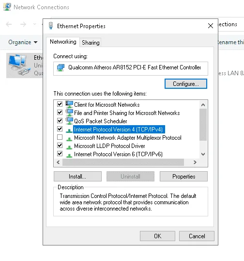

palaging piliin yung Ethernet Network then right-click nyo yun then PROPERTIES
then hanaping yung Internet Protocol Version 4 o IPV4
click yung USE THE FOLLOWING THE IP ADDRESS then itype yung ip address, ganyan
subnet mask: 255.255.255.0 (default yan pag nagenter) . ganyan lang din gagawin sa kabilang computer.

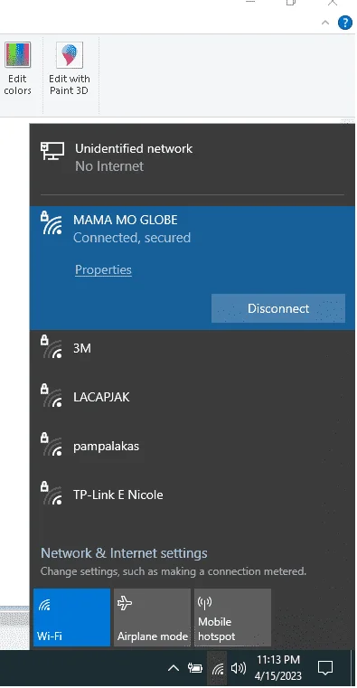

Gawing visible ang network sa magkabilang/parehong computer para magkakitaan sila. HAHAHA.

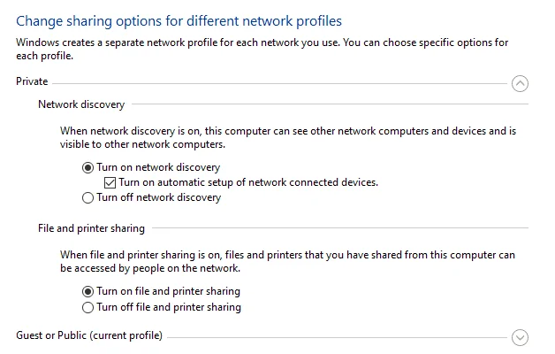

Open network settings. lagi syang nasa kanang baba ng desktop malapit sa date and time then piliin/click lang ulit yung ethernet connection lagi syang unindentified network sa iba haha. (Hindi naman wifi connection kaya hindi yung MAMA MO GLOBE).

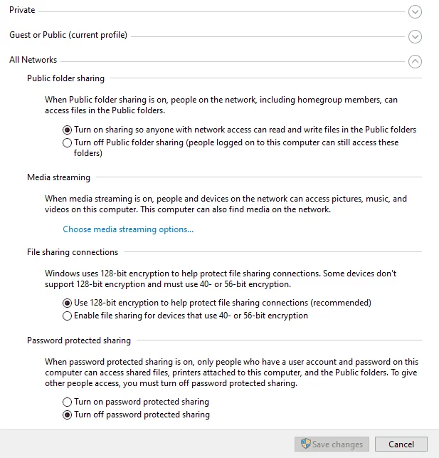

CLICK YUNG CHANGE ADVANCED SHARING OPTIONS
under ng
PRIVATE, Guest or Public at All Networks
dapat:
Turn on network discovery
Turn on file sharing and printer
Turn on sharing so anyone in network can access read and write files.
use 128bit encryption
TURN OFF PASSWORD protected sharing
see samples below. SAVE ALL CHANGES after mabago.

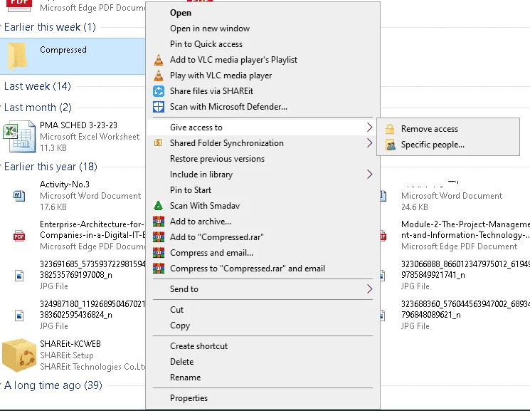

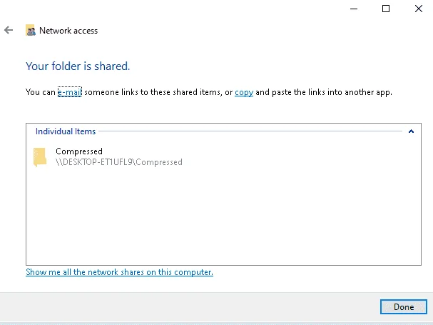

I-SHARE ANG FILE NA KOKOPYAHIN SA COMPUTER NA KUKUHAAN. SA COMPUTER NA KUKUHANAN ITO GAGAWIN.

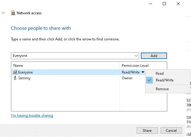

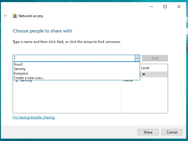

I-locate yung folder kung saan nakalagay ang kukunin file, i-right click at piliin ang GIVE ACCESS sa SPECIFIC PEOPLE.
piliin ang EVERYONE at i-add
bigyan ng ACCESS , KAILANGAN NAKA READ/WRITE then hit SHARE.
magloloading sya at hit DONE.

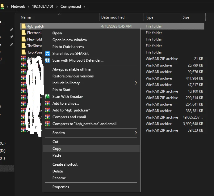

STEP 4: locate and copy.
SA PC ITO NA MANGONGOPYA OR KUKUHA NG FILES.
windows logo + R ulit (run command) at i-type ang IP Address ng kukuhanang files: (SAMPLE) \\192.168.1.101
1681570876702-png.2616247
hit enter or OK.
so dahil nasa compressed yung ika-copy ko, dyan ko bubuksan at kukunin.

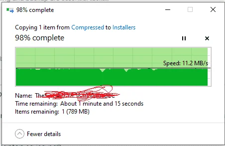

hit COPY at ipaste sa computer nyo.
COPYING SPEED :

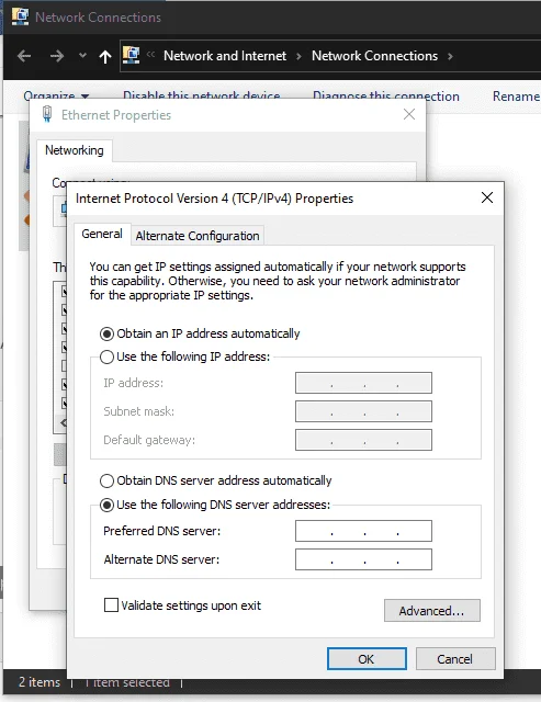

TANGGALIN ANG IP ADDRESS NG INYONG SINET PARA BUMALIK SA DATI ANG DEFAULT SETTINGS , KAPAG HINDI NAIBALIK, HINDI NA MAGAGAMIT ANG LAN CABLE CONNECTION PARA SA INTERNET. (ULITIN LANG ANG STEP 1 AT PILIIN ANG OBTAIN IP ADDRESS AUTOMATICALLY AND HIT OK)
