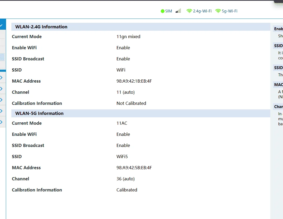

🔒 Closed Pano mag calibrate ng wifi?
Solution
It may not only be that the wifi is not calibrated, but the radio does run hot under the stock firmware that could be causing the wifi woes of some for this unit. I have converted S12Pro to a working OpenWrt build and I did not experience the same wifi instability as that of stock. Also the radio runs cooler as a result.

wow galing naman openwrt, na try mo na ba mag serial connection sa modem na to lods? Nakaka pag sent kaba ng command using serial?
Under OpenWrt yes. I'm not sure about stock, it must have been read-only.

It can be recovered from a brick so long as the bootloader remains undamaged. The conversion of this device into OpenWrt only happens on the router side. There is another device inside the unit, the LTE module connected to a mini pci-e slot that handles the mobile network communications and this remains untouched. This is reponsible for the signal, bands etc.
In my experience I get better mobile network performance under OpenWrt than stock.
