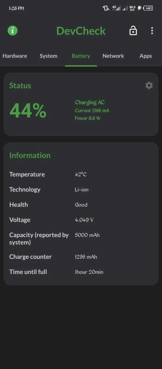

Gusto ko lang malaman ba't di magchacharge yung phone ko at full capacity. Yung phone is 33watts charging supported(Infinix Zero 5G 2023), nung chineck ko, nasa 8watts lang yung narereceive niya gamit yung original charger. Nasa charger ba yung problema kasi parang di ko feel yung 33w, parang same lang ng brother ko na 18w phone Niya yung gaano katagal magcharge. Screenshot_20230323-132641.webp

Bagong bili palang yung phone sir, chineck ko sa YouTube yung may 33w din na phone, nasa 5900+ yung mA current ang makukuha nila using also a 33 watts charger. I dunno bat 2k mA lang yung makukuha nito. Parang 18w lang ata tong phone.
Ang taas na yung batt temperature niya oh. Di kaya nililimit ang charge niya dahil dyan for the safety reason.
Its better na hayaan muna gumamit ng phone habang naka-charge para mabawasan ang init. Baka makatulong, otherwise.
nalilimit ang current ng charging mo dahil sa sobrang init, the more mainit yung device the more hihina yung charging. I suggest you to use 22watts brick charger tas yung original cable gamitin mo
