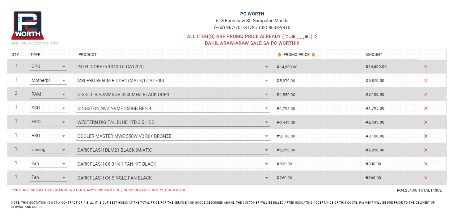

Nag canvass din pala ako sa physical store na malapit samin, pwede pakitingin paps yung pricing nila kung swak or hindi.
for freelancing yang system na nandyan is omega overkill sa CPU side
lopsided yung build maganda if yung freelance mo is alam mo na 100% CPU Bound
pero the moment na my trabaho ka na GPU bound anemic na anemic yang build na yan
intel yan di ryzen almost display adpater lang mga IGPU nyan
if ako yung bibili and budget is abot hangang 34k
kukunin ko yung unang build na 21k then yung natitirang 13k
eh pambibili ko ng + 8gb na ram +1TB na HDD and GPU
almost 100x mas malakas yung build na my GPU kysa sa wala mapa work man yan or play
PS Photoshop or video editing or video format converting is GPU side
pede mo gamitin IGPU pero karag karag yan
