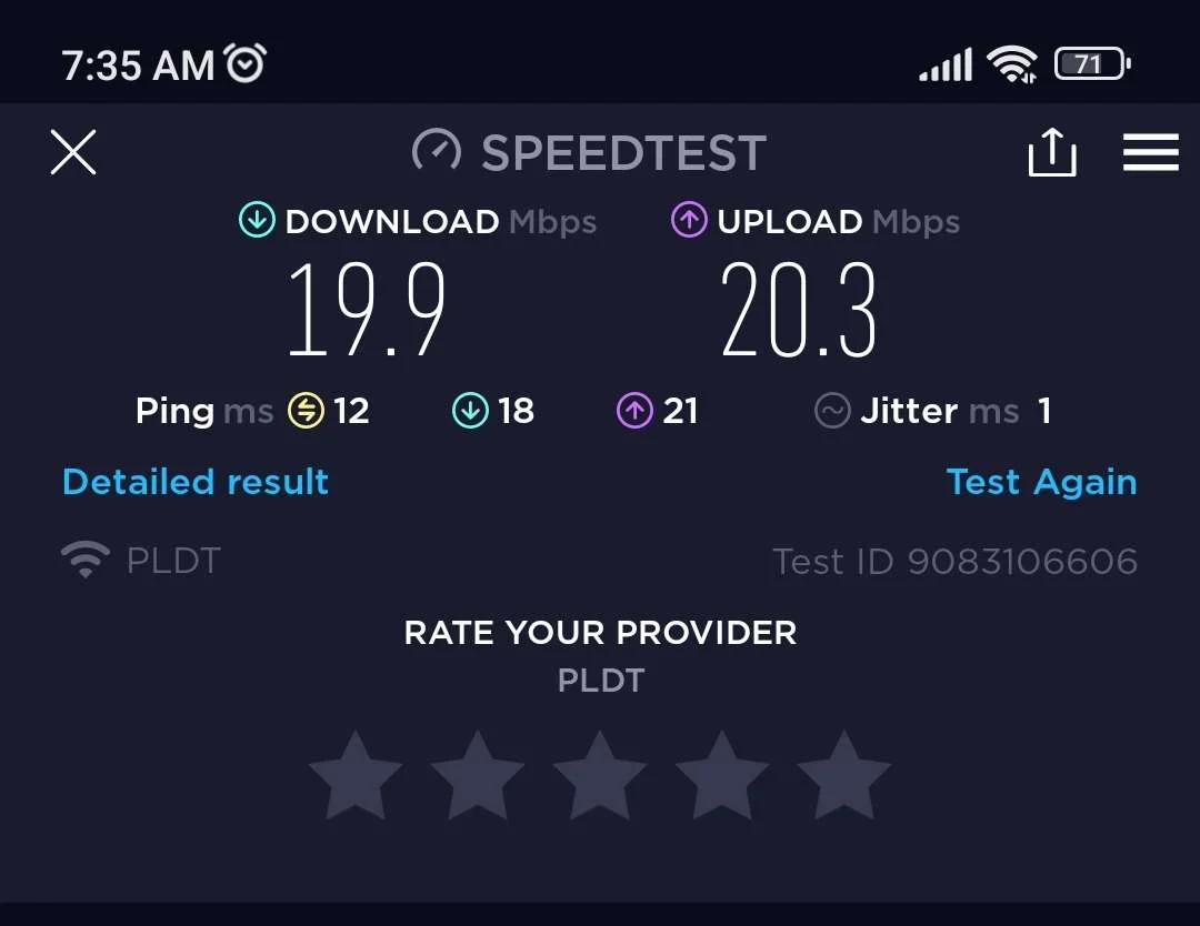

Eto po yung sample speed test ng pldt namin mga sir View attachment 2530328
Then eto po yung actual download speed nung nag download ng sample file
lagi pong 20mbps sa mga speedtest, pero yung download speed consistent 2.5mbps

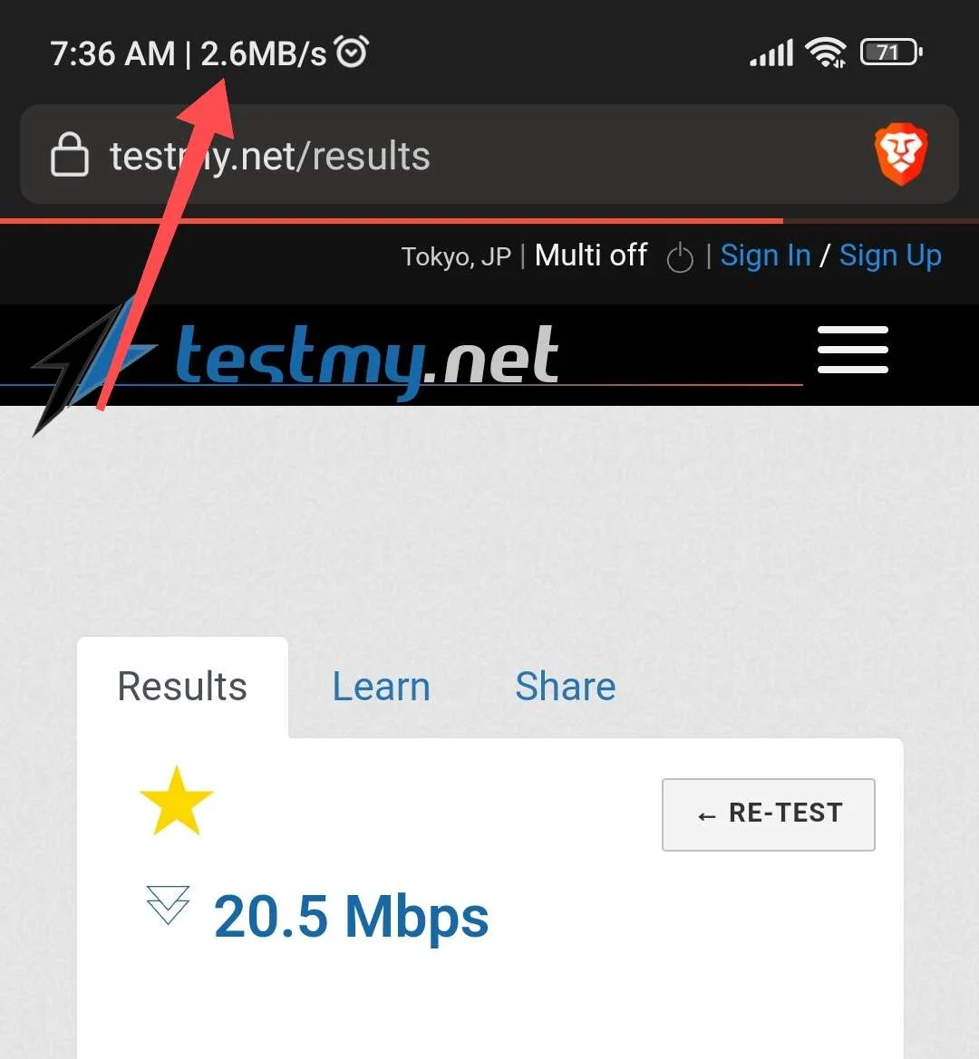

iba ang unit of measurement yung ginagamit ng speed meter ng phone mo iyan ay megabytes per second (Mb/s). Yung sa speedtest at sa testmy.net atbp, ang gamit naman ay megabits per second (Mbps).
try mo dito:
Difference...​

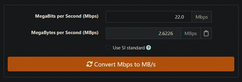

ah... that's megabytes per second (MB/s or MBps) yan ang scale of measurement na ginagamit pag nagda-download. Whereas ang scale na ginagamit ng mga ISP at mga speed test websites ay megabits per second (Mb/s or Mbps).
1 Megabyte = 8 Megabits
1 Megabit = 0.125 Megabyte
So, 2.6 Megabytes per second = 20.8 Megabits per second.
Calculate the conversion na lang or use any megabyte to megabit (and vice versa) converter that you can find in Google.
try mo dito:
Difference between Mbps and MB/s​
A MB per second (MB/s) is a non-standard unit for network throughput, often used due to its convenience since most file sizes one works with are in usually E×ρréššed in byte-units: KB, MB, GB, etc., and not bit-units like kbps and mbps. A MB can be defined in the binary and the decimal convention, as described above. On the other hand, a MegaBit per Second (mbps) is a standard bandwidth measurement metric for network equipment, such as routers, switches and LAN cards, and is equal to 1,000,000 bits per second, or 1,000 kilobits per second.
In practice, mbps is the unit in which your optic, broadband, LAN or DSL connection will be advertised in. You likely see prices internet connection speeds advertised as 25 mbps, 50 mbps, 75 mbps, or 32 mbps, 48 mbps, 64 mbps, etc. Business connections may go up to 300 mbps, and more. You most likely have a 100 mbit LAN card on your PC or MAC, therefore it has a maximum transfer rate of 100 mpbs. Currently the fastest available LAN cards go up to 160 gbps.
