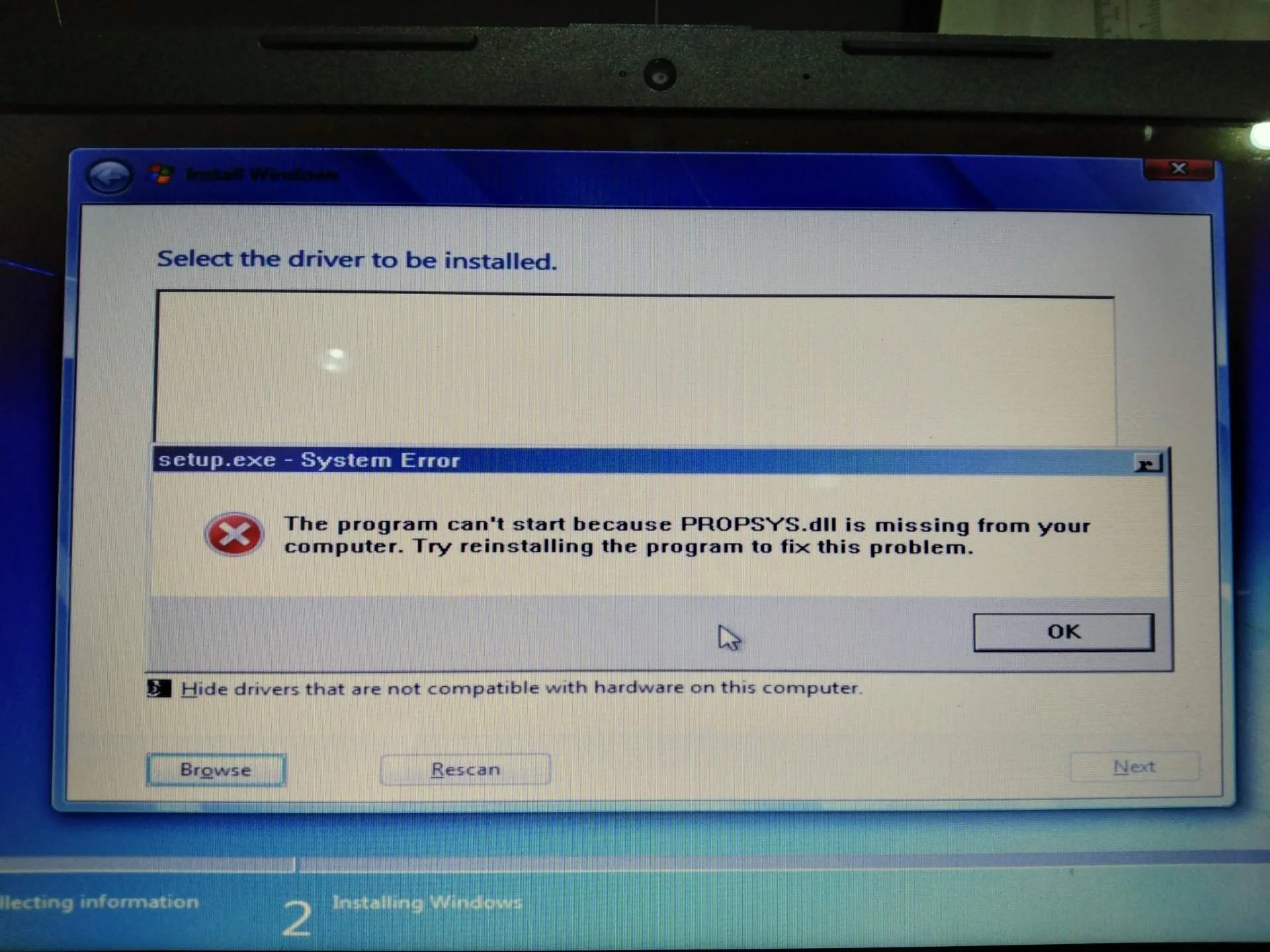

❓ Help Windows 7 installation. Na bwesit na ako huhu
it's not just the target disk boss, your BIOS and installer drive should also be MBR, silang tatlo dapat MBR and there is no point using 64-bit OS on a 2GB RAM

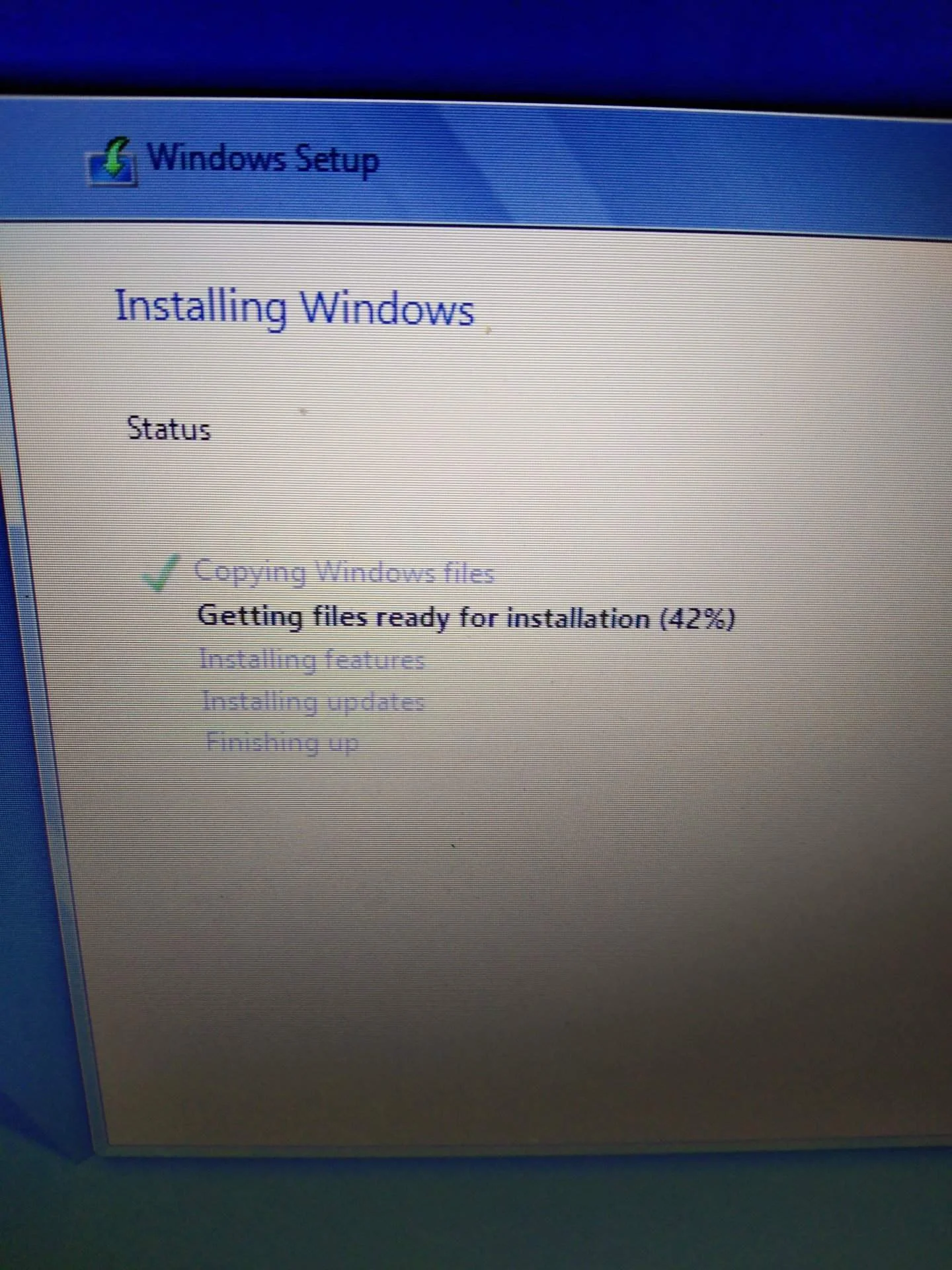

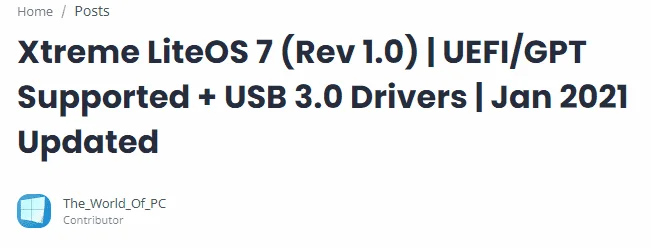

fix na pala lods, ung os na may kasama driver lang pala kailangan, thanks to 1675998481069.webp

Need mo pa lagyan drivers yang installation media mo
Iinject mo ung driver sa usb mo gamit ung gigabyte windows 7 intallation tool search mo nalang sa google after mo mag create ng bootable usb e iinject mo ung driver using that tool para ma install mo ung windows7
Walang kinalaman jan ung partition scheme
Pwede rin eto lods, ginawa ko ni replace ko lang ung bot.wim file , sa ibang OS ako kumuha na may drivers na.
