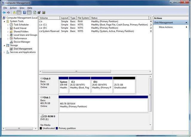

TS, Pwedeng pa-screenshot yung Disk Management? Kung Uninitialized siya, rght click mo yung disk tapos click mo yung Initialize.
Kung nade-detect siya ni Windows at mayroon siyang drive letter, subukan mong open si Command Prompt (Admin) at i-type mo chkdsk E: /f /r (palitan mo yung E: nung actual na drive letter niya) tapos press mo yung Enter button. Hintayin mong matapos yung process, magbibigay siya ng report sa huli. Try mo na kung accessible na yung mga files mo.

Tulad po ganito
TS, dati mo na bang ginagamit iyang hdd as storage, maraming files na naka-save diyan?
Sa Disk Management, paki-check kung pwede mo siyang lagyan ng drive letter: right click mo yung Disk 1 > click on Change drive letter, type F: and press Enter.
Kung may drive letter na siya, open mo na si Command Prompt (Admin) > type chkdsk F: /f > press Enter. Kapag natapos iyan, check mo na kung accessible na yung hdd.
