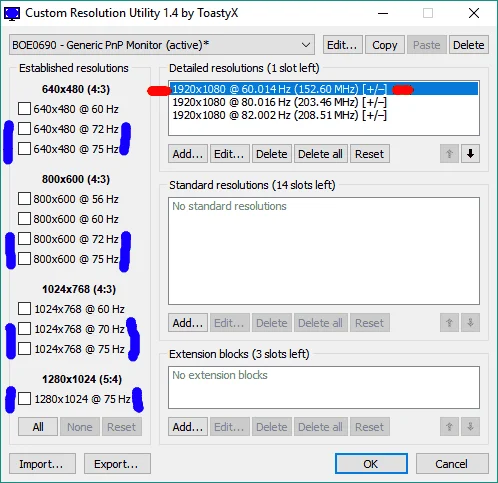

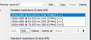

1. Run niyo yung CRU.exe as admin
ganyan lalabas... Tas yang naka PULA, yan yung DEFAULT setting ng iyong monitor... yung BLUE naman yan yung STABLE or MINIMUM OVERCLOCK para sa monitor mo na locked lang sa 60hz sa settings.
2. Click mo yung default resolution mo.. Sa default is yan lang mag-isa sa list

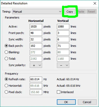

Tas click mo EDIT.
tas press mo COPY tas press CANCEL

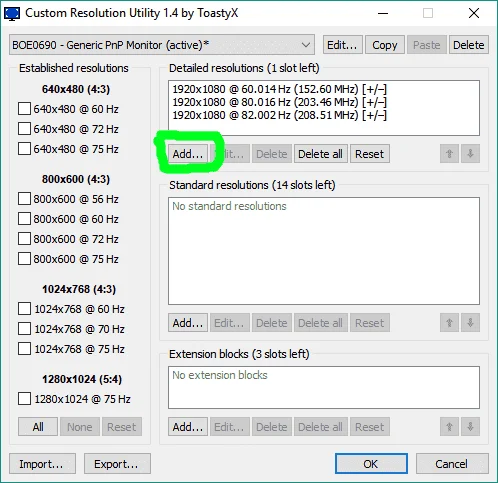

Click mo yang ADD

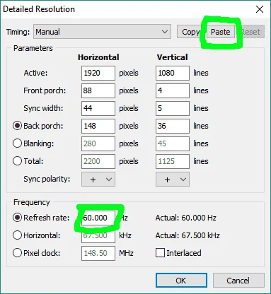

Then PASTE mo TAS MAG SET KA NG HZ, CHANGE MO LANG 60 TO ANY NUMBER NA GUSTO MO NA HIGHER PA SA 60..... I ADVICE YOU NA MAG INCREASE KA NG DAHAN-DAHAN LIKE 65 to 70 to 75 PARA MAKITA MO KUNG STABLE BA..........tas press OK.

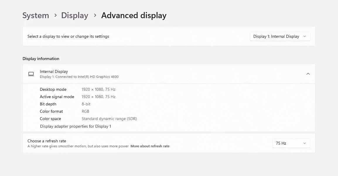

RESTART MO DESKTOP/LAPTOP mo, tas punta ka sa DISPLAY SETTINGS
PUNTA KA SA ADVANCED DISPLAY SETTINGS
PWEDI KANA MAMILI NG GUSTO MONG MONITOR REFRESH RATE OR HZ
Congrats, may upgraded monitor kana for Free!

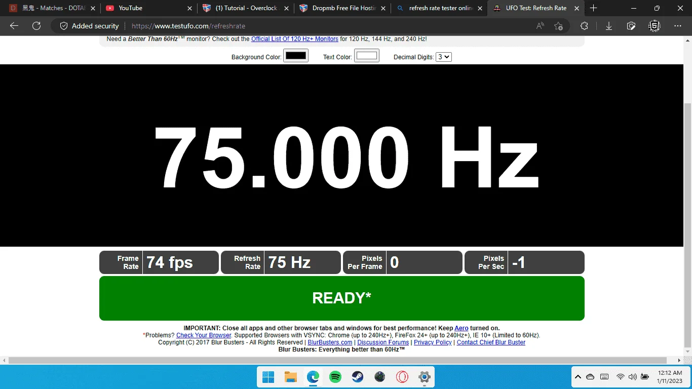

Working sa laptop ko hahahaha, naglaro rin ako full game ng dota di naman nag-crash. Di ko na itatry mag90 since naka integrated gpu lang hahaha
