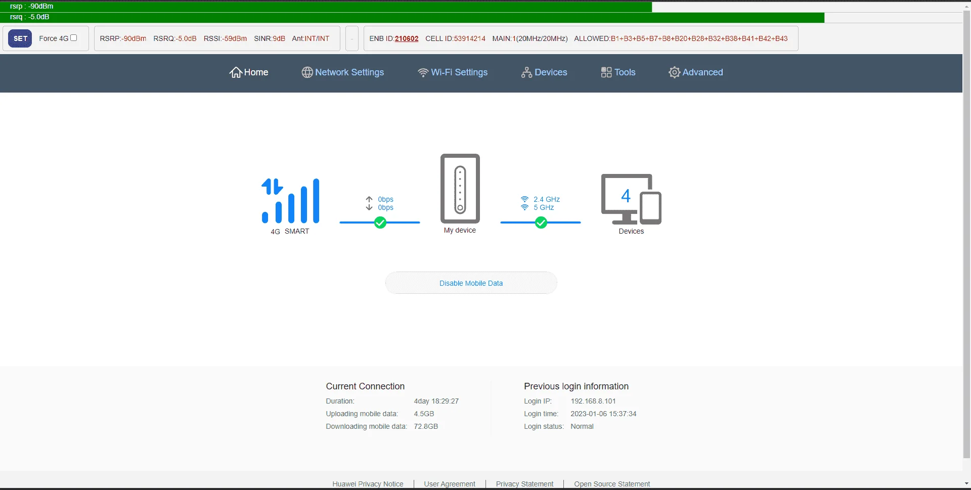

Log in kayo sa Homepage ng B818 sa chrome tapos click nyo yung F12 para lumabas yung developer mode
ipaste nyo to sa Console tab ng dev mode.
Code:
javascript:ftb();function currentBand(){1!=suspend&&($("#dhcp_mask").show(),$("#dhcp_dns").show(),$.ajax({dataType:"text",type:"GET",async:!0,url:"/api/device/signal",error:err,success:function(n){for(signal=n,vars=["nrrsrq","nrrsrp","nrsinr","rssi","rsrp","rsrq","sinr","dlbandwidth","ulbandwidth","band","cell_id","plmn"],i=0;i<vars.length;i++)window[vars[i]]=extractXML(vars[i],n),$("#"+vars[i]).html(window[vars[i]]);nrdefined="undefined"!=typeof nrrsrp,$(".e5").toggle(nrdefined),nrdefined&&(setgraph("nrrsrp",nrrsrp,-130,-70),setgraph("nrrsrq",nrrsrq,-16,-3)),setgraph("rsrp",rsrp,-130,-70),setgraph("rsrq",rsrq,-16,-3),hex=Number(cell_id).toString(16),hex2=hex.substring(0,hex.length-2),enbid=parseInt(hex2,16).toString(),$("#enbid").html(enbid),"22201"==plmn&&(plmn="2221"),"22299"==plmn&&(plmn="22288"),"22250"==plmn&&6==enbid.length&&(plmn="22288"),link_lte="https://lteitaly.it/internal/map.php#bts="+plmn+"."+enbid,$("#lteitaly").attr("href",link_lte)}}),getNetmode(),getStatus(),getAntenna())}function getAntenna(){$.ajax({dataType:"text",type:"GET",async:!0,url:"/api/device/antenna_type",error:err,success:function(n){antenna1type=extractXML("antenna1type",n),antenna2type=extractXML("antenna2type",n),"1"==antenna1type?$("#a1").html("EXT"):$("#a1").html("INT"),"1"==antenna2type?$("#a2").html("EXT"):$("#a2").html("INT")}})}function getNetmode(){$.ajax({type:"GET",dataType:"text",async:!0,url:"/api/net/net-mode",error:err,success:function(n){netmode=n,lteband=extractXML("LTEBand",n),$("#allowed").html(_4GType(lteband))}})}function getStatus(){$.ajax({type:"GET",dataType:"text",async:!0,url:"/api/monitoring/status",error:err,success:function(n){status=n,is4gp=1011==extractXML("CurrentNetworkTypeEx",n)?1:0,is4gp?$("#mode").html("4G+").css("color","red"):$("#mode").html("-").css("color","#aaa")}})}function err(n,e,r){alert("Communication Error"),console.log(n),console.log(e),console.log(r)}function extractXML(n,e){try{return e.split("</"+n+">")[0].split("<"+n+">")[1]}catch(n){return n.message}}function setgraph(n,r,t,a){r=parseInt(r.replace("dBm","").replace("dB")),x=(r-t)/(a-t)*100,xs=String(x)+String.fromCharCode(37),e="#"+n+"b",$(e).animate({width:xs}),$(e).html(n.replace("nr","5G - ")+" : "+window[n]),x<50?$(e).css("background-color","yellow").css("color","black"):(85<x?$(e).css("background-color","orange"):$(e).css("background-color","green")).css("color","white")}function _4GType(n){for(data_out="",x=0;x<90;x++)tb=Math.pow(2,x),color=BigInt("0x"+n)&BigInt(tb)?(data_out+="B"+String(x+1)+"+","#686"):"transparent",$("#cb"+String(x+1)).css("background-color",color);return data_out=data_out.replace(/\++$/,""),data_out}function ltebandselection(n){if(mainband=mainband&&null,0==arguments.length){if(null==(e=(e=prompt("Please input LTE bands number, separated by + char (example 1+3+20).If you want to use every supported bands, write 'AUTO'.","AUTO"))&&e.toLowerCase())||""===e)return}else var e=arguments[0];var n=e.split("+"),t=0;if("AUTO"===e.toUpperCase())t="7FFFFFFFFFFFFFFF";else{for(var r=0;r<n.length;r++){if(-1!=n[r].toLowerCase().indexOf("m")&&(n[r]=n[r].replace("m",""),mainband=n[r]),"AUTO"===n[r].toUpperCase()){t="7FFFFFFFFFFFFFFF";break}t+=Math.pow(2,parseInt(n[r])-1)}t=t.toString(16)}if(mainband)return _2ndrun=n,void ltebandselection(String(mainband));suspend=1,$("#t").html("! PLEASE WAIT !").show(),$.ajax({type:"GET",dataType:"text",async:!0,url:"/html/home.html",error:err,success:function(n){var n=n.split('name="csrf_token" content="'),e=n[n.length-1].split('"')[0],r="00";$("#force4g").is(":checked")&&(r="03"),setTimeout(function(){$.ajax({type:"POST",async:!0,url:"/api/net/net-mode",headers:{__RequestVerificationToken:e},contentType:"application/xml",data:"<request><NetworkMode>"+r+"</NetworkMode><NetworkBand>3FFFFFFF</NetworkBand><LTEBand>"+t+"</LTEBand></request>",success:function(n){$("#band").html('<span style="color:green;">OK</span>'),_2ndrun?window.setTimeout(function(){ltebandselection(_2ndrun.join("+")),_2ndrun=!1},2e3):(suspend=0,$("#t").hide(""))},error:err})},2e3)}})}function ftb(){$(".color_background_blue").css("background-color","#456"),$(".headcontainer").hide(),$("body").prepend('<style> #rsrq,#nrrsrq, #rsrp,#nrrsrp, #rssi, #enbid, #sinr,#nrsinr, #cell_id, #band, #allowed, #a1, #a2 {color: #b00; font-weight: strong; } .f {float: left; border: 1px solid #bbb; border-radius: 5px; padding: 10px; line-height: 2em; margin: 5px; } .f ul {margin: 0; padding: 0; } .f ul li {display: inline; margin-right: 10px; } #mode {margin-right: 0 !important; } #enbid {font-weight: bold; text-decoration: underline; } .p {border-bottom: 1px solid #ccc; width: auto; height: 20px; } .v {height: 20px; border-right: 1px solid #ccc; } .sb {padding: 10px; border-radius: 10px; display: inline-block; margin: 10px 0 10px 10px; } #t {color: white; background-color: #888; margin: 10px; padding: 25px; border-radius: 10px; display: none; text-align: center; font-weight: bolder; } .v {padding-left: 20px; } </style> <div class="p e5"> <div class="v" id="nrrsrpb"></div> </div> <div class="p e5"> <div class="v" id="nrrsrqb"></div> </div> <div class="p"> <div class="v" id="rsrpb"></div> </div> <div class="p"> <div class="v" id="rsrqb"></div> </div> <div style="display:block;overflow: auto;"> <div id="t"></div> <div class="f"> <ul> <li><a style="font-weight:bolder;background-color: #448;color:white;padding: 10px;border-radius:10px;" onclick="ltebandselection()">SET</a></li> <li><label>Force 4G</label><input id="force4g" type="checkbox"></li> </ul> </div> <div class="f"> <ul> <li>RSRP:<span id="rsrp"></span></li> <li>RSRQ:<span id="rsrq"></span></li> <li>RSSI:<span id="rssi"></span></li> <li>SINR:<span id="sinr"></span></li> <li>Ant:<span id="a1"></span>/<span id="a2"></span></li> </ul> </div> <div class="f e5"> <ul> <li>5-RSRP:<span id="nrrsrp"></span></li> <li>5-RSRQ:<span id="nrrsrq"></span></li> <li>5-SINR:<span id="nrsinr"></span></li> </ul> </div> <div class="f"> <ul> <li id="mode">Che la banda sia con te! Miononno &#9829;</li> </ul> </div> <div class="f"> <ul> <li>ENB ID:<a id="lteitaly" target="lteitaly" href="#"><span id="enbid">#</span></a></li> <li>CELL ID:<span id="cell_id">#</span></li> <li>MAIN:<span id="band"></span>(<span id="dlbandwidth"></span>/<span id="ulbandwidth"></span>)</li> <li>ALLOWED:<span id="allowed"></span></li> </ul> </div>')}mainband=null,_2ndrun=null,suspend=0,status="",netmode="",signal="",version="4.0",console.log("Code by Miononno - v"+version),console.log("type: netmode , signal , status"),window.setInterval(currentBand,2500);

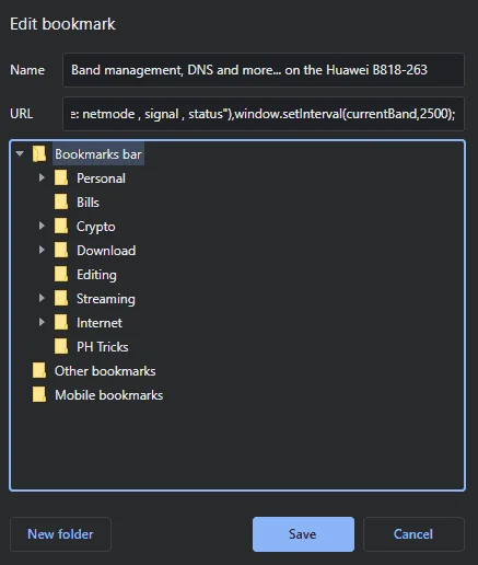

or para hindi na kayo mag paste palagi ng script. Ibookmark nyo yung mismong script.
Gawa kayo bookmark sa Chrome tapos lagyan nyo ng kahit anong name
tapos sa URL nyo ilagay yung mismong script
para kapag mag bandlock kayo using Chrome. icli-click nyo nalang yung bookmark at lalabas na yung mismong bandlock

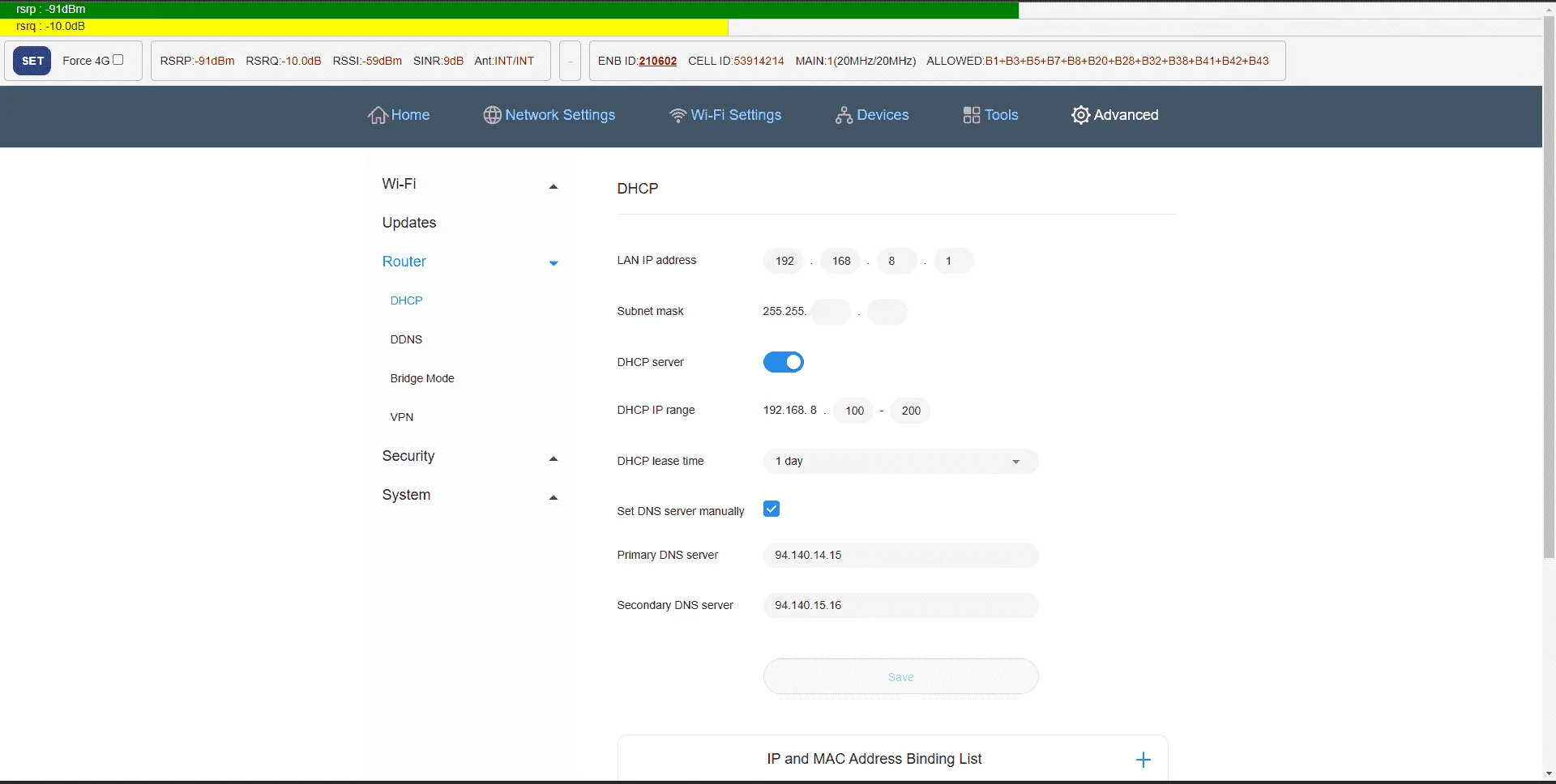

PS:
pwede ka din mag change ng DNS gamit yung script.
Explore nyo nalang. 🙂
