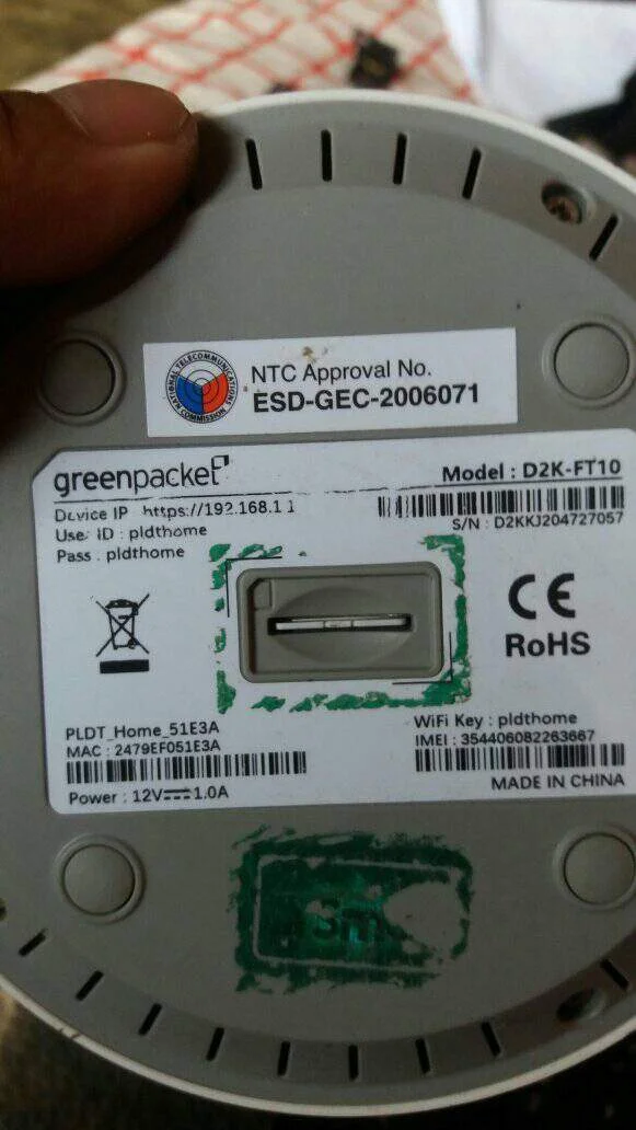

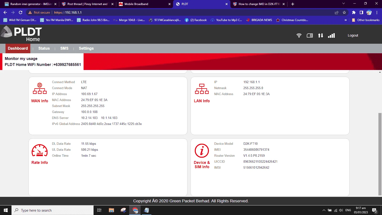

ayan po yung original na imei ko from modem then i try to change using the generated imei.
Note: yung firmware ng modem ko is unlireset po ni sir jeromelaliag.
