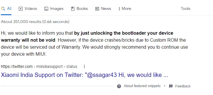

di na yan cover kung alam mo yung icon nasa itaas naka unlock na.
na tru mo adbfastboot jar. yun ang ginagamit for complete format pati bootloader ma lolock yun sin ginagamitnkapag hard bricked. enjoy this is the last resort and then kapag notnworking removed na unlock bootloader niyan you can do warranty. next time maingat sa pag change ng os or firmware ah
