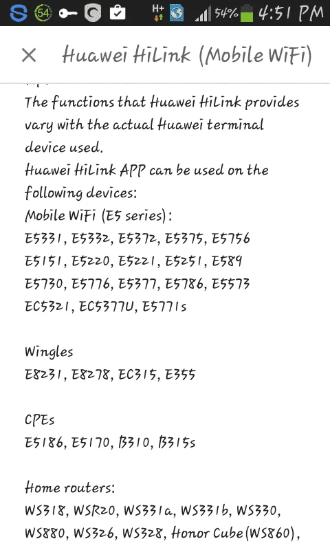

#2 Kung wala naman. Android phone nalang tapos download kayo sa playstore ng HiLink. (y)

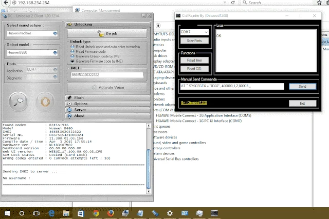

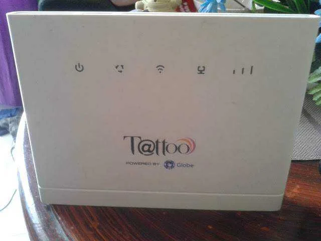

HUAWEI B315S-936 UNLOCKING Step by Step
Before we start.. this tutorial does not belong to me this is just compilation of unlocking B315S-936.
What I found here is you don't need to put unlocked code ( Algo code )
Cid Reader is enough and a little command..
Unlocking will be done on USB mode (GREEN LED) for the first time unit going to USB Mode is easy... the 2nd time a round have some little difficulties.
On the USB Mode you need USB cable Male to Male gawa ka nalang!
Putulin mo yung USB charger na Sira i dugtong mo Male to Male pag pares pares mo yung kulay ng cable..
Uhm hindi sakin unit eto .. hahaha sandali kolang nagalaw.

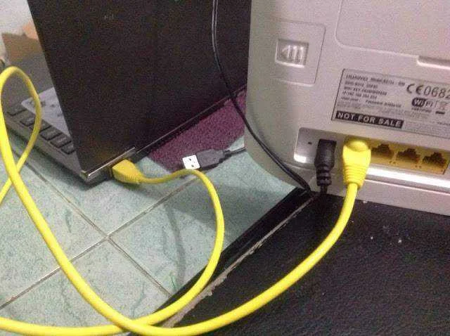

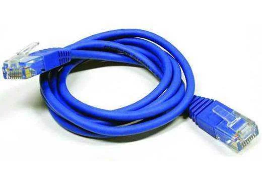

Kailangan mo din ng LAN cable ( in case na super newbie ka mag unlock nito )
I tried DC Unlocker, Cid Reader by DAWOOD128 Huawei Cid Reader (GSM Forum)

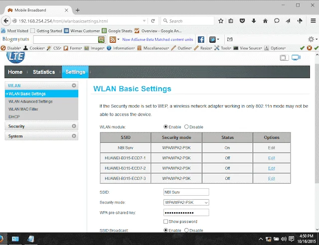

User Interface:

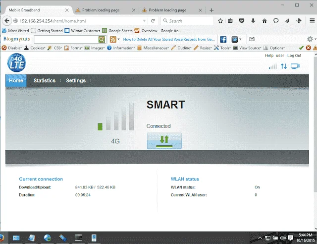

Modem IP: 192.168.254.254
user: user
pass: @l03e1t3

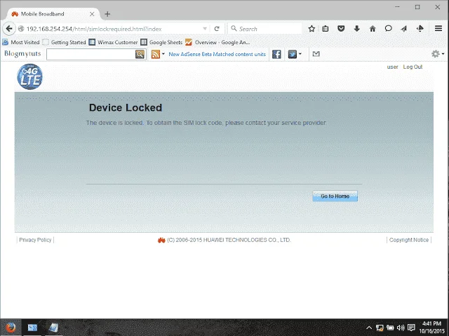

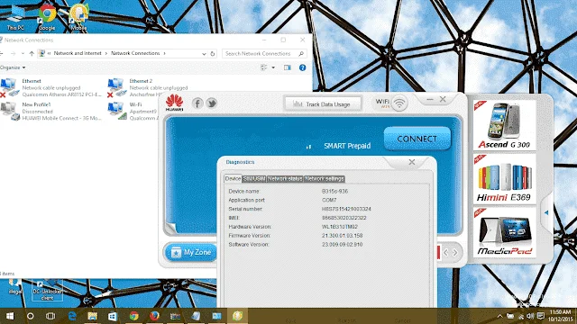

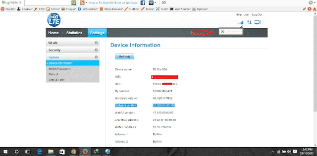

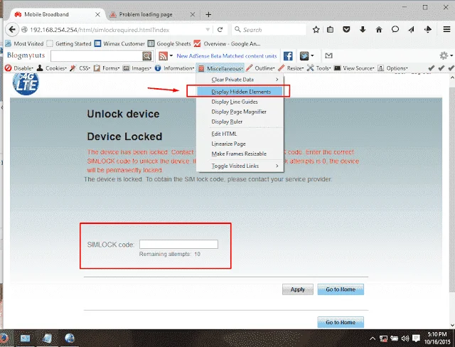

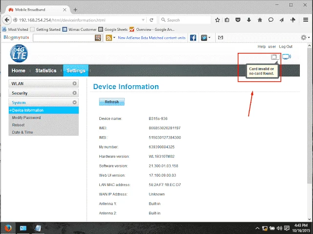

I inserted SMART LTE Sim as you can see Device is Locked..

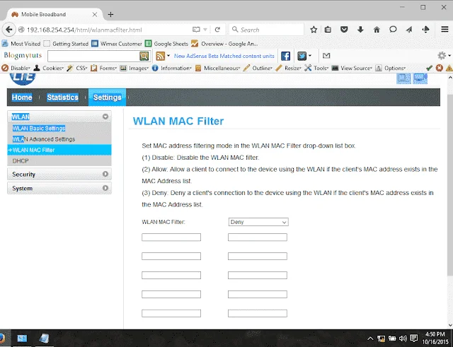

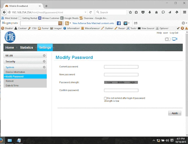

Changing WiFi SSID and Password Go to Settings -> WLAN Basic Settings.
You can block any client here with their MAC
You can also Change the default user password here.
You can access You do not have permission to view the full content of this post. Log in or register now. you can insert Unlocked Code or New ALGO (but this is useless)

1.) Install Mobile Partner version 23
This have compatible driver for model 660 on USB Mode tried and tested on Win 10
File size : 33.50 MB
Download Link : You do not have permission to view the full content of this post. Log in or register now.
(Gamit ku din eto pang unlock sa Huawei E357 ng Globe hindi kasi mag ko close yang pwede mu ilagay yung PIN)

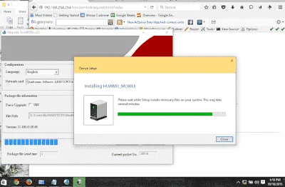

NOTE: Sa mga nag rereklamo ayaw ng driver konting diskarte naman dyan manual nyo ilagay yung driver punta sa device manager , update yung driver ... mag browse sa folder ng Mobile Partner nandyan yung driver... installl
goto other page
2. ) HUAWEI B315S-936 on USB Mode (GREEN LED LIGHT) :
There are 2 method on how to have stable green lights i t depends on your situation :
NOTE: USB MODE Method B is the most effective!
Method A) First Time USB Mode of the UNIT : Unang try palang or ****** sa USB Mode
1. PRESS and Hold WPS+Power (pindutin nyo wag nyo bibitawan hangat di ko sinasabi!!)
2. Plug your modem Power
RED LED Lights
3. When RED LED is out Release WPS + Power and wait for Color Blue LED light.
4. Wait untill the LED light turn GREEN and when it Steady USB Mode is ready.. Plug your USB cable to your Computer mobile partner will install required driver if not try manualy update driver and browse mobile partner on program files.

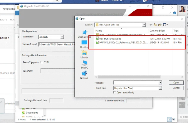

Method B) Second Time USB Mode : eto yung na Bugbug na kaka try ng USB Mode (GREEN ) dahil mali yung unang pindut kalikot .

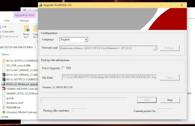

1. Hanap ka ng Multicast Tool gaya ng You do not have permission to view the full content of this post. Log in or register now.
2. Select mo yung LAN saan mo isasaksak yung Modem mo (Lancard) Pati USB cable Buksan nadin yung Mobile Partner (hindi pwede sa WiFi ah!!) Off mo WiFi ng Laptop mo kung Laptop gamit mo hindi kasi gagana Multicast ng maayos..
3. Upload ka ng kahit anung bin firmware (sample is yung firmware ng 593) then click START
4. Dinagdag ko ang step 4 na eto para sa hindi marunong mag Multicast! . Bunutin nyo saksak ng MODEM saka nyo i saksak ulit!
4. Observe your modem Blue LED Light while upgrading is in process.
NOTE: Pag hindi kumagat yung UPGRADE, MALI po ang pag gamit nyo ng Mulicast Dapat naka OFF muna yung modem hindi naka plug yung saksakan or USB. pag click ng START button Duon nyo palang isaksak yung Modem

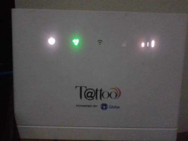

5. HUAWEI B315S-936 will reject to unverified firmware it will turn to RED LED now Click STOP on Multicast Upgrader.
6. Wait till RED LED is Stable... and then press WPS+Power = SABAY DAPAT pag SABLAY WALEY!!! wait till the RED LED light turn off (minsan 2x masisindi pa yun para sure wait kapa mga 5 seconds baka sumindi pa yung RED )then release WPS+Power (bitawan muna)
7. It will turn Blue again then wait a few second sipol sipol ka muna.. mag GREEN LED stay Stable..
Your USB Mode is Ready!!.

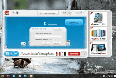

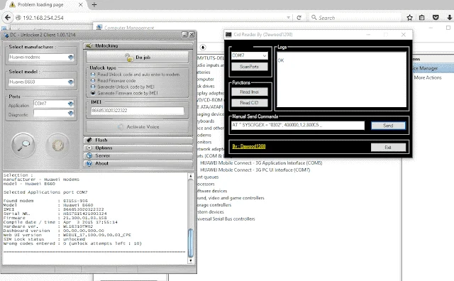

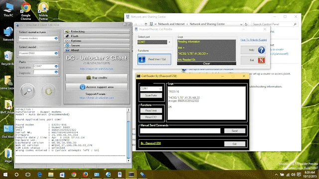

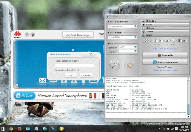

1.This is the easy part you can check your Modem Unlock Status on DC unlocker or Open the Mobile Partner App.

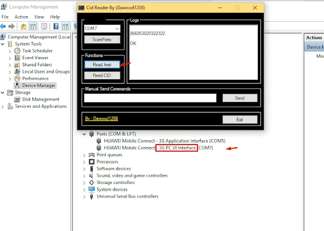

(NOTE : Hindi nyo pwede pag sabayin yang dalawang App gumagamit sila ng iisang COM port mag ha hang si DC Unlocker (PC UI Interface makikita nyo sa device manager yan )
2. If you have DC Unlocker Credits you can directly unlocked the Modem now (hindi ko ginamit yung credit ko sayang tinray ko muna yung isa )
3. Unlocked by Cid Reader by DAWOOD128 ( original post tootsie) or Huawei Cid Reader (GSM Forum) download mo cge para wala na tanong tanong ng link eh meron naman kasi sa net nyan.. huwag tamad mag comment ng thanks and hit like or feedback after neto............
Link

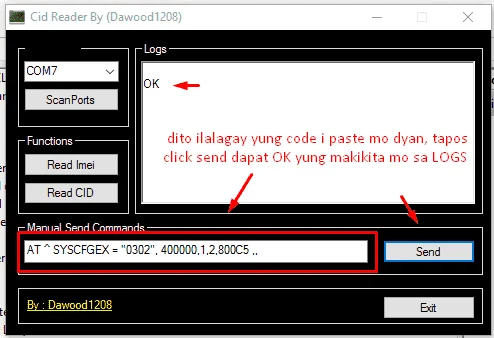

a) Put the right COM port (you can find that on device manager) : sample here Com7.
b) Read Imei (for testing purposes )
next page hindi kasya
ac) Input this three code copy paste on Manul send command
First -Unang code:
at ^ nvwrex = 8268,0,12,1,0,0,0,2,0,0,0, a, 0,0,0
after sending command you will receive OK delete the OK
Second Pangalawang code:
AT ^ SYSCFGEX = "00", 3FFFFFFF, 1,2,800C5 ,,
Third Pangatlong code:
AT ^ SYSCFGEX = "0302", 400000,1,2,800C5 ,,
Kaya ko pina delete yung OK para sure OK yung natangap mo reply kapag 3 OK na unlocked na yan modem mo...

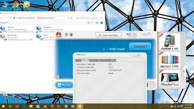

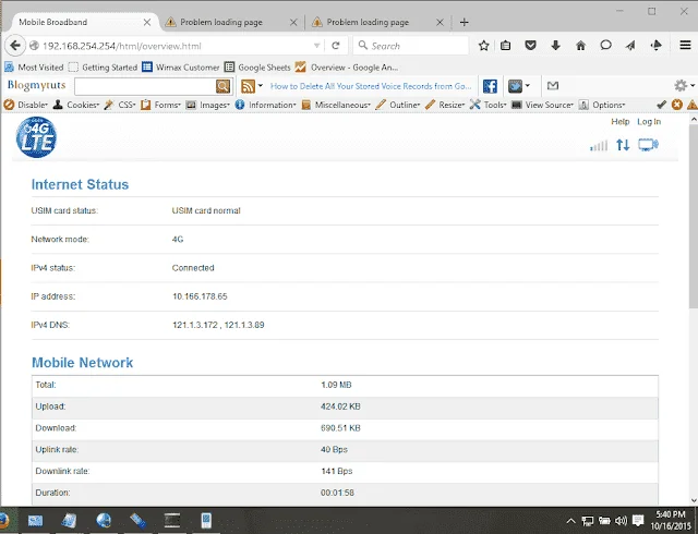

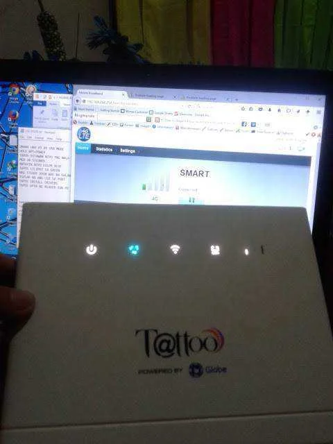

Check Your Modem is Unlocked Insert Smart Sim.. Plug power cable then unplug again.. Check if it can read the Sim.

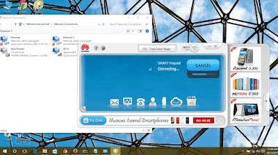

Checking via Mobile Partner on USB Mode.
Unlocked Check by Browser ..
SKY BLUE LED LIGHT 4G connection
3G Mode Regular Smart Sim
NOTE: Sa mga nag tatanong bakit 3G lang signal ng modem nila.. Dipende sa Area yan kung available ang 4G or malakas ang 4G at Dapat siyempre LTE Sim ang gagamitin Yung sa tuts ko LTE Sim ng Smart (Prepaid) na agad gamit at agad naman nag connect dahil LTE na ang City dito sa amin. Sa Mobile Partner yung sakin naka set ng Auto.. Tested na na yan pag 3G lang available 3G lang yung modem na try na yan sa ibang Area ng nag pa unlocked.
