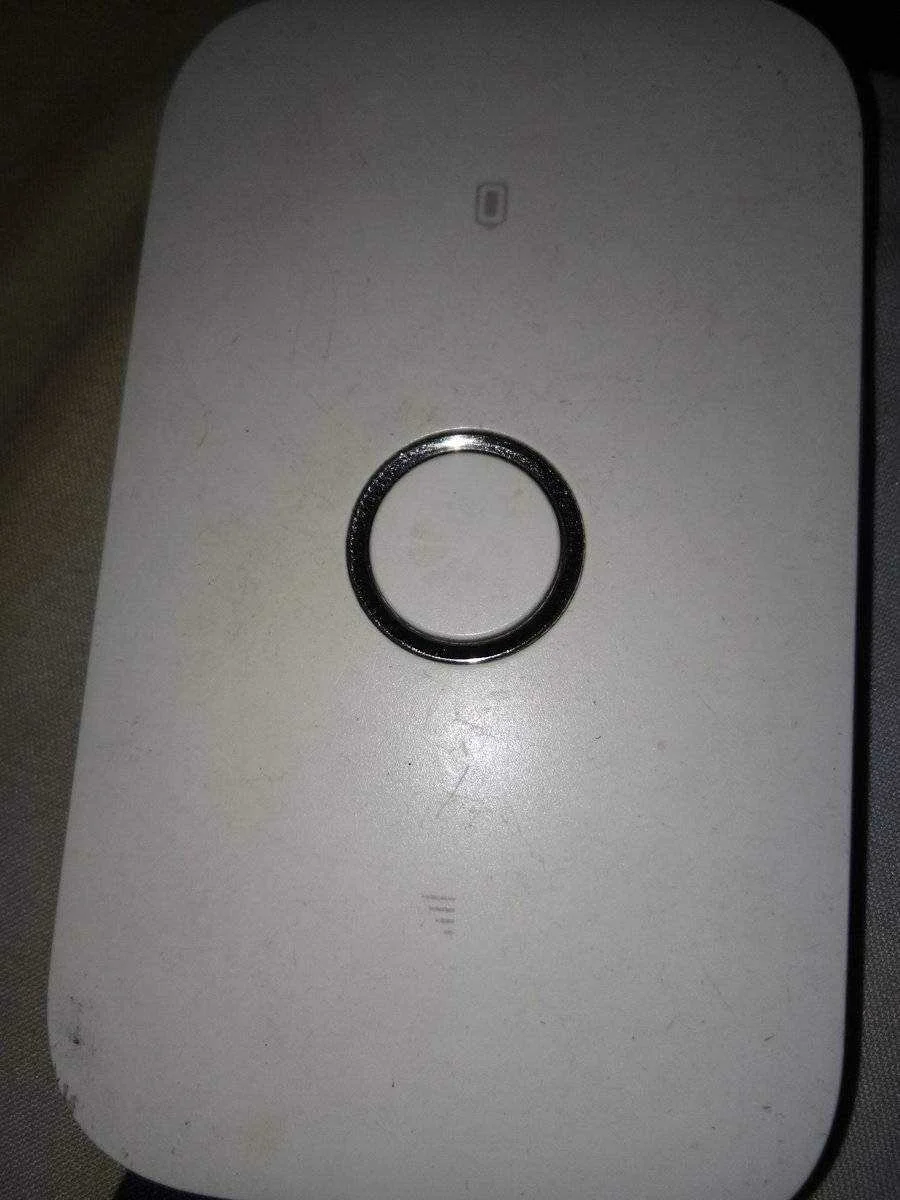

Sir pa openline din po kung aplicable
model :FX-PR3L
imei:864052030193029
Salamat po.,
monitor ko po post nyo.,

Boss pa help naman ng akin.. ayaw nya eh.. eto ung ibinigay at mga nakalap ko.. almost 3attempt na lang po kasi sya eh..
Sana matulungan nyo po ako..
Model No. : E5330Cs-82
IMEI : 861303037745441
NEW ALGO CODE : 64039188
OLD ALGO CODE : 34272120
FLASH CODE : 61041393
Unlock (V1): 34272120
Unlock (V2): 64039188
Unlock (V3/201): 20395125
Salamat in advance..
