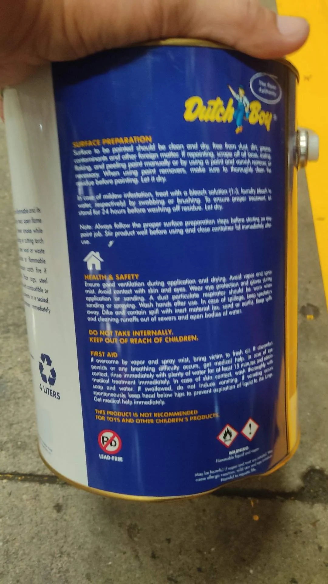

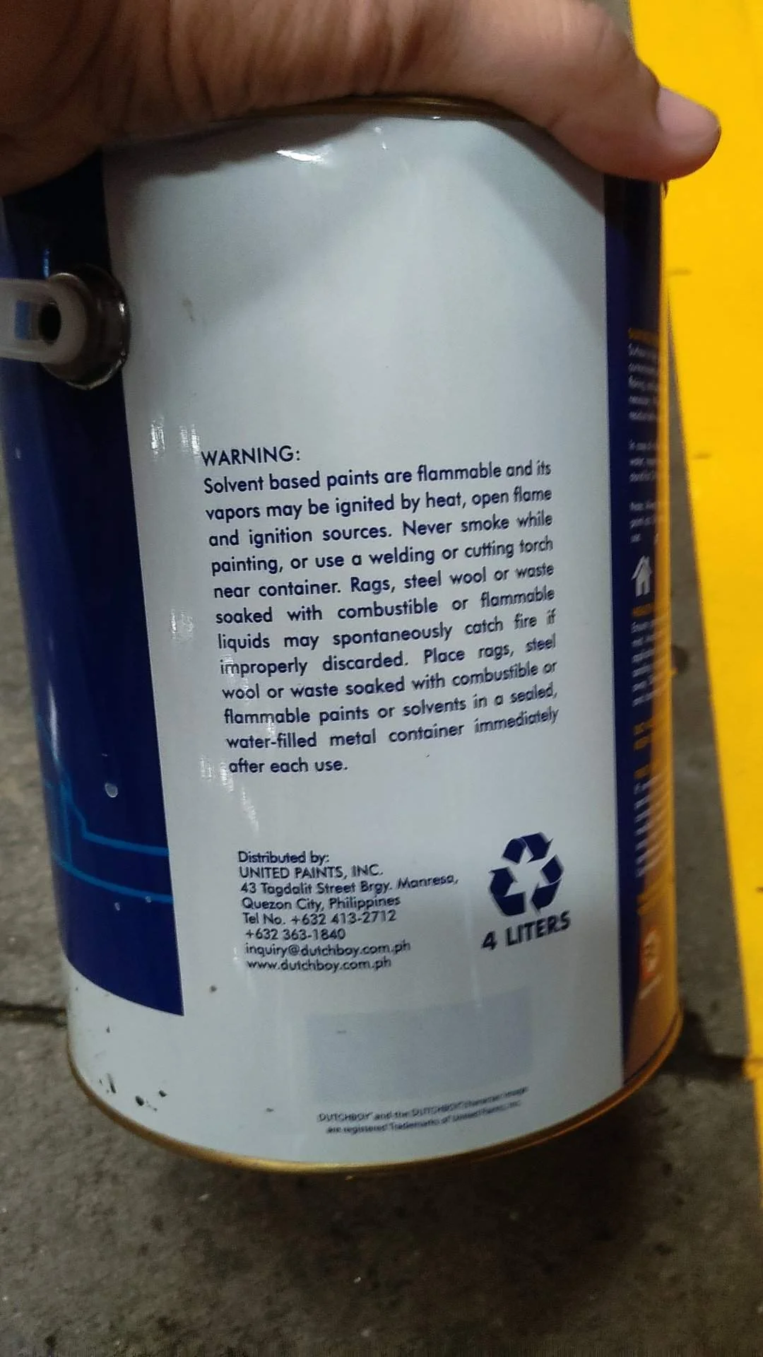

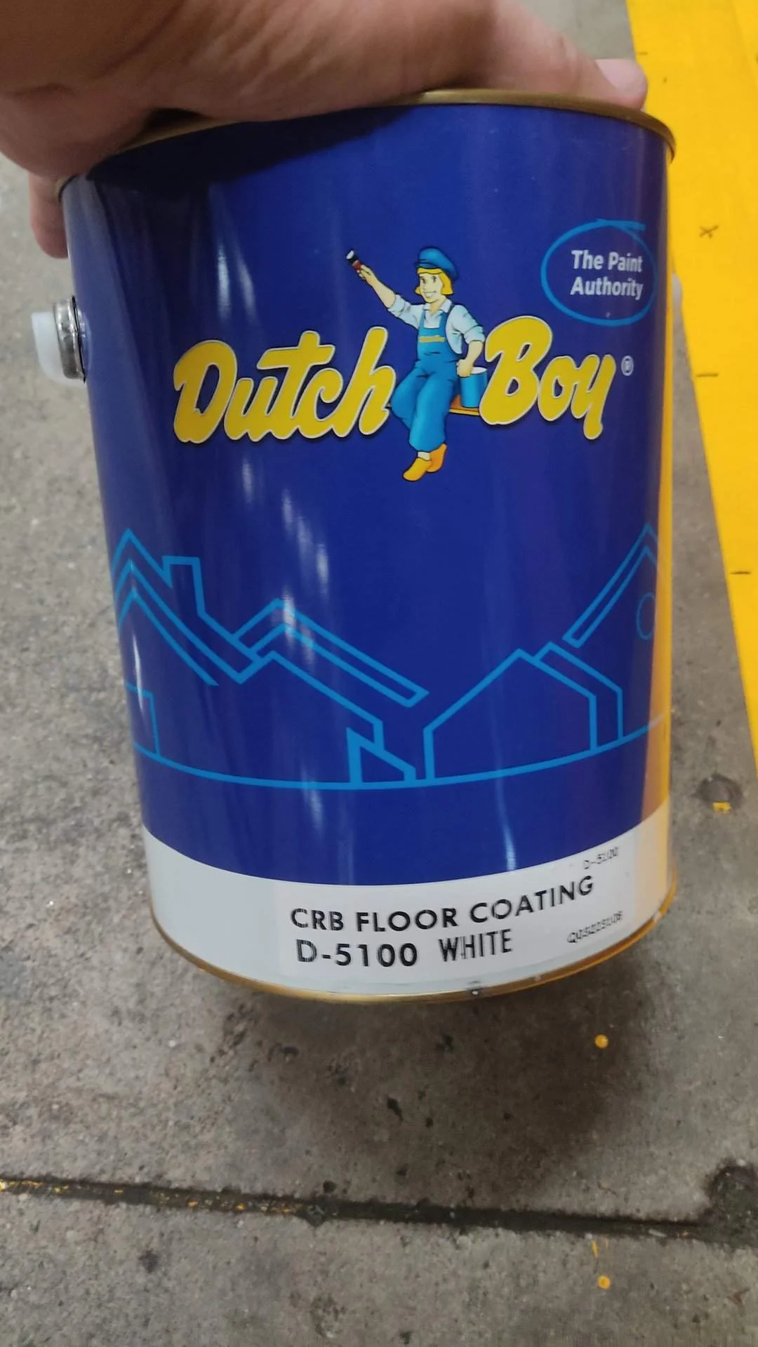

mga boss ask ko lang kung anong pwedeng panghalo dito sa pintura na to para lumabnaw. wala kaming alam dito sa trabaho e. hehe salamat sa sasagot. happy new year. 🥰
next time wag gamitan ng lacquer prone to chalk yan or c-rack,
hanapan nyo alternative na reducer (ibang brands) pag gagamitan ng rubber based paints
at para maganda kapit
1. surface preparation (walang alikabok o dumi)
2. primer (epoxy primer) / sealer (overnight drying time)
3. top/finish coat (crb flooring paints) 2 coats

minor knowledge bossing, yang tatlo lagi ko guide
surface prep (pinakaimportante)
sa reducer (thinner) lang magkakaiba depende pintura at pangagamitan
mas ok pag isang brand from primer/sealer/undercoat, topcoat at reducer (thinner)
yung ginamit nyo as per specs no need primer,
observe nyo nalan basta hindi sa parking or garahe inapply
tamang tambay ka boss sa boysen site nandun sample ideas ng paint schedule at klase ng pintura
saka mo kumpara sa ibang brands saka nyo canvass presyo

ok boss. sa warehouse namen ginamit yung paints. bale mga forklift at tao lang dumadaan dun. salamat ulet boss.
