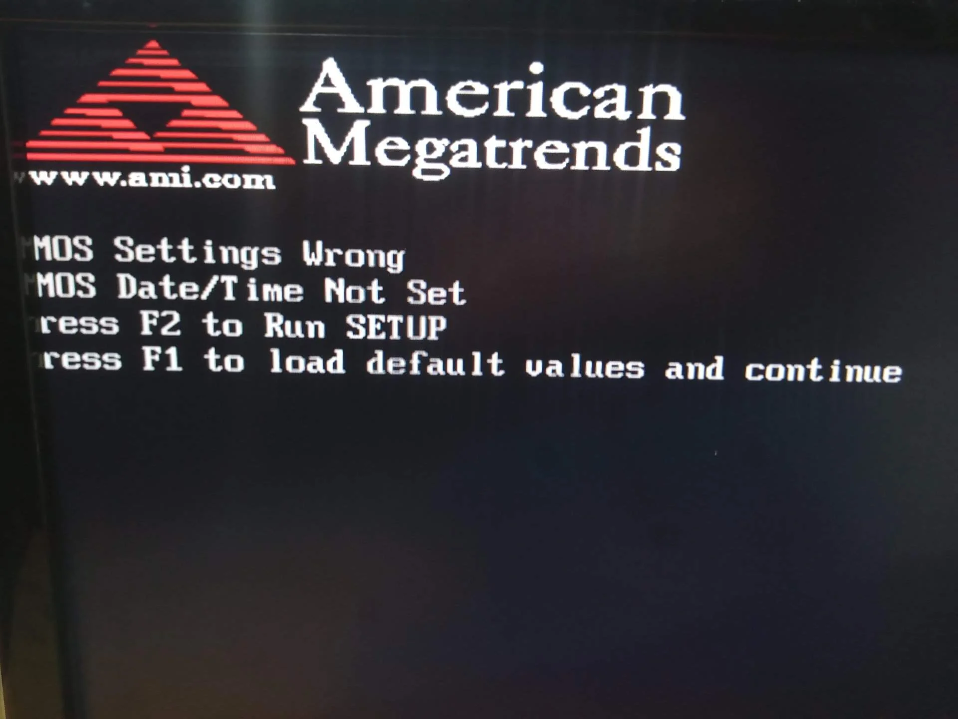

Nag palit ako ng power supply tapos accidentally na remove ko yung cmos battery tas binalik ko namn, pag on ko nag ka ganyan na. Kahit anong press ko sa keyboard wala parin epek, tulongan nyo namn ako. ( Okay namn yung cmos battery hindi namn sira, na check ko yung voltage kanina malakas pa ) IMG_20221205_173401_240.webp
boss ilagay mo sa dati yung jumper mo at alisin mo yung battery in 10min at wag mong buksan ang system mo untill your cmos is back
or power off your computer and wait for the system to drain the power on the capacitor and place your jumper on 1 and 2 for 3 min do not on your system because you have cmos battery as power of your cmos
Gamit ka po PS/2 keyboard
Ito gawin... Sa mga lumang bios di nadetech agad ung usb type na keyboard pag pasok ng windows tsaka lng madedetect sya... Tska wag mu ng galawin ung pin sa reset kaya laging may f1 f2 yan dahil need mu muna ma setup ung time/date para mag tuloy tuloy yan baka masira pa ng tuluyan motherboard mu
Baka di nga marecognize ung keyboard mo na usb. You need ps2 type connector keyboard. Di mo talaga mapapagana yan even with reset. Some mother like the old bios system need ps2 connector as default.
drain mo ung cmos, remove mo ung power socket ng PC tapos ung cmos battery ng ilang minuto. Kung di pa rin sya gumana cmos clear lang, usually may jumper ung motherboard para dun.
