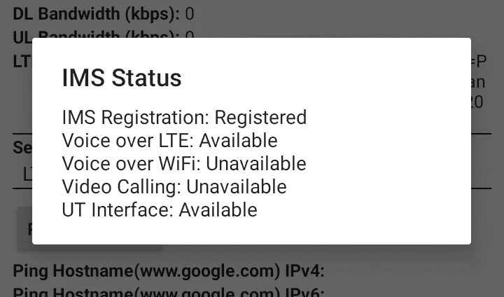

Here is the result of the IMS service status on my device.
Well, it means the video calling seems it was disabled by default, but possible based on the MediaTek specifications, my platform is MediaTek Helio P23 You do not have permission to view the full content of this post. Log in or register now..
Next method I can do is to make temporary video call as available on my device, but I don't think if it's gonna work because when I turn off my device or I switch the Airplane mode, it will reset it's default to make video calls unavailable.

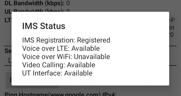

So I will open EngineerMode of my device to enable video_over_ps_support which is involved in IMS status. Here is the steps.
• In telephony section, tap IMS → Choose your SIM slot
• Tap Common
• Tap video_over_ps_support
• Enter the number, change the value to "1" (from 0), and hit SET.
Here it happens the video call makes available:
While in the dialer, it was changed the video call method See the footage:

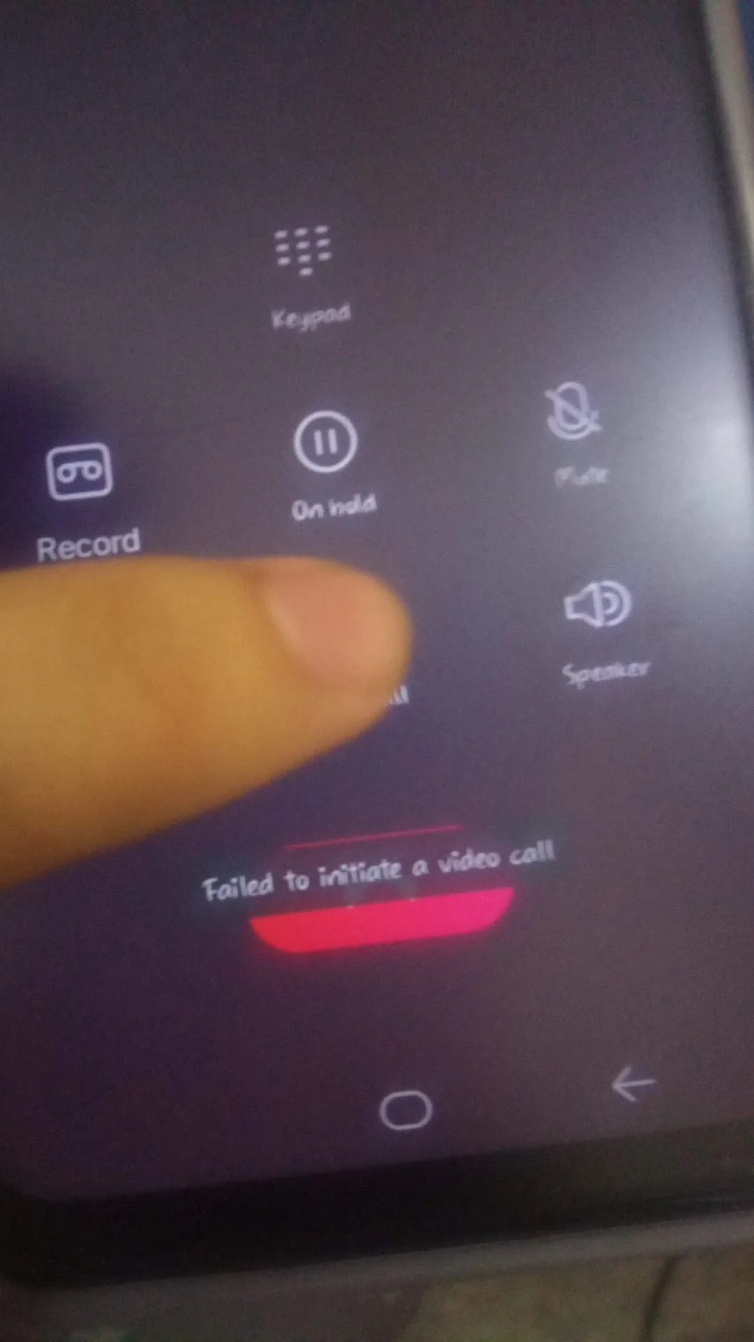

Now I enabled the video_over_ps_support, so next is to initiate a video call with DITO to DITO.
Here it happens when initiate a video call.
View attachment InShot_20221127_151804994.mp4

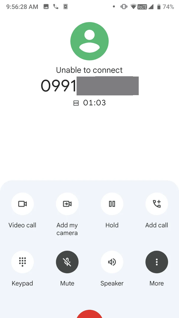

The video call does not work, it shows "Service Unreachable" it means it was failed to initiate carrier video call.
Even in the call, i pressed the Video call or Add my camera but still showing "Unable to connect", while the vivo Y12 is initiated a video call but my device doesn't show the alert to join the video call.
So in the end, my device is really not compatible to initiate carrier video calls (ViLTE), it was impossible to enable it without root privileges. At least I have VoLTE which is limited for everyone to make a video calls.
