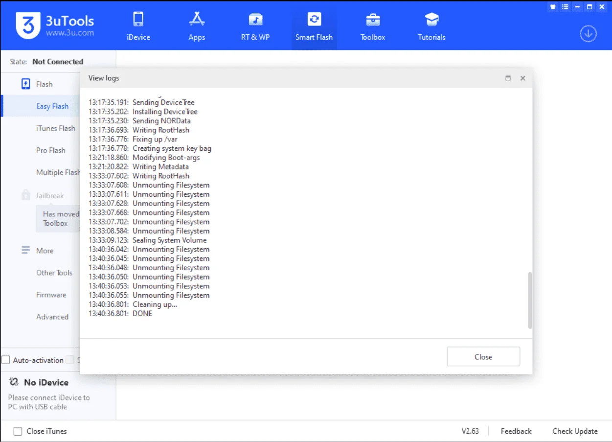

Ask ko lang po ano po possible solution neto? Nag update kasi then nag bootloop na. Faulty battery nadin siya pero nagana naman before ko iupdate tia
Reflash nyo nalang po gamit itunes or 3utools make sure na alam mo apple id or naka off icloud ng iphone mo para iwas disgrasya mamaya ^^
Possible solution:
Download latest firmware (ipsw dot me ) hanapin nyo lang po model ng iphone nyo and download mo yung naka signed pa na firmware
Flash 3utools (Retain data) muna kung kaya baka may need ka files or pics,or video dyan sa phone mo kasi once na nag clean flash ka nyan bura lahat.
Pag error try change port or usb cord mas maganda original cord
pag ayaw sa retain data piliin mo yung quick flash mode
pag stuck 18 or 19% sira NAND IC nyan error code "4013"
Possible solution:
Possible po kaya sa battery? kasi wala naman error during flash then one time bumakas siya nag hello pero sobrang bagal. nirestart ko and bootloop uli. no health na kasi yung battery TIA
