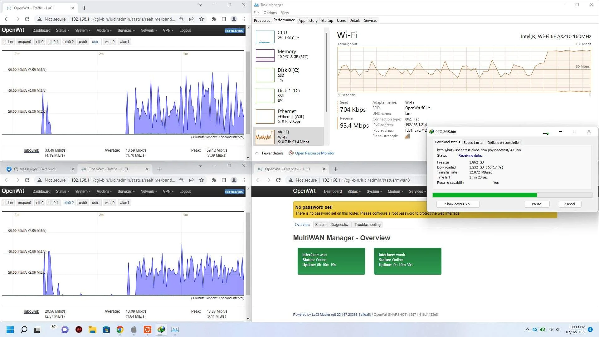

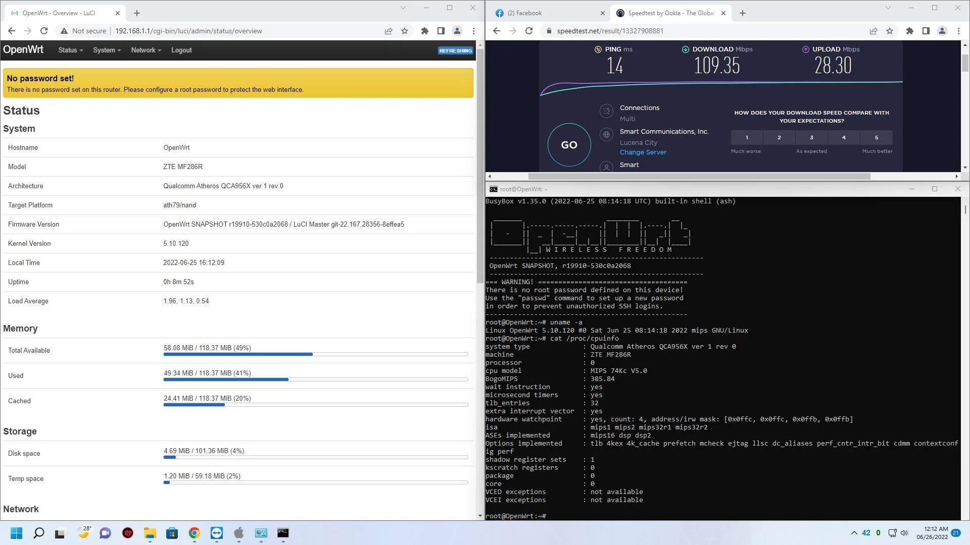

OpenWRT Features
  • VLAN Enabled

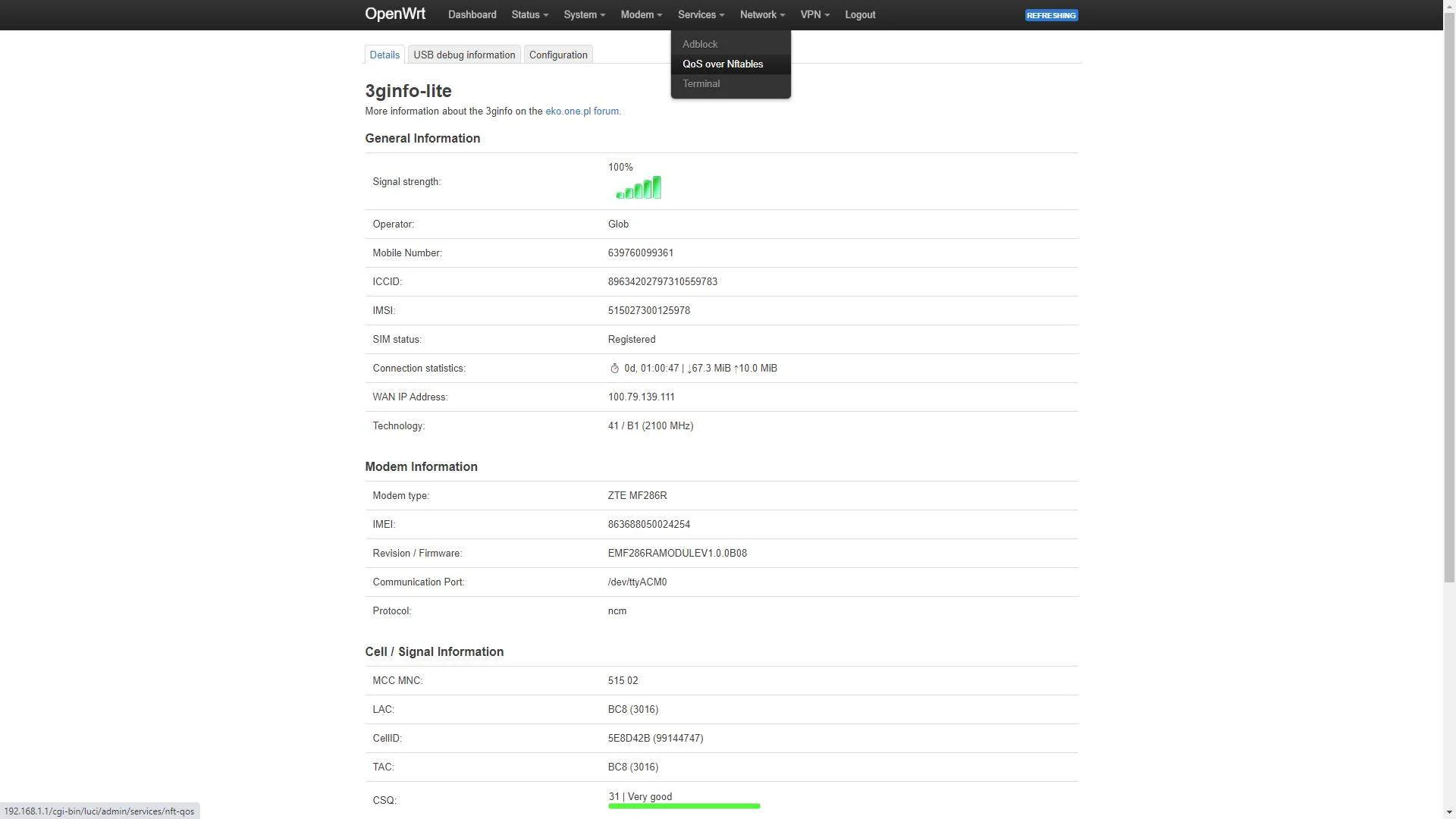

  • luci-app-3ginfo-lite - LTE Signal information. Add additional info sa 3ginfo-lite: Mobile Number, ICCID, IMSI and IMEI.
  • luci-app-adblock - Builtin adblocker.
  • luci-app-modemband - LTE Multi Band 1,3,5,8,28,40,41 selector.
  • luci-app-mwan3 - MultiWAN for loadbalance, failover, etc. Pre-config, plug and play for WAN/LAN1 port.

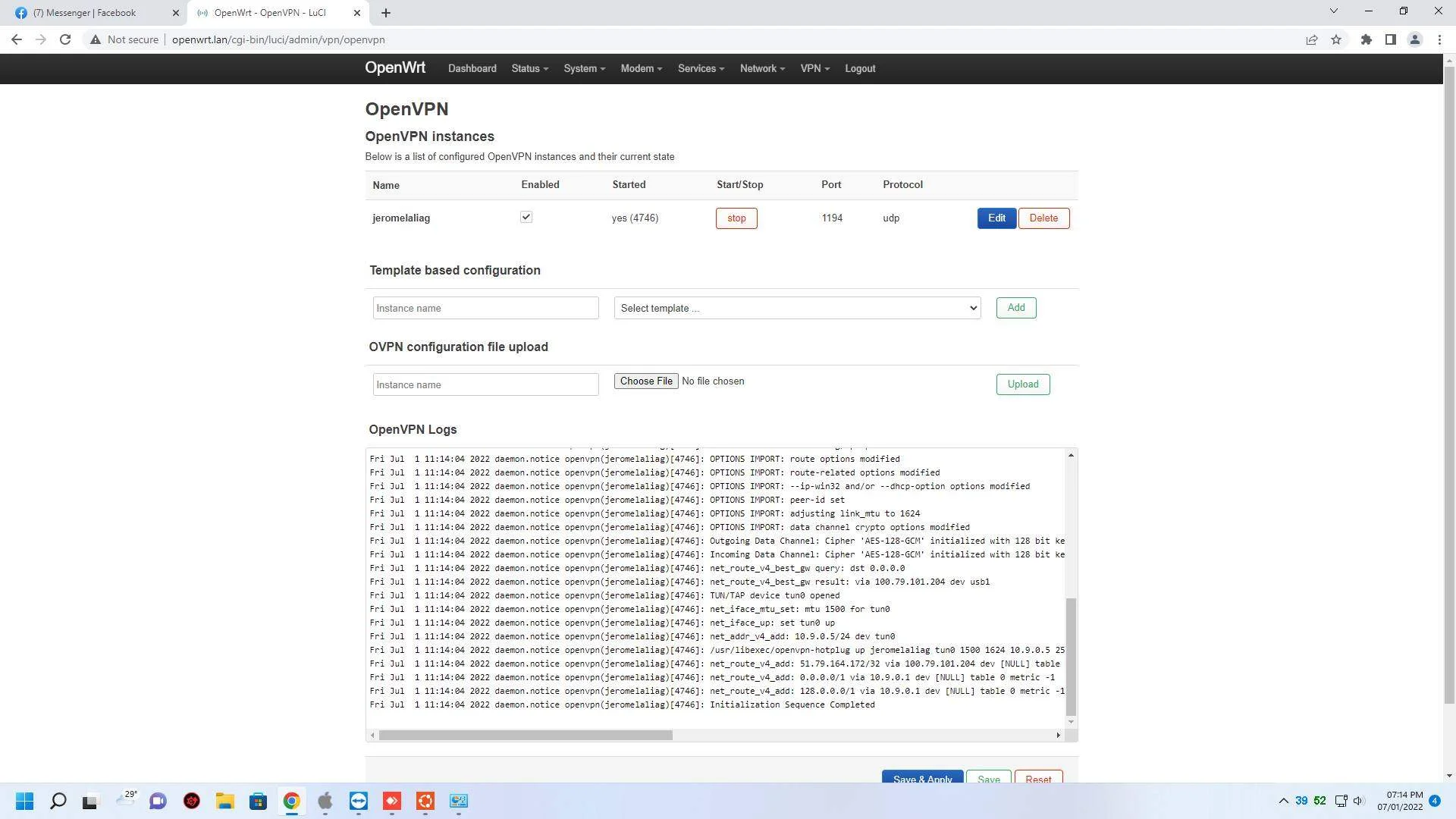

  • luci-app-openvpn - Buitin OpenVPN Client with logs.
  • luci-app-opkg - Add, update, install openwrt packages.
  • luci-app-sms-tool - Recieved messages, send messages, AT commands.

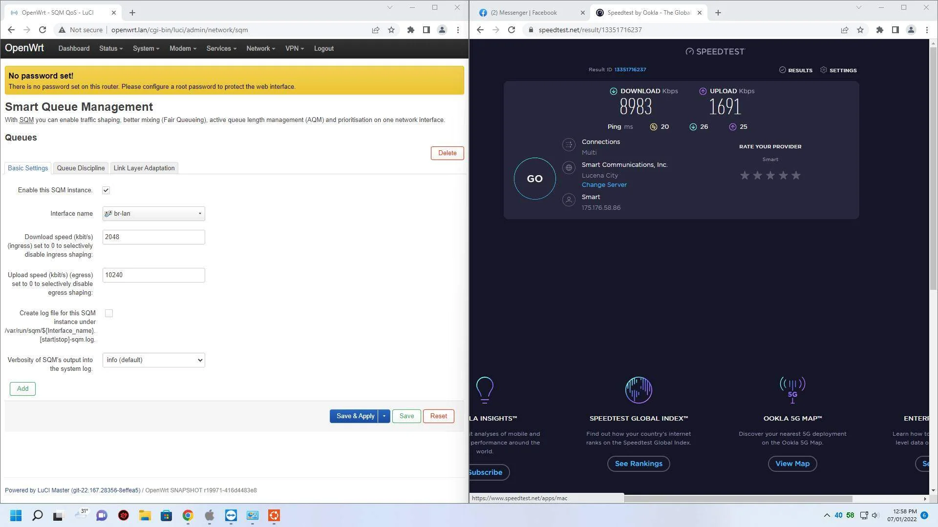

  • luci-app-sqm - Smart Queue Management for traffic shaping or speed limiting.
  • luci-app-ttyd - Builtin terminal in services menu. Also available in You do not have permission to view the full content of this post. Log in or register now.
  • luci-app-wireguard - Builtin WireGuard VPN Client with pre-config.
  • luci-app-firewall - Pre-config for usb1/lte, wanb/wan port, openvpn, wireguard and usb0/module.
  • luci-mod-dashboard - Custom info in dashboard.
  • luci-proto-ncm - Interface for lte module, usb1 or /dev/ttyACM0.
  • luci-proto-ppp - Interface for PPP and PPPoE.
  • luci-theme-bootstrap - Dashboard themes.
  • luci-app-nft-qos - QoS over Nftables.
Others: adblock, cgi-io, coreutils, coreutils-sort, curl, ip-tiny, ip6tables-zz-legacy, ipset, iptables-mod-conntrack-extra, iptables-mod-ipopt, iptables-zz-legacy, kmod-crypto-lib-chacha20, kmod-crypto-lib-chacha20poly1305, kmod-crypto-lib-curve25519, kmod-crypto-lib-poly1305, kmod-gre, kmod-ifb, kmod-ip6tables, kmod-ipt-conntrack, kmod-ipt-conntrack-extra, kmod-ipt-core, kmod-ipt-ipopt, kmod-ipt-ipset, kmod-ipt-raw, kmod-iptunnel, kmod-nf-ipt, kmod-nf-ipt6, kmod-sched-cake, kmod-sched-core, kmod-tun, kmod-udptunnel4, kmod-udptunnel6, kmod-wireguard, libcap, libcurl, libip4tc, libip6tc, libipset, libiptext, libiptext6, libiwinfo-lua, liblua, liblucihttp, liblucihttp-lua, liblzo, libnghttp2, libopenssl, librt, libubus-lua, libuci-lua, libuv, libwebsockets-full, libxtables, lua, luci, luci-base, luci-compat, luci-lib-base, luci-lib-ip, luci-lib-jsonc, luci-lib-nixio, luci-mod-admin-full, luci-mod-network, luci-mod-status, luci-mod-system, luci-proto-ipv6 and luci-proto-wireguard.
