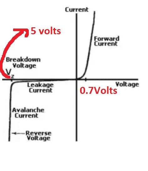

zener diode pag naka forward bias(connect positive supply to postive pin sa zener diode tas negative supply to negative pin of zener diode) para siyang normal diode which is need nya lang ng (0.7volts) to allow current flow.... while in reverse bias( connect positive supply to negative pin sa zener diode tas negative supply to positive pin of zener diode) may tinatawag kasi na zener voltage(rating siya ng zener diode) example is yung zener voltage is 5 volts if mag apply ka ng reverse bias @ 5-200 volts constant na 5 volts yung zener diode while pag forward bias 0.7 volts lang kailangan nya.. voltage regulator is nasa 5-12 volts
