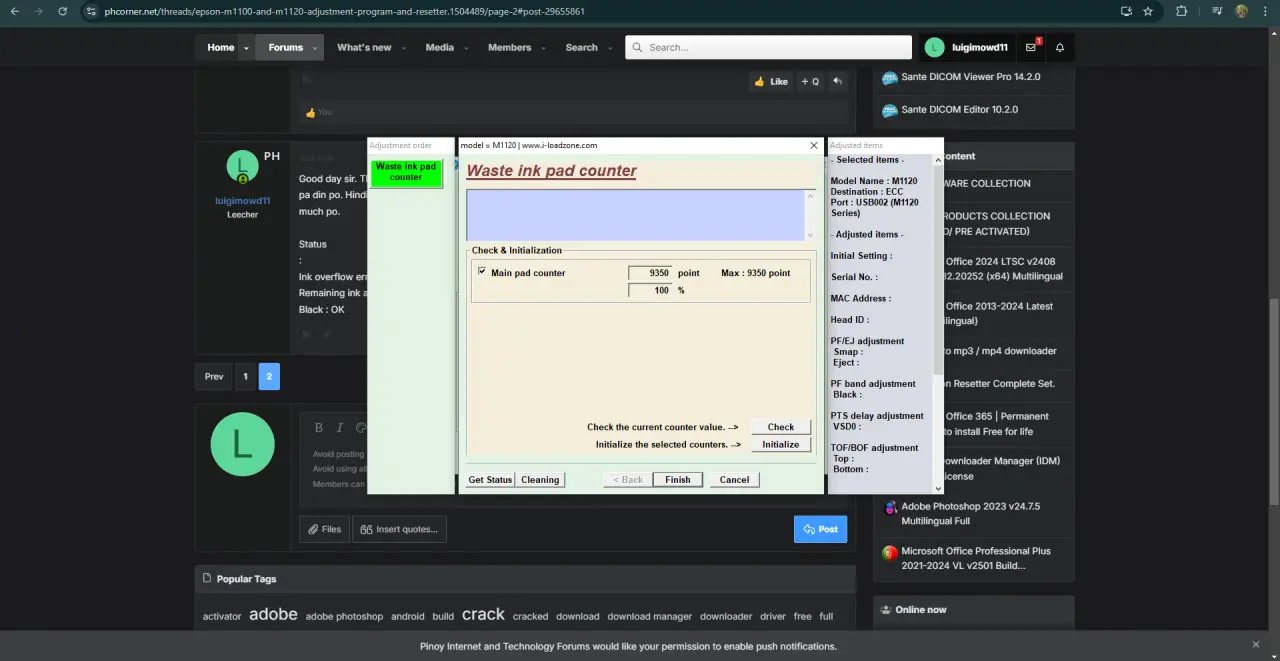

Sir / Maam. Pwede po pa help nag blink pa din po at hindi na reset yung waste ink pad counter :(. Salamat po.
run mo yung adjustment program nya tapos get status mo para malaman mo kung ano error ng printer. possible kasi na critical error or paper jam kung hindi waste pad counter yung problem.
Good day sir. Thank you so much for your response po. Upon checking po nung Main Pad Counter after initialize ay 100% pa din po. Hindi po sya na reset to 0. kahit na off and on na po yung printer after reset. Please send help po. Thank you so much po.
Ink overflow error.
Remaining ink amount >
Black : OK
try mo gawin ulit ma'am sir tapos run as admin mo yung adj program
Ink overflow error.
Black : OK
Ink overflow error.
Black : OK
pwede rin bago mo e reset hugasan mo muna yung waste ink pad niya. after mo patuyuin tsaka mo e reset. baka puno na yung waste
sir tried po i run as admin yung program. Hinugasan ko na din po waste ink pad and pinatuyo bago ibalik. Ganun pa din po 100% hindi po ma reset reset huhu. Send help. Thank you so very much po!
