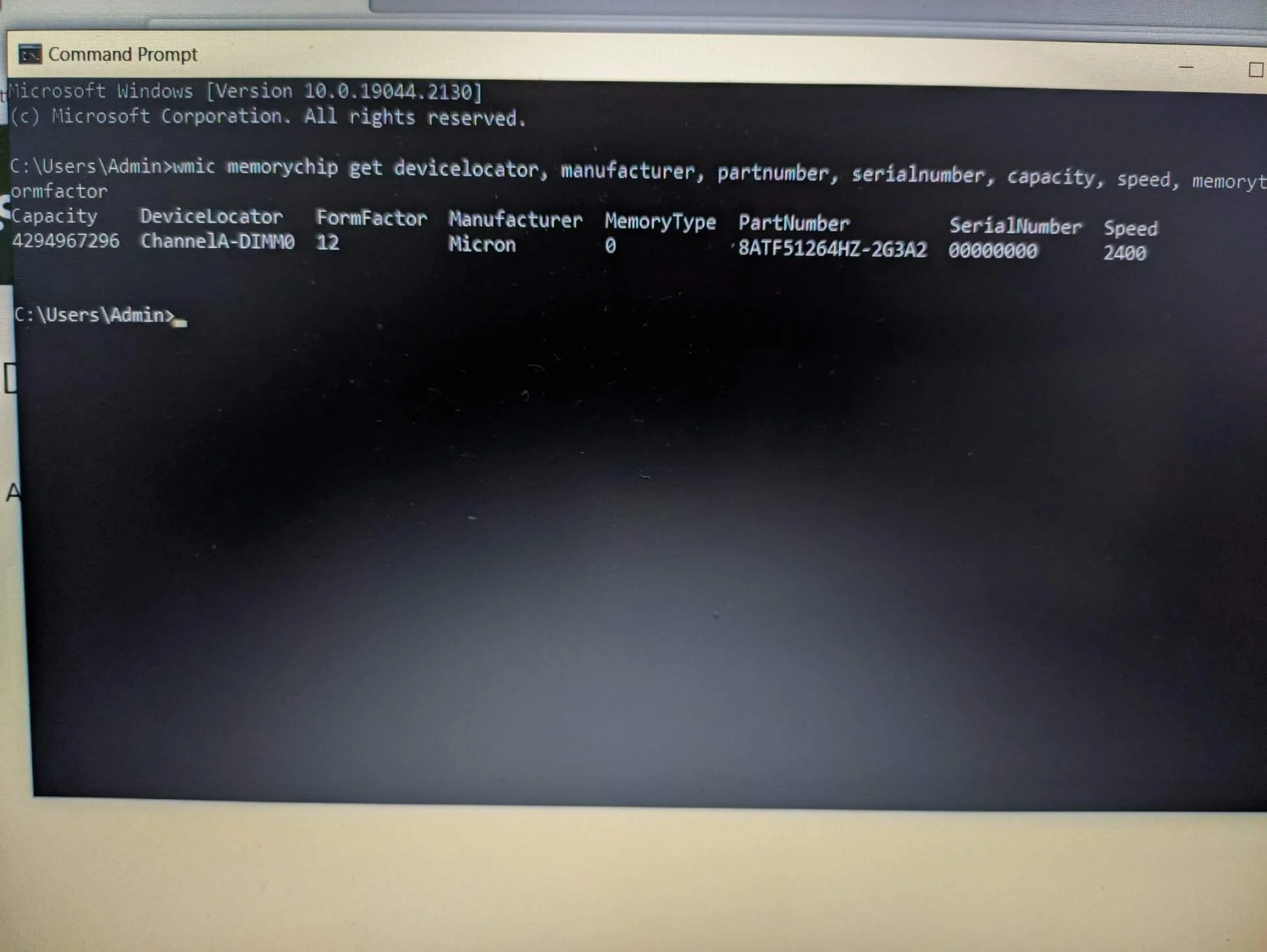

cmd ka muna tas search anong brand yung ram mo din hanap ka ng same brand with same frequency voltage and same latency ..wmic memorychip get devicelocator, manufacturer, partnumber, serialnumber, capacity, speed, memorytype, formfactor 1665716629920.png

cmd ka muna tas search anong brand yung ram mo din hanap ka ng same brand with same frequency voltage and same latency ..wmic memorychip get devicelocator, manufacturer, partnumber, serialnumber, capacity, speed, memorytype, formfactor View attachment 2237081

Based dito 2400 speed pero sa task manager 2133. Mukang mas okay na bilin mas mataas na Mhz.
