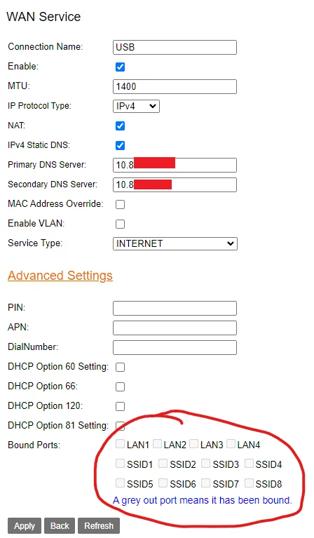

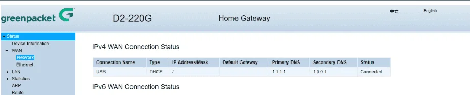

4 lang available na DNS server boss. Wla nman specific for smart pa share po settings. 😅IMG_20221211_154639.webp

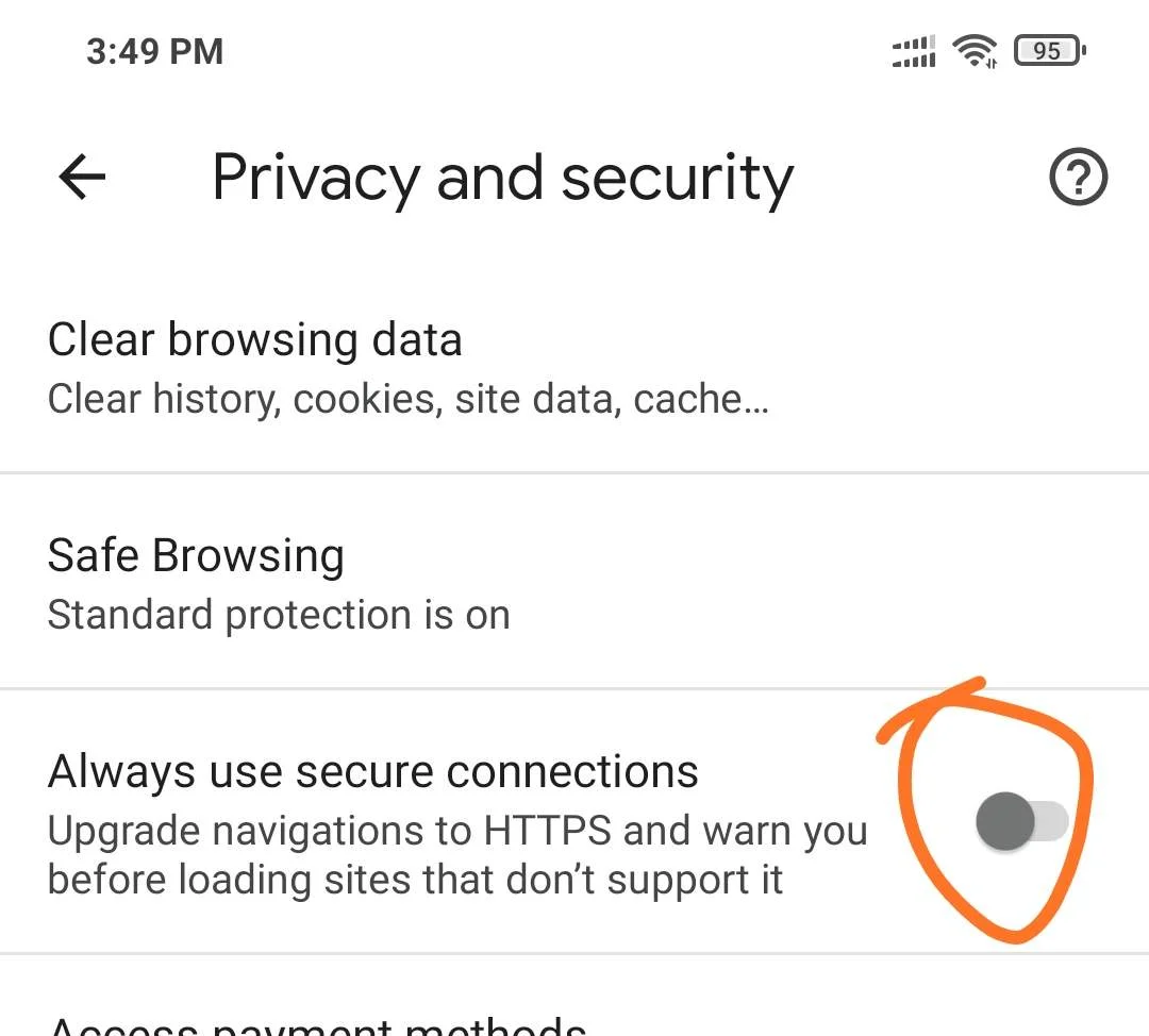

Try mo off ito boss, ska if may access ka sa gateway hanapin mo yung go to dashboard. Try mo din manual type sa private browser yung smartbrosettings...
Ako po yun nawawalan ng NET lagi lods, may pwede po makita setup mo sa DNS?

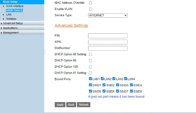

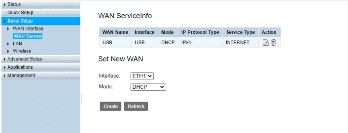

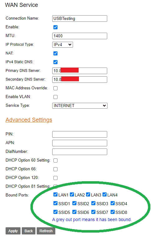

Nka openline ba modem lods? If openline punta ka sa 192.168.1.1:8080 or .0.1:8080 admin admin login or admin gp@turin

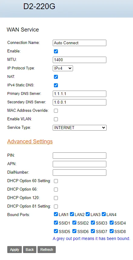

yung third pic check mo lahat yan...
tingnan mo dyan kung nagchange
Hindi ko malagyan check yung Bound Ports, lolds

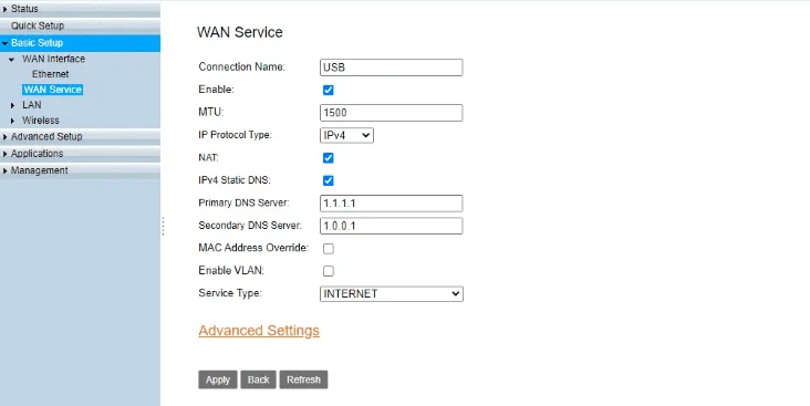

Update Boss Lodi, ginawan ko paraan inedit ko yung existing configuration tapos SAVE however sabi Connecting lang nawala na ako totally net. Tapos nag reboot ako modem nagkaroon ako ulit ng NEW "Wan Interface" so dalawa na sila connected at connecting :D hahaha
Eto Boss Lodi vant0y nagawa ko na LOL, salamat ng madami observe ko muna if di sya mag disconnect. Kapit lang tayo mga kapatid! hahahah
ok tol.. yan kasi ginawa ko sakin. bagong bili lang modem ko.
Nawalan parin ng net after 5 hours and 20 minutes, so ginawa ko pinalitan ko yung primary at secondary DNS to old config like 10.8*.. instead of 1.1.1.1 now under observation parin sya boss lodi, salamat ng madami.
