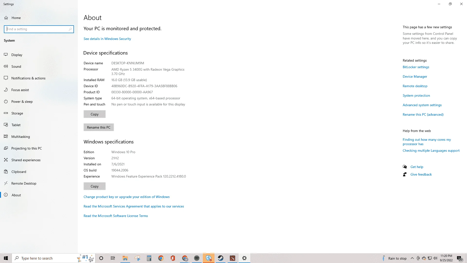

ayan paps specs ng pc ko.

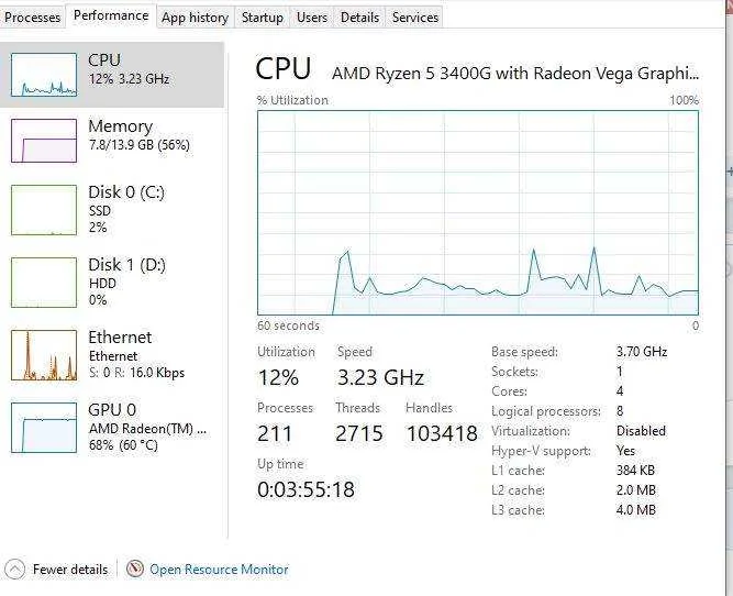

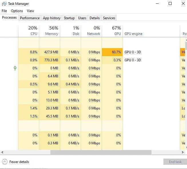

eto lods ang task manager ko, eto din specs ng pc ko.
Did you even check sa Task Manager palaging 100% utilization ng Hard Drive and higher miliseconds? If that's the case consider replacing your Hard Drive to a SSD or if supported you can go for a NVME for faster boot times.
Maassess mo kaya lods if need talga palitan ang hard drive based sa ss na binigay ko? if palitan po,mga how much po kaya ang estimated cost?

Lods base sa pic setup ng pc mo is disk 0 C: ssd(OS and games) din disk 1 D: hdd(documents files). ... Ito gawin mo... Gumawa ka ng Microsoft Word or any docs din save mo sa disk C: din test if mag hang parin ba sya
Possible is nilagay mo docs mo sa disk 1 D: hdd) din games mo disk 0 C: ssd) .... Kaya bottleneck yang Microsoft office sa hard drive mo..malakas kasi kumain ng harddisk speed yang microsoft office

Ang motherboard mo ba ay A320M Chipset?
Kasi if yes, consider replacing it with B450M motherboard, I know makes no sense why changing your motherboard to better one even na perfectly working ng mobo mo.
Watch this.
Hindi ko alam paano magcheck ng specs ng motherboard lods, pero based sa initial assessment ng friend ko IT, one way dw yun.
