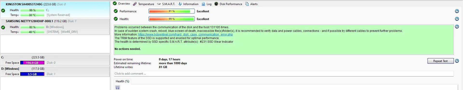

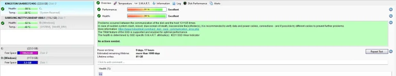

Guys patulong naman or may mga idea po kayu about SSD replacement, kase kakabili kolng etong Kingston 240gb sa shopee tas naginstall nang Win11LitePro GhostSpectre and installed some of my programs at kahapon kolng yan ginawa until now and this is the result.

mostly sa sata cable yung ganyang error so better make sure na maayos ang pagkakasalpak. reseat it if ever and try to change the cable kung sakali. Check this page for more info
Oonga eh lods baka nga
eto ung sata nang sinaksak ko eh baka nahugot masyado

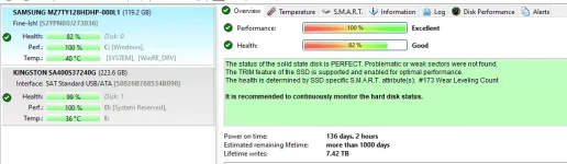

Update po
tinray ko sila iswitch ng Old SSD ko which is ung SAMSUNG (am currently using) & naka-external ung Kingston, biglang naging 100% ung perf ng Kingston kanina kase mga 90% na sya eh

Update po
yep try to reseat it nalang muna maayos. just do the basics like hipan mo yung connector (yung sinusuksukan) then qtip cotton buds alchol sa ribbon cable then patuyuin. kapag wala, replace na.
sa updated pic mo here mukhang reseat ang need dahil umayos naman performance both ng ssd mo.
