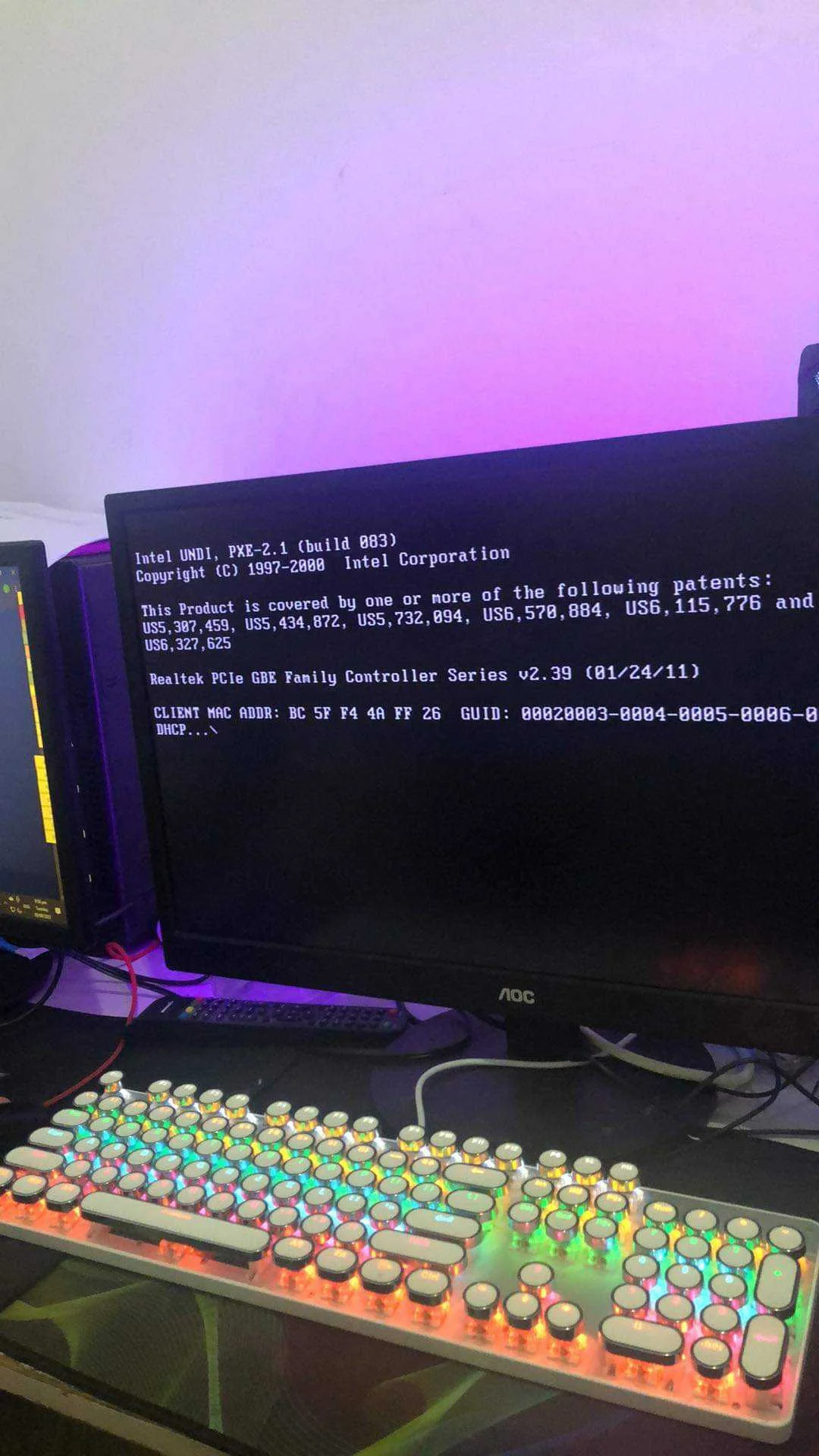

TS, hindi nadedetect yung hdd mo. maaring sa connection ng SATA cable o bad sectors.
Check mo yung connection niya, plug at re-plug mo yung SATA cable, hdd side at motherboard side. Try mo i-boot.
Kung ayaw pa rin mag-boot, gumawa ka ng bootable usb WinPE (meron dito sa PHC, search mo yung Sergei Strelec WinPE 10). kapag nakagawa ka na, yung USB WinPE ang i-boot mo, open mo si Cmd Prompt (Admin), type chkdsk C: /r at press enter, hintayin mong matapos. Try mo uli i-boot.
