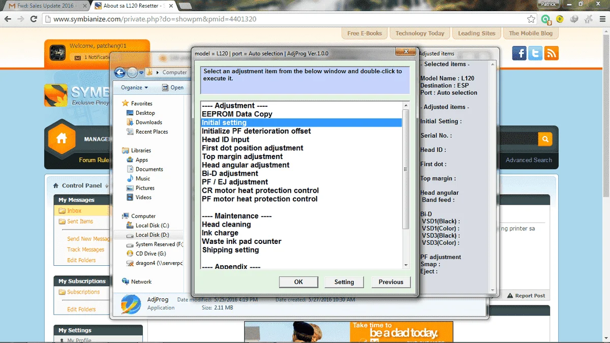

step 1: disassemble your printer, pati ung cartridge at makikita nyo may white sticker sa loob sa lagayan ng cartridge may nakasulat jan 10 digit character isulat nyo lang (mas ok kung sa sticker ng case nyo isusulat para d na kayo magbaklas sa susunod) then assemble it.
step 2: https://phcorner.org/attachments/epson-l120-adjustment-program-zip.55547/
download this and open.

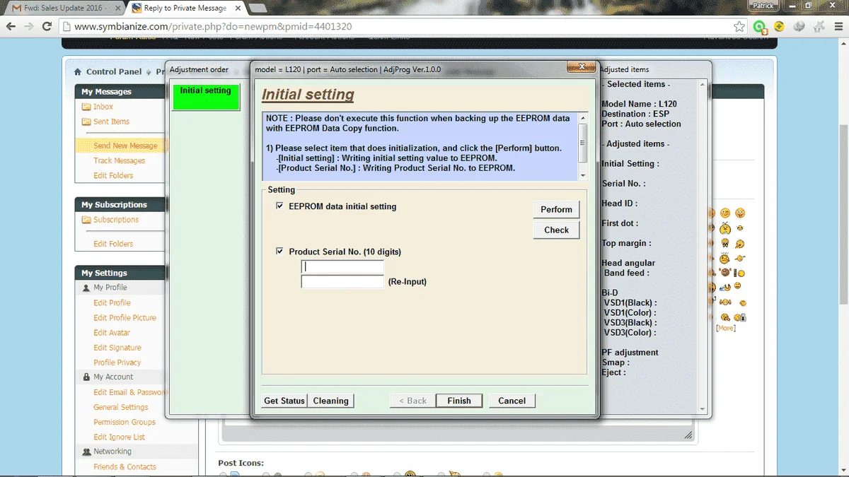

step 3: click particular adjustment mode, then click initial settings, then put your pruduct serial number(10 digit)
click check then click perform. then finish
step 4: click waste ink pad counter, click check, then pun check on the box and press initialize, turn off your printer then reboot..
