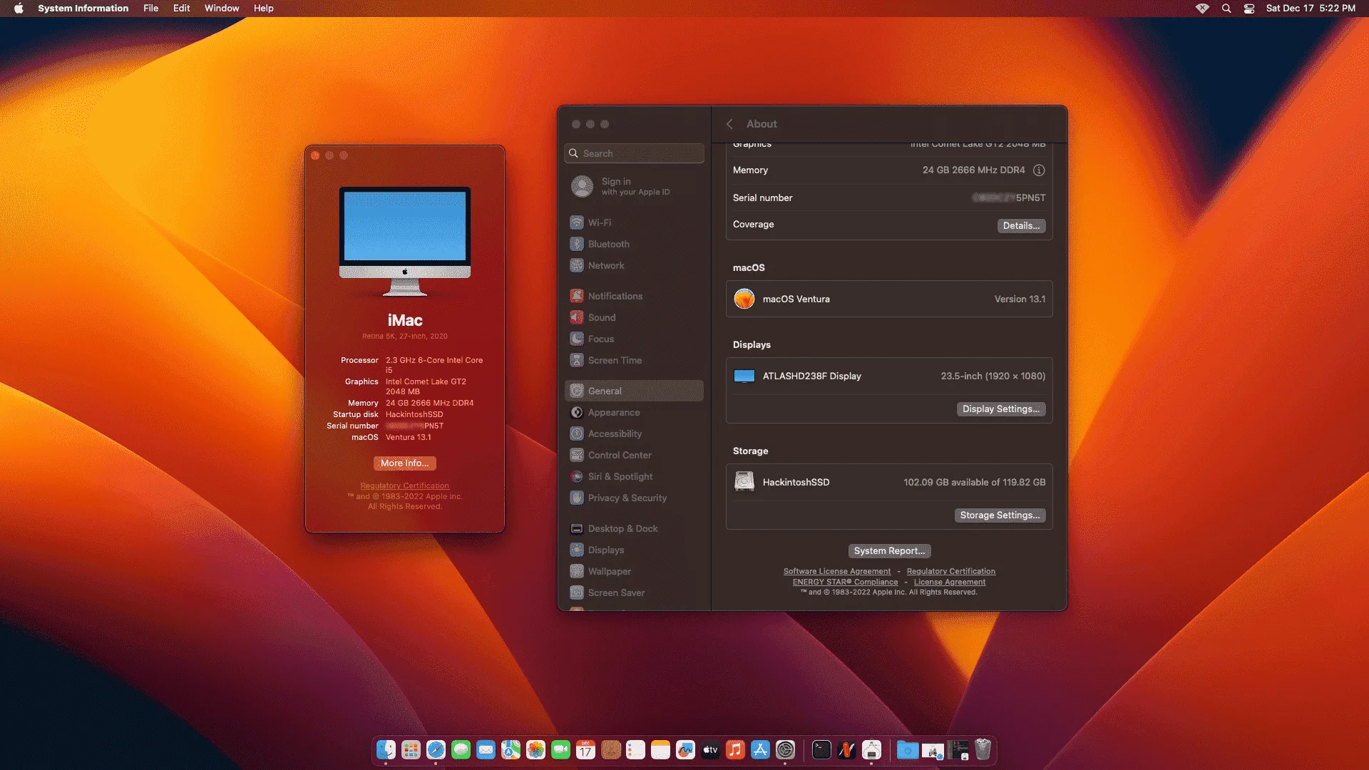

Medyo buggy sakin si ventura. From big sur - ventura medyo mas less stable ui niya. Pero ung core functionalities, ok naman. Mas rounded ung shapes. Best os pa rin sakin si Catalina.

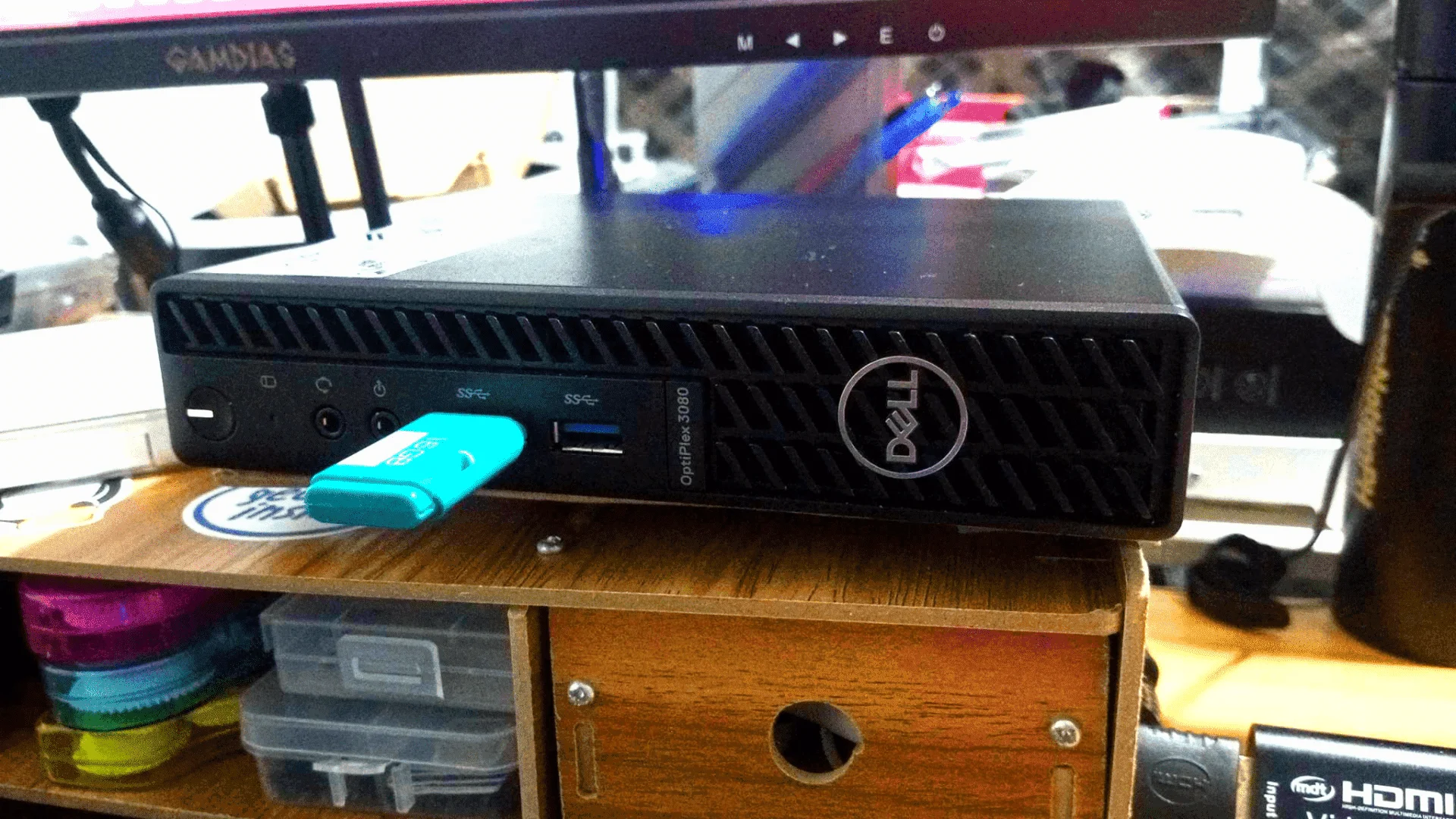

Dell Optiplex 3080 Micro
MacOS: Ventura
Bootloader: OC 0.8.8
Upgraded RAM 24GB
Pinalitan ko ng Intel Wifi 6 AX210 Card
Installer: Terminal Method restoring install media creation, re-used config from Monterey then updated the kexts, used USB 3 sa front port nya upon installation.
Triple Boot:
  • NVME - Windows 11
  • SSD - Ventura and ZorinOS
Working:
  • Sound
  • Display/HDMI Port
  • USB Ports
Untested:
  • Bluetooth (wala akong paggamitan, di pa nainstall ang kexts)
  • Sleep Wake
Nakapagscore ng around 8k for this unit sa FB Marketplace, cheap MacMini Version.

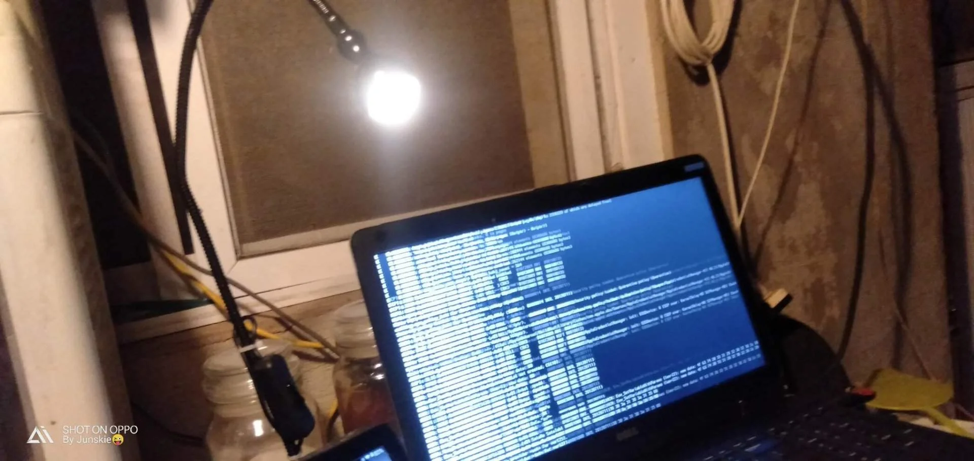

Paps, naka instal ka na? dyan ko din kinuha ung Big Sur ko eh, saka ung mga files nya.. nakapasok ako, kaso ng mag erase na ako sa Disk Utility, yung SSD ko hindi lumabas, ang nandun lang ay ung USB sandisk ko kung saan ung EFI files..
View attachment 2423663 View attachment 2423664 View attachment 2423665
Lalabas sya dapat dun sa Disk Utility yung SSD pag na-click mo yung "All Devices sa may bandang itaas na dropdown menu
