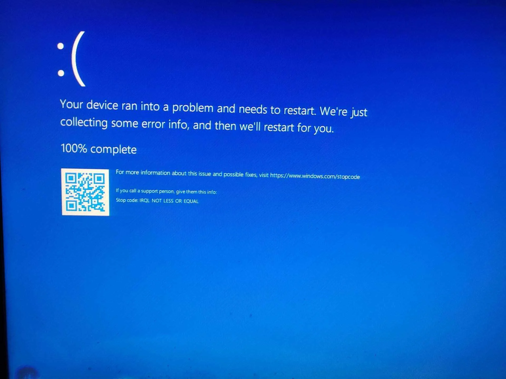

🔒 Closed Blue Screen Kapag Gumagamit ng Sofether
update mo mga driver the rig mo.
Pwede ka din gumamit ng whocrashed dump analyzer.
Done eto sya
System Information (local)
Computer name: DESKTOP-CL3ER62
Windows version: Windows 11, 10.0, version 2009, build: 22000 (x64)
Windows dir: C:\Windows
Hardware: MS-7817, MSI, H81M-E33 (MS-7817)
CPU: GenuineIntel Intel(R) Core(TM) i5-4690S CPU @ 3.20GHz 8664, level: 6
Processor count:4 logical processors, active mask: 15
RAM: 15814.0MB
Crash Dump Analysis
Crash dumps are enabled on your computer.
Crash dump directories:
C:\Windows
C:\Windows\Minidump
On Thu 21/07/2022 12:27:24 pm your computer crashed or a problem was reported
Crash dump file: C:\Windows\Minidump\072122-10406-01.dmp (Minidump)
Bugcheck code: 0xD1(0xA, 0x2, 0x0, 0xFFFFF8079C6C5F40)
Bugcheck name:You do not have permission to view the full content of this post. Log in or register now.
Bug check description:This indicates that a kernel-mode driver attempted to access pageable memory at a process IRQL that was too high.
Analysis:This is a typical software problem. Most likely this is caused by a bug in a driver.
Crash dump file: C:\Windows\MEMORY.DMP (Kernel memory dump)
On Tue 19/07/2022 12:41:12 pm your computer crashed or a problem was reported
Crash dump file: C:\Windows\Minidump\071922-12578-01.dmp (Minidump)
Bugcheck code: 0xD1(0xA, 0x2, 0x0, 0xFFFFF8004C115F40)
On Tue 19/07/2022 11:06:38 am your computer crashed or a problem was reported
Crash dump file: C:\Windows\Minidump\071922-36437-01.dmp (Minidump)
Bugcheck code: 0xD1(0xA, 0x2, 0x0, 0xFFFFF80699495F40)
On Sun 17/07/2022 12:02:00 am your computer crashed or a problem was reported
Crash dump file: C:\Windows\Minidump\071722-8890-01.dmp (Minidump)
Bugcheck code: 0xA(0x14, 0x2, 0x0, 0xFFFFF8013728F294)
Bug check description:This indicates that Microsoft Windows or a kernel-mode driver accessed paged memory at DISPATCH_LEVEL or above. This is a software bug.
On Sun 17/07/2022 1:16:53 pm your computer crashed or a problem was reported
Crash dump file: C:\Windows\Minidump\071722-15562-01.dmp (Minidump)
Bugcheck code: 0xA(0x14, 0x2, 0x0, 0xFFFFF80148A8F294)
On Thu 07/07/2022 11:26:11 pm your computer crashed or a problem was reported
Crash dump file: C:\Windows\LiveKernelReports\WATCHDOG-20220707-2326.dmp (Kernel memory dump)
Bugcheck code: 0x193(0x815, 0x3, 0xFFFF800E2149B080, 0x0)
Bug check description:A livedump triggered by dxgkrnl occurred. You may have problems with your graphics driver or hardware.
Analysis:This is a video related crash.

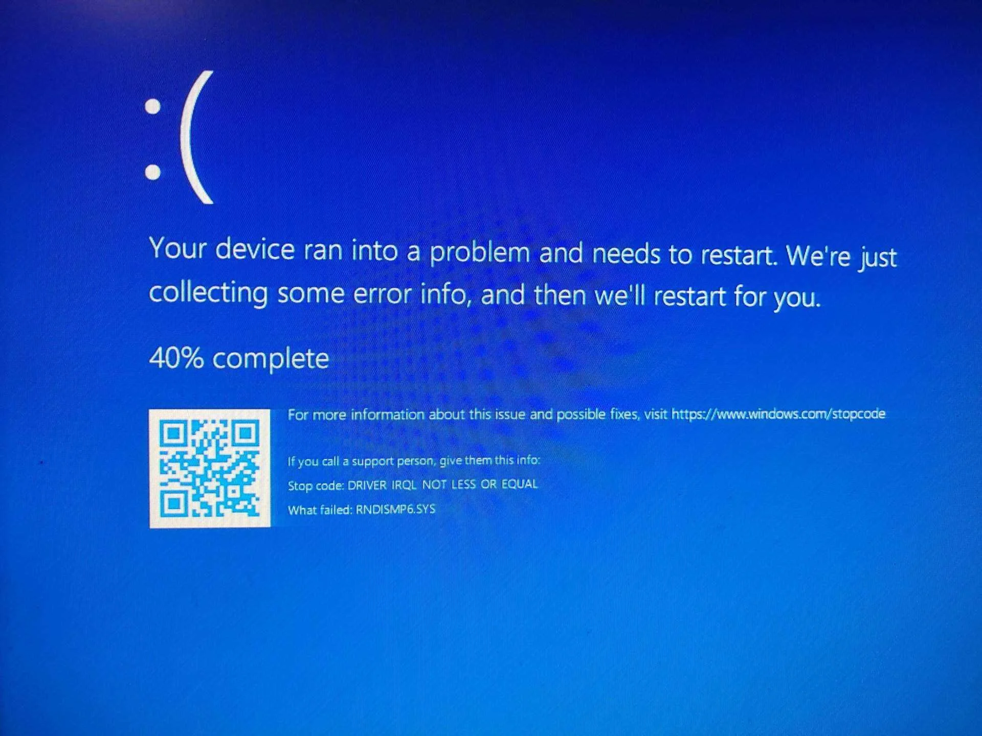

TS, naka-USB teethering ka para makapag-internet?
[Hidden content]
pocket wifi yung gamit na nakakonnect via usb
Blue screen of death na kagad boot?
nope
Ganyan din ba resulta kung disabled ang Softether at gamit pa rin yung pocket wifi? Subukan mo kayang gamitin yung Openvpn Gui instead na Softether, gagana rin naman diyan yung config mo.
