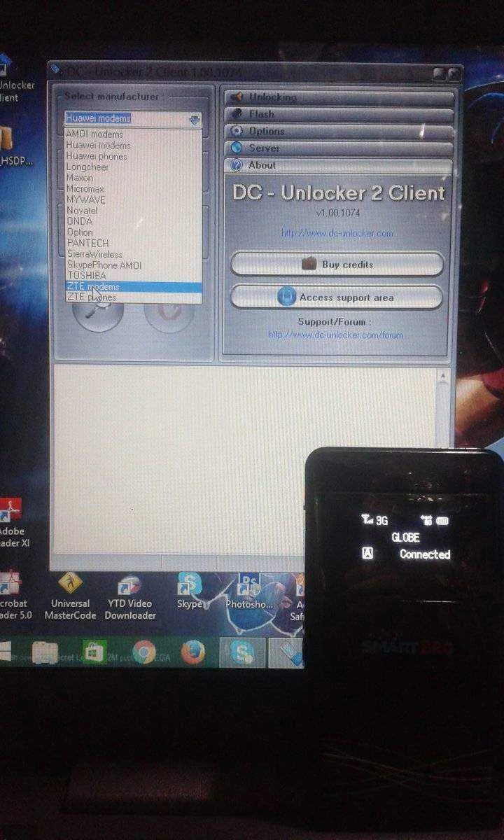

1. Download dc-unlocker_client-1.00.1045.exe then install it. [see attachment]
2. Download ZTE Unlocker [DCCrap] [see attachment], after download, extract and copy files to: C:\Programs Files\DC-Unlocker
3. Insert Globe / Sun sim to modem, open your modem (It will detect it as Sim Lock).
4. On your desktop, look for DC-Unlocker Client icon, Right click then Run as Administrator, DC-Unlocker will open.
5. Select manufacturer: ZTE Modems; Select model: Auto detect; Click Magnifying glass, wait for it to detect your modem

7. After detecting modem’s driver, you will see ZTE Diagnostics Interface (COM#) & ZTE NMEA Device (COM#). Be sure to write it down the COM#

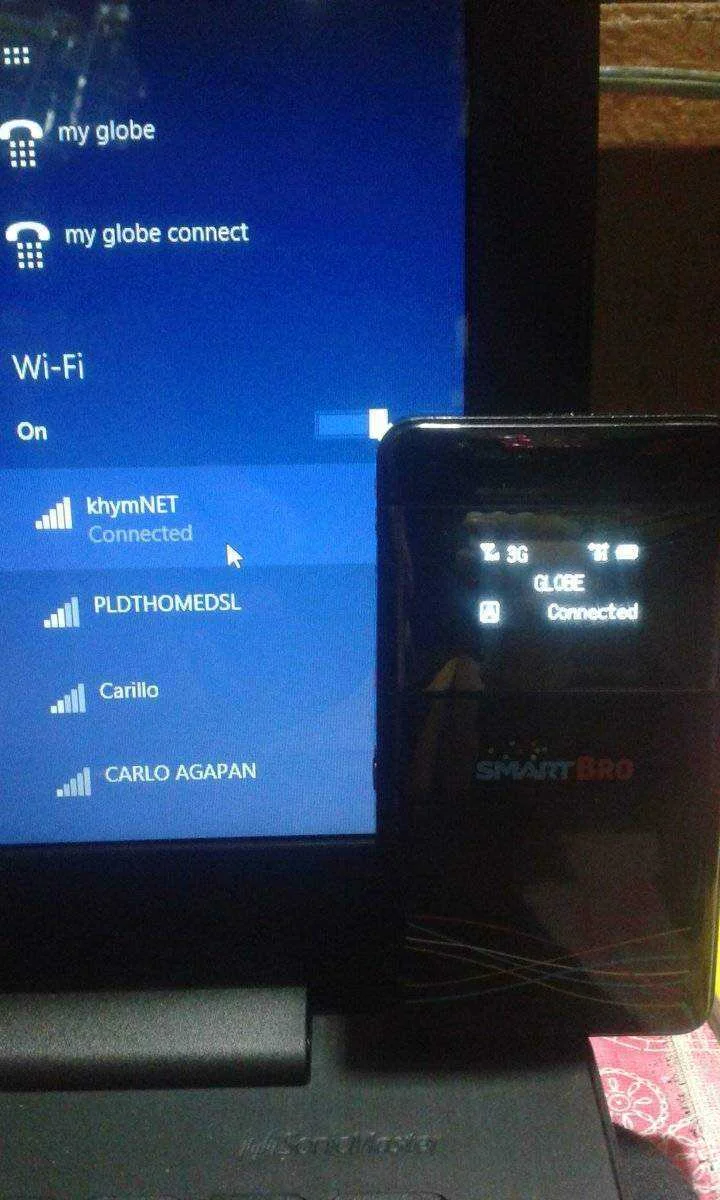

12. Your modem will restart and search for the Network signal for the sim you inserted (Globe / Sun).
13. Congrats … Openline ka na

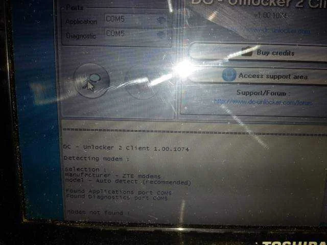

sir bakit modem not found...
nag download na ako ng driver ng mf65 sa website ng dc-unlocker ayaw pa dn ma detect sir... help naman.. salamat

Bos bakit wala akong makitang com port dun sa device manager tapos sa dc unlocker di daw detect yung pocket wifi ko
