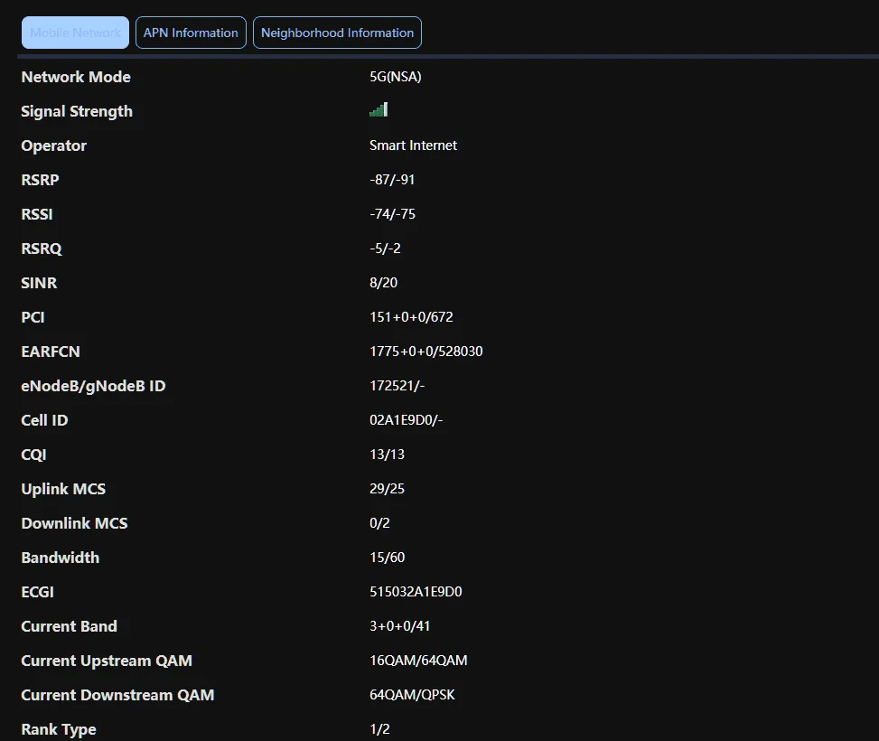

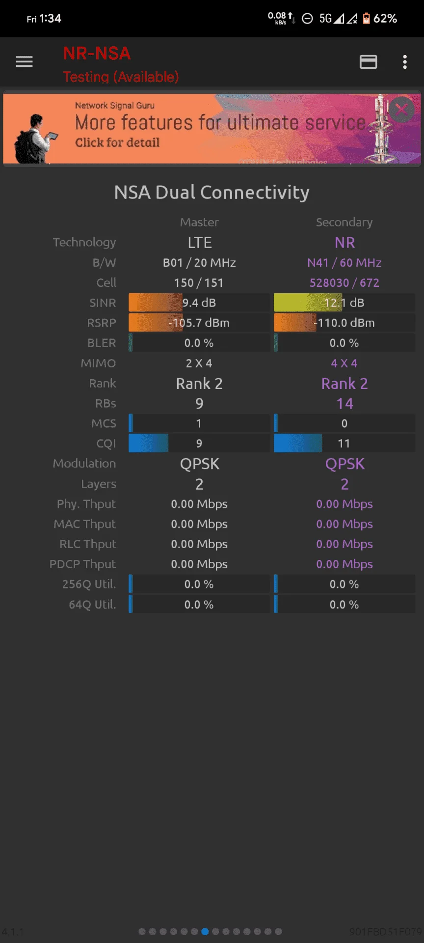

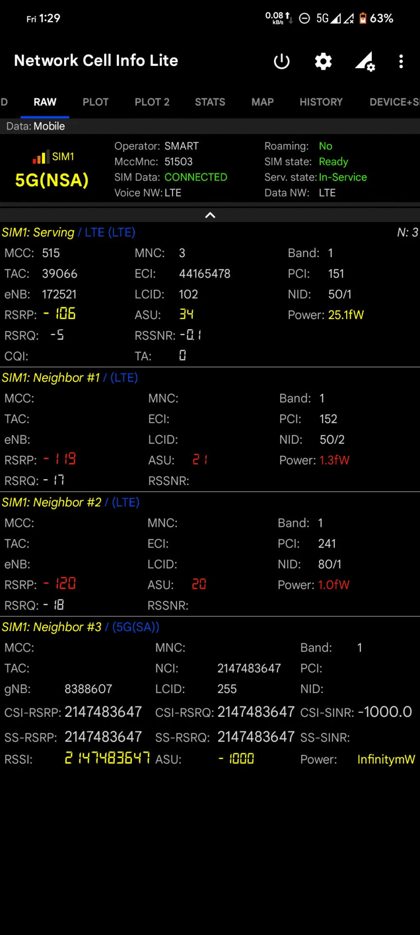

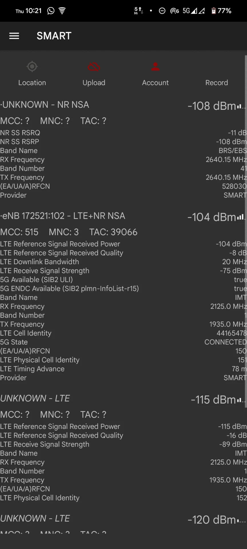

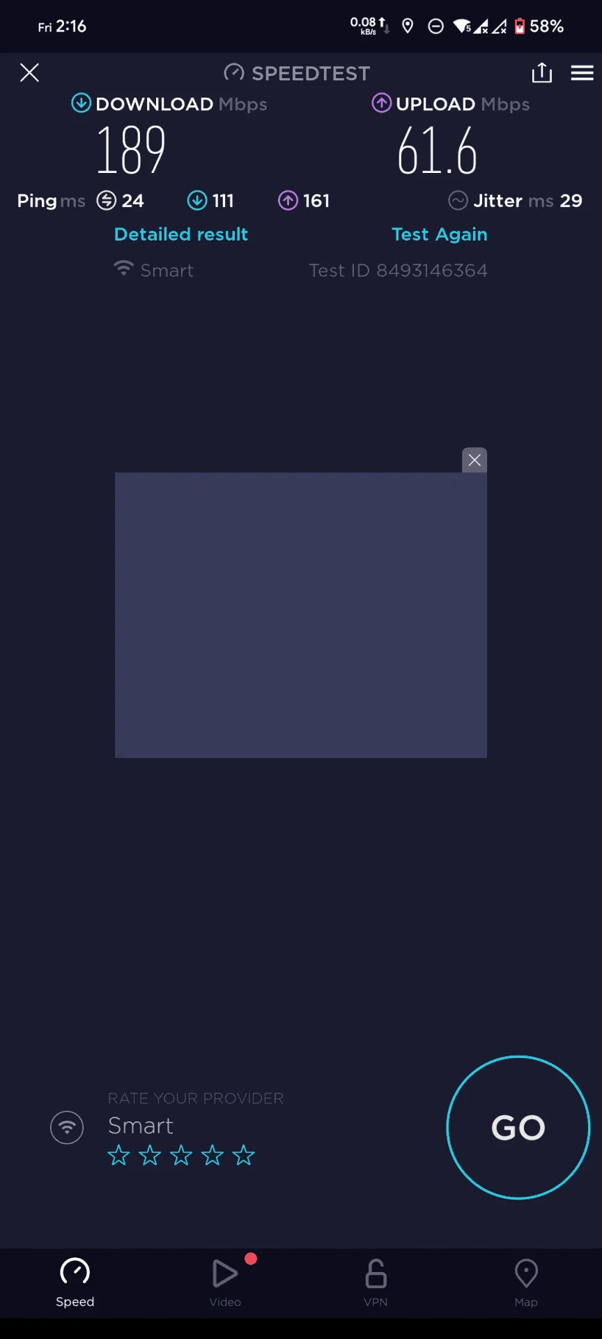

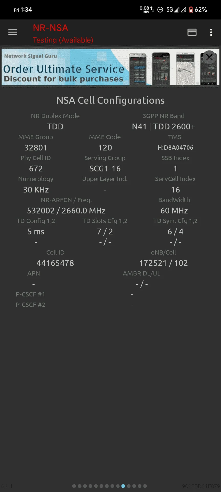

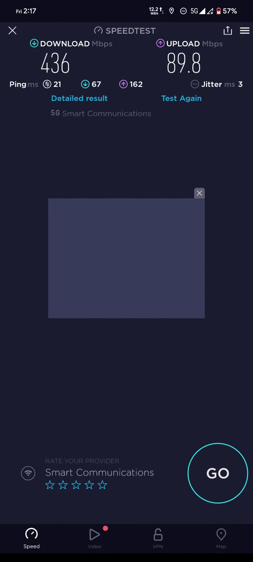

Hi,
First, sorry for the noob question. Dito po sa location namin iisa lang ang 5G tower, ang question ko lang po is bakit magkaiba sila ng ping/latency at speed compared sa phone ko. Pag sa phone ko po, umaabot siya ng 300-400mbps whereas pag sa VN007+ naman 80-200mbps max then yung latency is may 12-20ms difference (plus unstable VN007+ compared sa phone ko pag naghohotspot ako pag nagagaming).

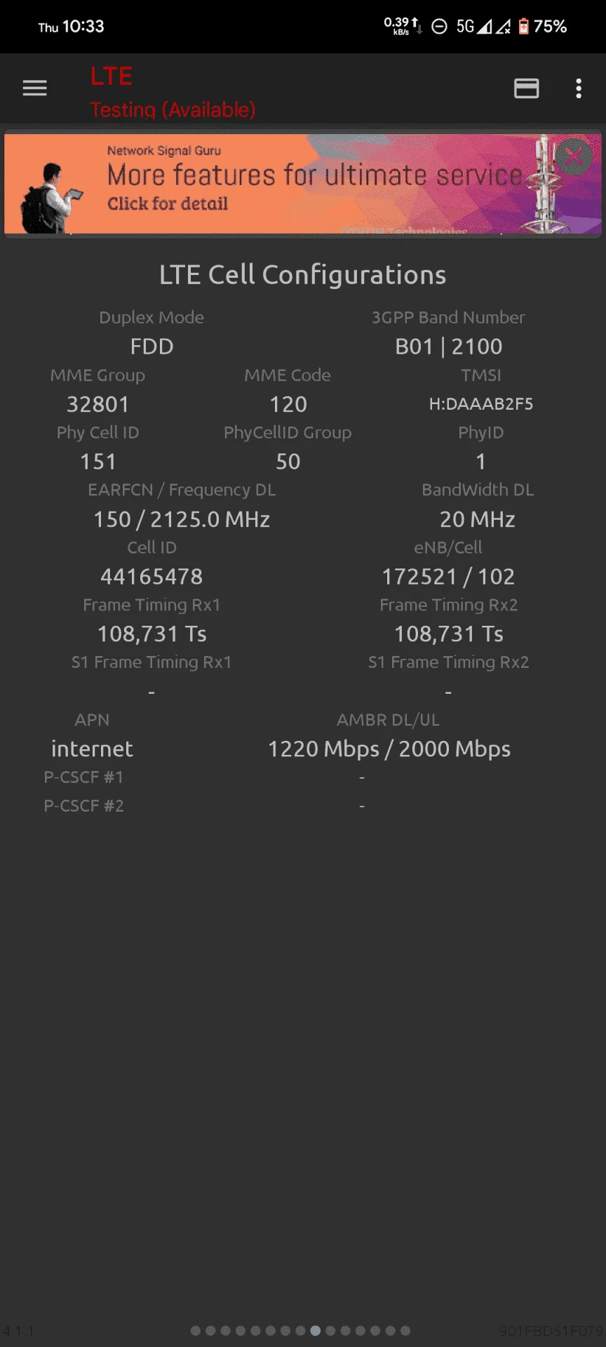

Triny ko rin cellid locking -- na nagmamatch sa phone ko, tweaking wifi settings i.e 2.4ghz, 5ghz band, bandwith etc. Pero di ko talga makuha yung performance using my phone. Ok naman yung receive signal mas mababa pa yung sa VN007+ but experience isn't the same.
Triny ko rin po yung band locking pero walang net (4g band 1, 5g band 1, 41 etc)
Upload ko nalang po yung mga screenshots ko for deets or raw data. Salamat po sa mga makakatulong or magsusuggest.
EDIT:
Hindi ko pa pala na try yung upgrade/downgrade ng software/firmware version. Currently: 1.12.5
Screenshot_20220630-222129_CellMapper.png Screenshot_20220630-223336_Network_Signal_Guru.png Screenshot_20220701-012953_Network_Cell_Info_Lite.png Screenshot_20220701-013434_Network_Signal_Guru.png Screenshot_20220701-013440_Network_Signal_Guru.png Screenshot_20220701-021617_Speedtest.png Screenshot_20220701-021706_Speedtest.png 2022-07-01_2-20-11.png
