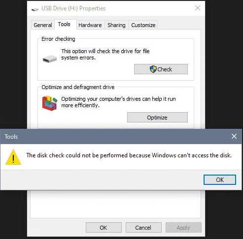

Paano po malalaman if recoverable or repairable ang HDD po?
Yun error po kasi ng HDD is "No Media" sa Disk Management
And another error is it cannot process with the "chkdsk".
HDD Specs:
3.5 Seagate Barracuda LP 2TB
Much appreciated for the answers or replies. Thanks!
Edit: I'm currently using a USB to Sata cable for the external HDD.
try mu muna palit sata cable at ilipat sa other sata port
check mo rin kung may clicking sound
I forgot to mention sir na I'm currently using a USB to Sata cable for the external HDD.
Pero I'll try your suggestion and plug it directly to my System Unit and check for any clicking sound.
Thanks sir.
TS, 3.5" drive iyan, kailangan niya ang 12V separate power supply, hindi pwede yung sa USB lang.
Noted sir. Nasa isip ko na din yun kung kailangan ko ng power adapter in order for the HDD to work properly. Baka nasanay ako siguro sa mga 2.5" drives. haha.
Will try your suggestion sir. Much appriciated. Thanks.
Dalawa ang terminal (sockets) niyan, para sa data cable at sa power supply cable.
Check mo yung mga internal power supply cables mo, baka mayroong extra plug para sa SATA drive, para hindi ka na maghanap ng external power supply. Yung Data cable niya pwedeng sa USB na lang kung walang libreng SATA socket sa motherboard mo.
