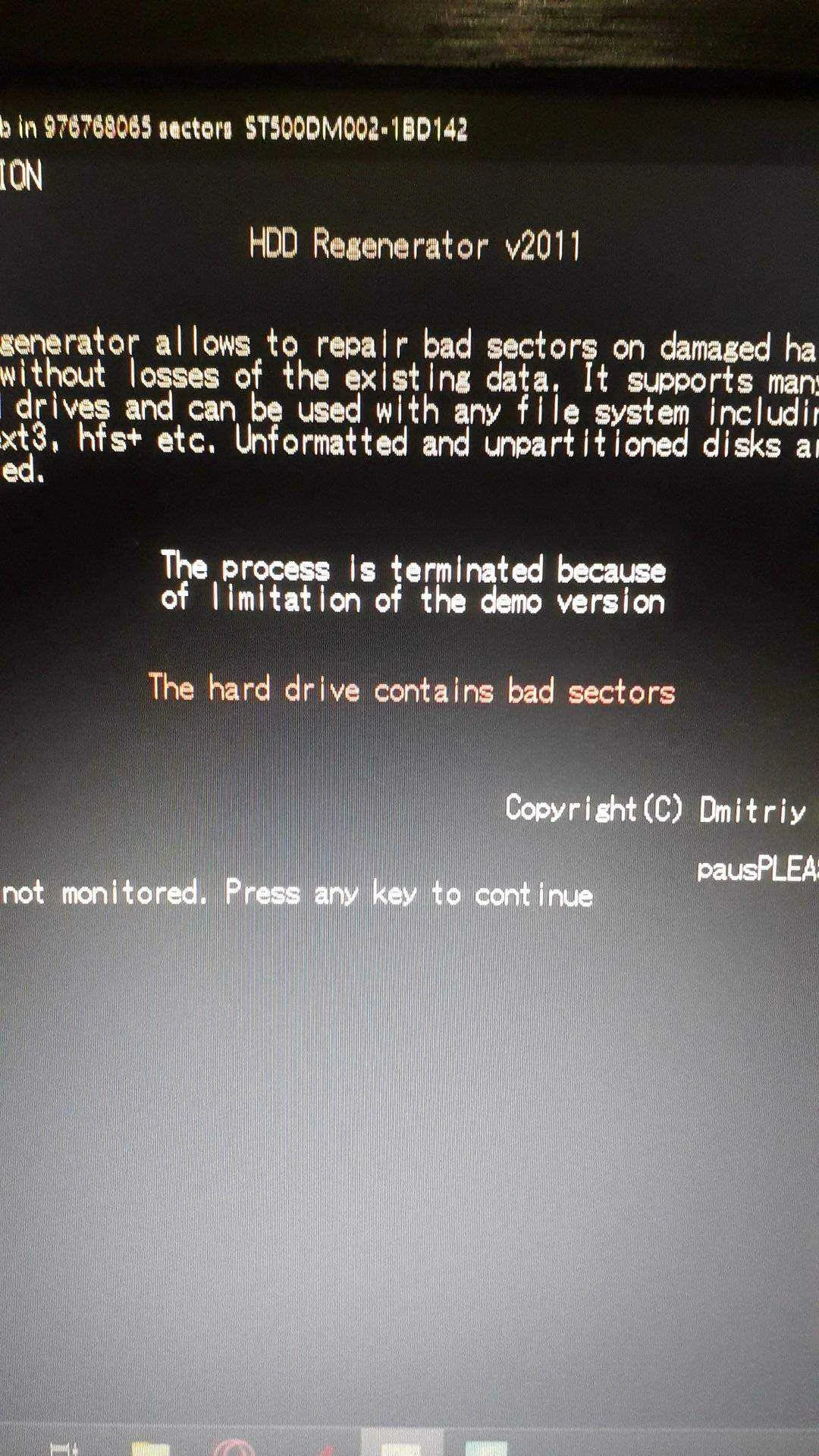

search & download mo yun hdd generator, try mo lang mag scan without repair para malaman kung harddisk ang salarin
Sige lods try ko
