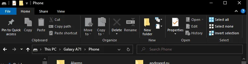

update: nadedetect ni laptop yung phone ko nakakabit pa naman.
